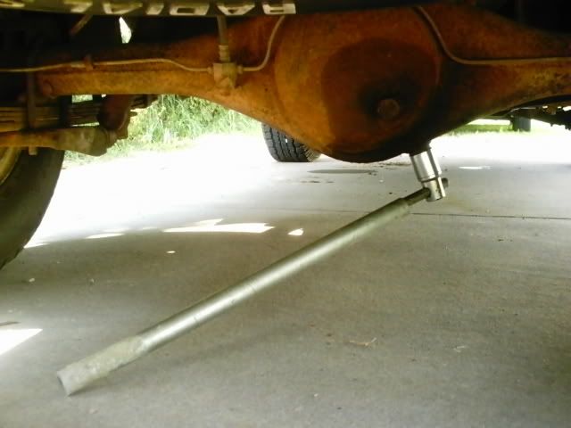

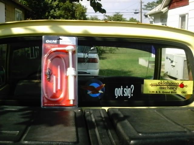

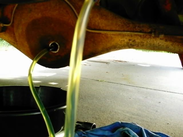

I got my diff fluid changed It took a hair less than the quart until it started running out the fill hole.
I'm trying to get off the transmission drain fill bolts now..No luck yet. Where is the fill on the transfer case.
If I fill at the shifter do I just take off the 2 12mm bolts that cover the shifter then pour in around the shifter ball, do I take the shifter out?
PostPosted: Tue Sep 08, 2009 1:58 pm
Posts: 302
I finally got the fill bolt off and the drain, it took 2 quarts until the oil started running out the fill hole. I had to take off the skid plate that protects my 4x4 drive shaft and then use a cheater bar since I could not find my 3/4 drive ratchet. I'm taking it out for a test drive...
