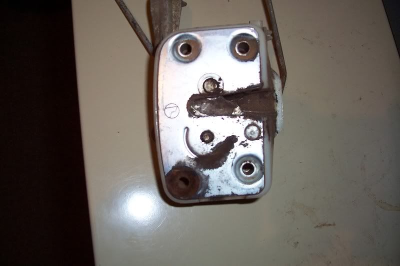

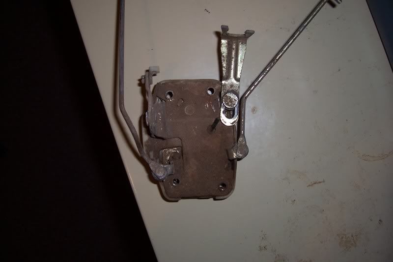

First gen Luvs were imported in to Australia badged as Chevy luvs up till i think 78, after 78 till 1980 they were badged as KB ISUZU's (not rodeo) Then from 81 the 2nd gen's were badged in Aus as Holden Rodeo's.
Heres some pics of first gen Luv latches

Thanks,
The photo is exactly what I needed. These are the ones!
