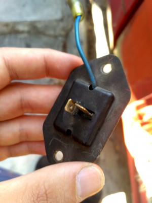

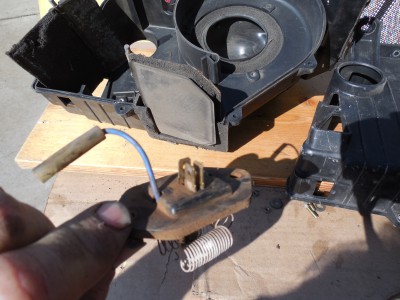

Hope that is that.Tomorrow i will fill the radiator coolant and start the engine to try it.
About the resistor i saw some pics here of one with 3 pins and a cable.
Mine has 2 pins and the blue cable.Does that blue cable goes to the blower?
The switch from the controller has a single blue cable also.Where does that goes?

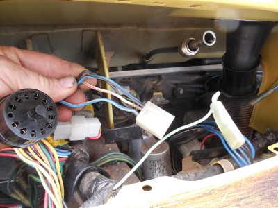

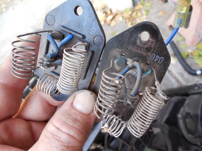

Well I'm glad someone is seeing & getting use of my pictures :lol: ... Actually didn't think you could pull pictures from this site but i guess you can.
download/file.php?id=7777&mode=view... know how to test these ?
I personally would hold off on the coolant till you know its working right.
The blue wire on the resistor plugs into the motor and next to the plug is black one it plugs into another black one in the wire loom right there under the ash tray
You say yours has 2 terminals ? What year is yours and doe it have ? .... The 3 units i seen (75,77, 80 all non AC) all had 3 terminals
I'm pulling mine back out heater not warm and engine getting warmer in 15 mile drive ...so swapping back to the one i pulled out just w/o all that debris on it & thinking i'll try the resistor from my 80 as the heater works in it.

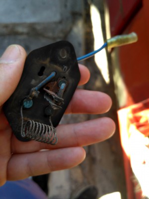

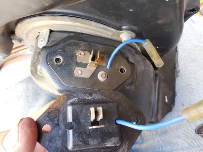

1st picture shows why so much mud is on the heater core, it was a rescue truck. I pull everything but the core when i got this one going & the heater core ran cool when for the 9yrs driving so no problem picked up a core not too long ago so it was time to check it all out
other 2 pics are 1980 & 77 resistors..i don't see a difference in em...the blue wire was plugged into the blower next to a black one below ash tray (i see 2 black wires there long n short short is plugged into the lever controls long black wire plugs into the blower as well male / female plugs all match up
I'm pretty sure the blower fan worked low/med/high w/ engine off
I pulled it all out again today as the truck was getting hot figured i swap back to the dirty core (Yes cleaned up) as it wasn't getting hot.
& i pulled the 80 resistor to check out in my 77 see if that helps...put it all back in & while filling it with water it died ... SMH :esurprised its got gas n spark put it all away for fresh eyes 2morrow

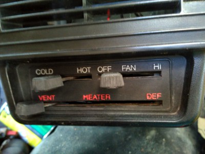

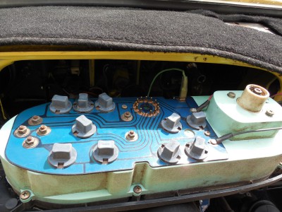

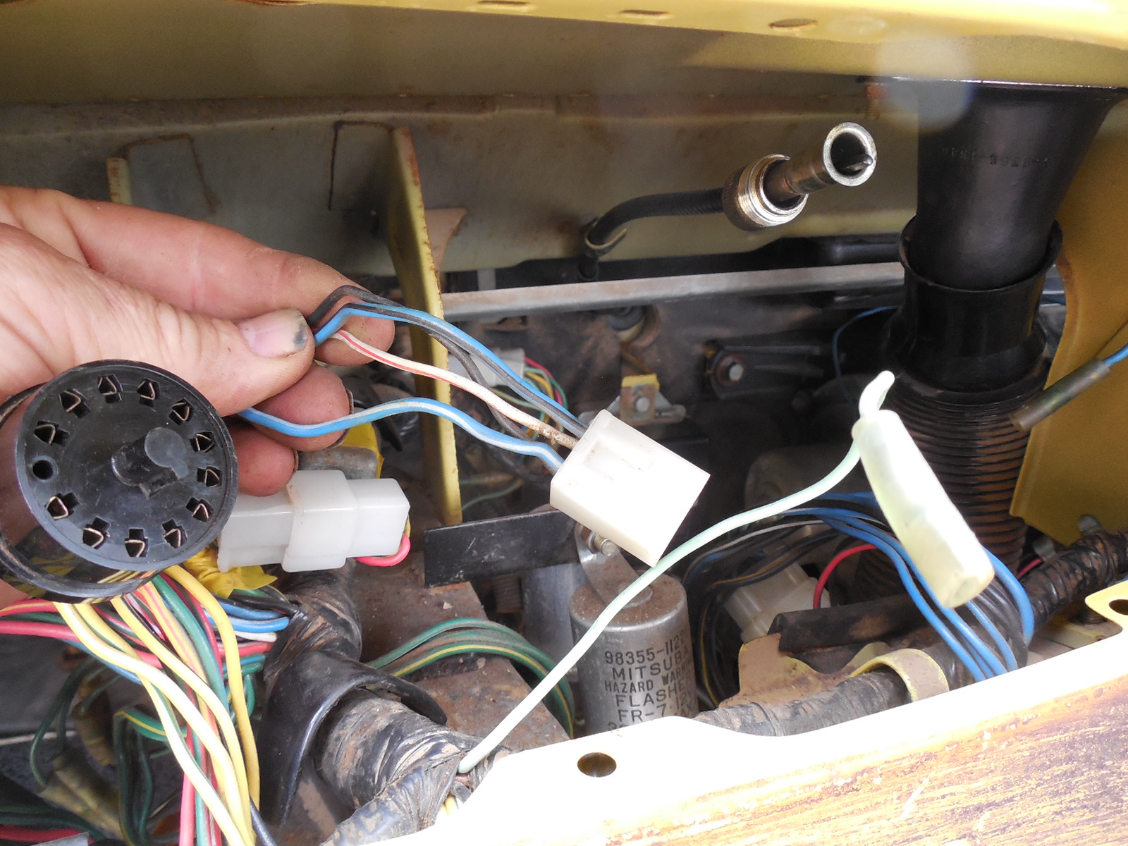

Back with updates.Finally there is a brown wire under the ash tray that powers the blue wire int he switch and from there you control the blower.
The blower works with the engine off.
My controller has 2 speeeds and maybe thats why my resistor is with 2 terminals.
So that problem is solved :)

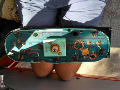

Next thing is the gauges,i ve noticed 2 terminals in the back(check the photo).But there is only one wire that plugs in the one behind the fuel gauge and i think that is for the temperature. :? Anybody knows what is the other for?
The brake light on the dash what is it for?Is it for the e-brake?Is there a switch somewhere?I remeber mine working but now is dead.(checked the bulb and it is ok)

our controls are different and mines always on. ...No off.. (unless maybe i cut the low speed wire )

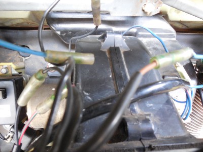

here's another view of wires
blue wire on left is not hoked up on mine ...Not sure what it's for
gauges are little different too i have 1 terminal light grn wire

so I pulled out the gauges & found this wire plug and nothing around to plug into it... :?:

So your blower is always working at low speed? 8O Can t understand why the designed it that way.
The blue wire on mine is also on the air.
At the back of the dash i got 2 wires that don t plug anywhere as at the back of the glove box there is a 4 cable conector on the air.
Maybe someone with the newer gauges can help me.

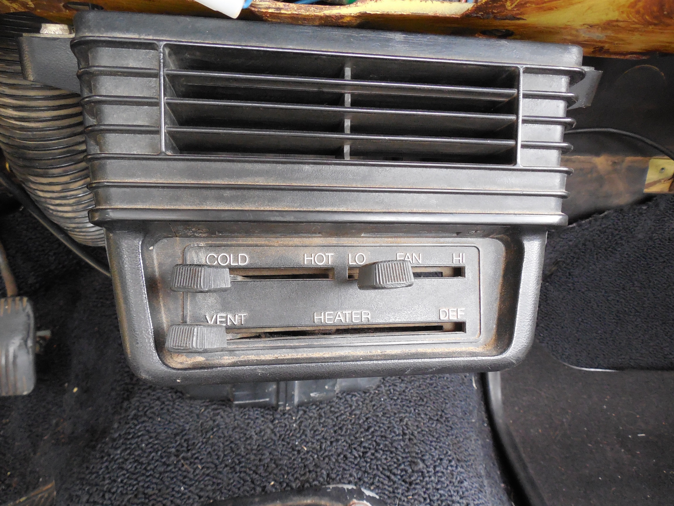

In researching my blower always being on hi and switching back and forth doesn’t control from lo to hi does nothing, I can’t find any other threads with pictures that help me. I do have a manual but that doesn’t help me either.
Any pictures of the exact wires that are connected from the blower to where they go? I can only see two wires coming from the blower motor, blue and black.
I have the blue and black wires are hooked up to other “like” blue and black wires from under the dash. I also see the brown wire under the ash tray you speak of and it does the same thing as the other blue wire I hooked it up to.
If someone could sell me a lo/med/hi lo switch, I’d appreciate it.
Any help would be appreciated.
