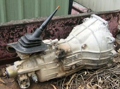

Image The remote gearstick unbolts and the stock luv stick bolts in, no need to cut the floor.
