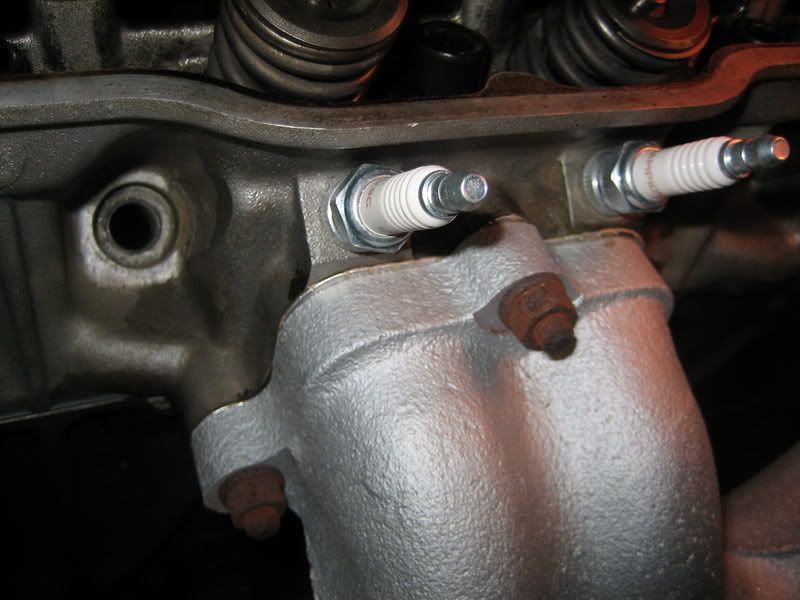

threads are 14mmx1.25 same as a spark plug. I have searched High an low and never found a off the shelf plug yet.
Here is my latest attempt

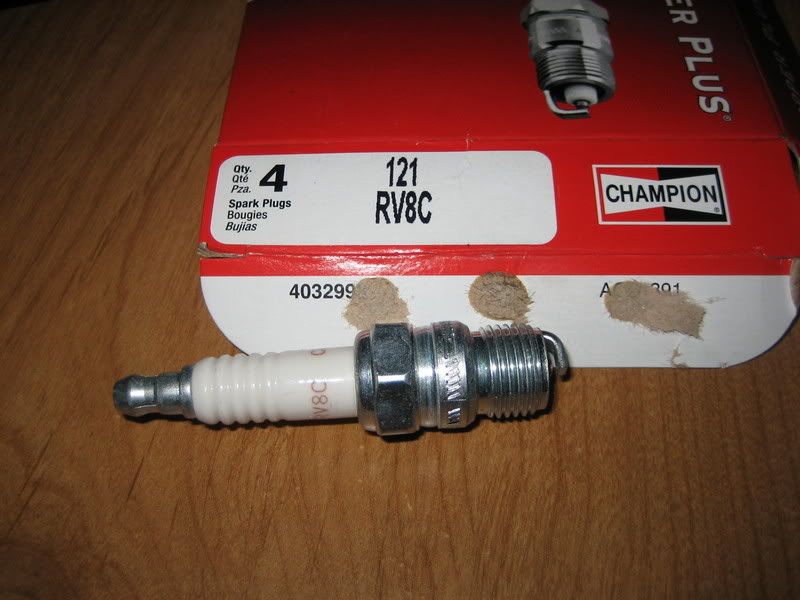

Tapered seat spark plug 5/8" Hex with .406"reach Champion Part# RV8C
I can't wait to tell the tell someone how 8 spark plugs give me more HP

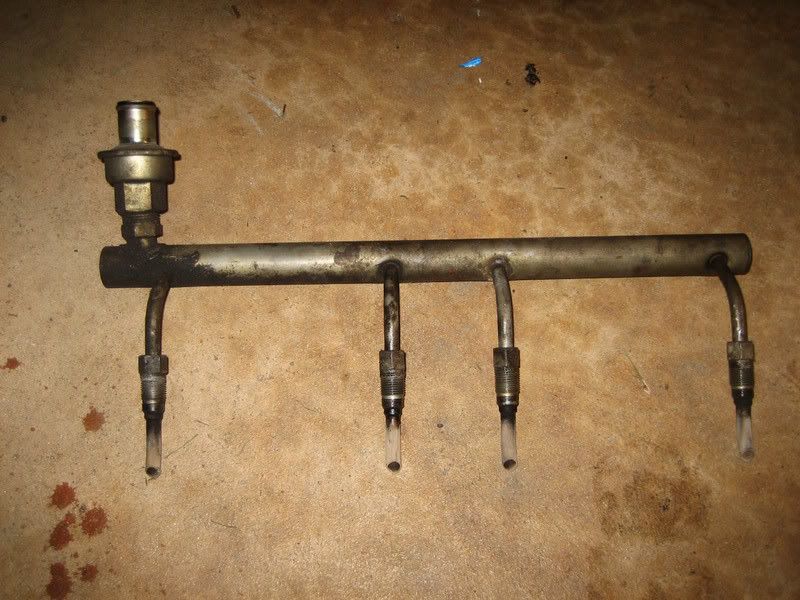

A simple and very effective way is to take the original nozzle fittings that went in them off of the air injection rail by cutting the tubes that go into them.
Then get out your trusty tap & die set and thread their centers so you can plug them with some black grade 8 allen bolts and small thin brass or copper washers. Once you tighten them all back down into the head, it actually looks decent and kinda like they belong there.
Some people have welded the nozzle fittings shut, drilled out the centers of old spark plugs and welded them shut, or cut off the tubes and crimped the ends, or welded shut the big fitting on the end of the air injector rail that leads to the pump - none of which IMHO is as easy or as professional looking as just threading the nozzle fitting centers and screwing in allen bolts with a soft small washer to seal them.
You can easily pick up everything you'll need at the nearest hardware store pretty darn cheap and have it done in no time.

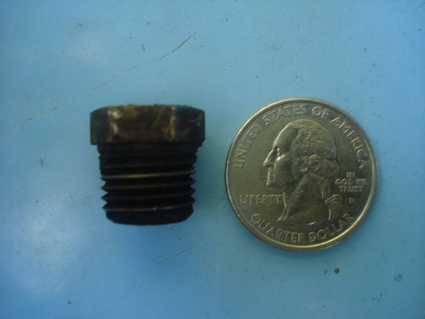

i like the plug idea good for a few :lol: but this is what i use
i think i got them at the local hardware store, they are made of brass, and im pretty sure they are cheaper than spark plugs

the holes are and off size, proprietary to Isuzu... they are if I remember right 12.5 mm or something like that ... other things will fit but can come loose or strip the threads unless you take the head off and retap the holes... I did like taz said used the existing pipe fittings, taped the center with a 3/8 pipe thread and insert either allen bolt or pipe plugs they look the best and like he said almost like they belong there

Hey Cat, can you please post a close-up pic or 2 of the allen screw plug-job for everyone?
PostPosted: Sat Oct 27, 2007 10:35 pm
mine have the pipe plugs but ill get a pic tomorrow

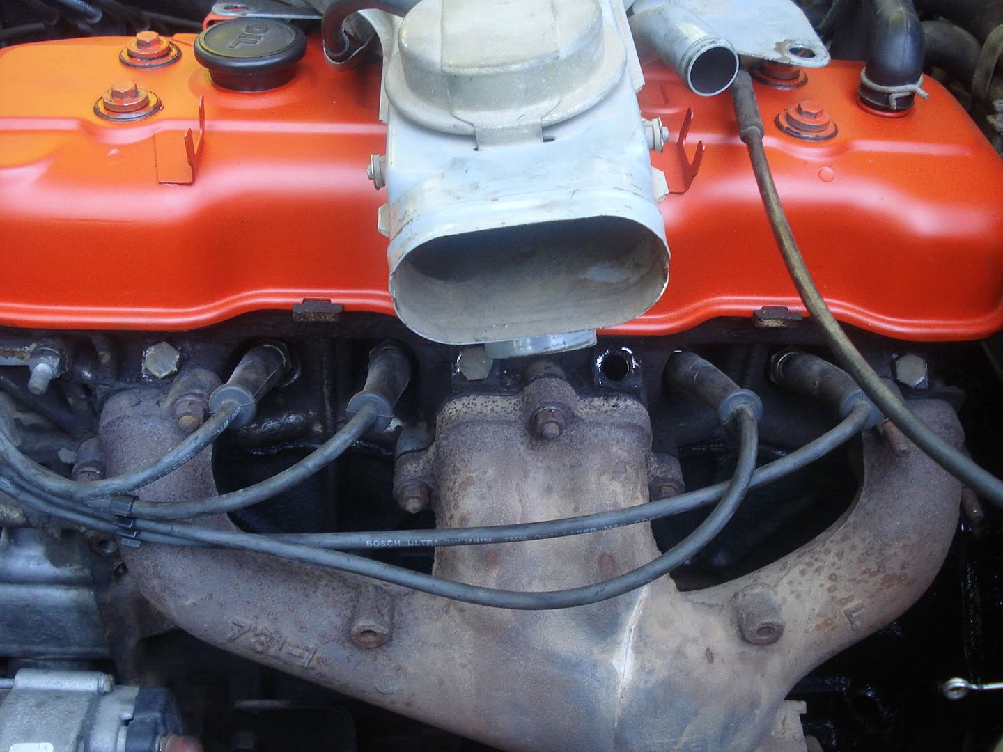

PostPosted: Sun Oct 28, 2007 2:00 pm
here you go
