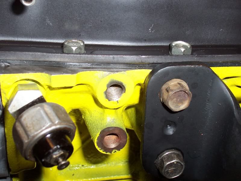

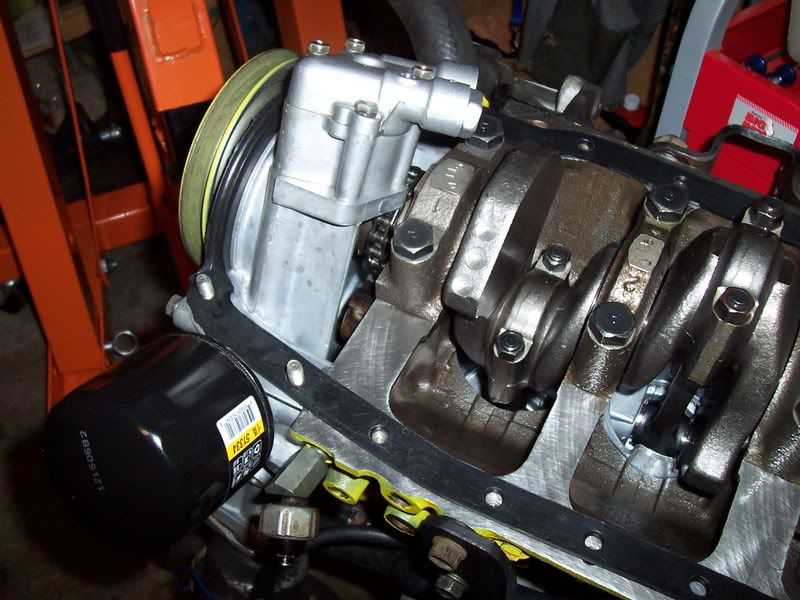

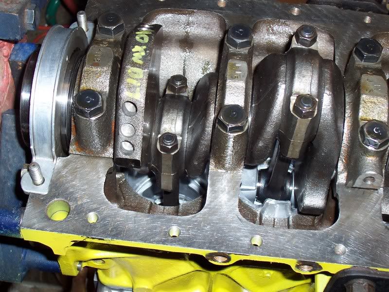

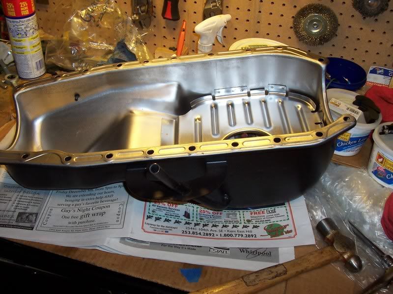

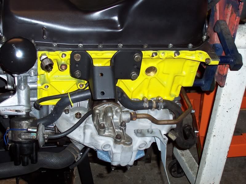

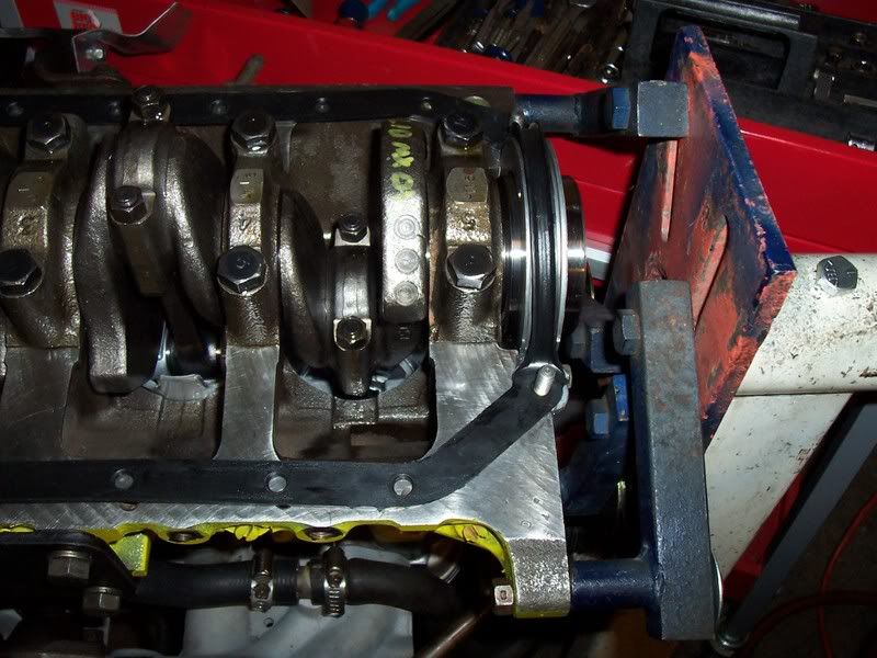

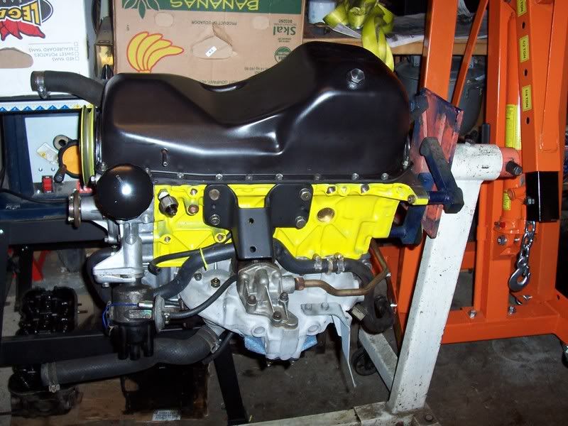

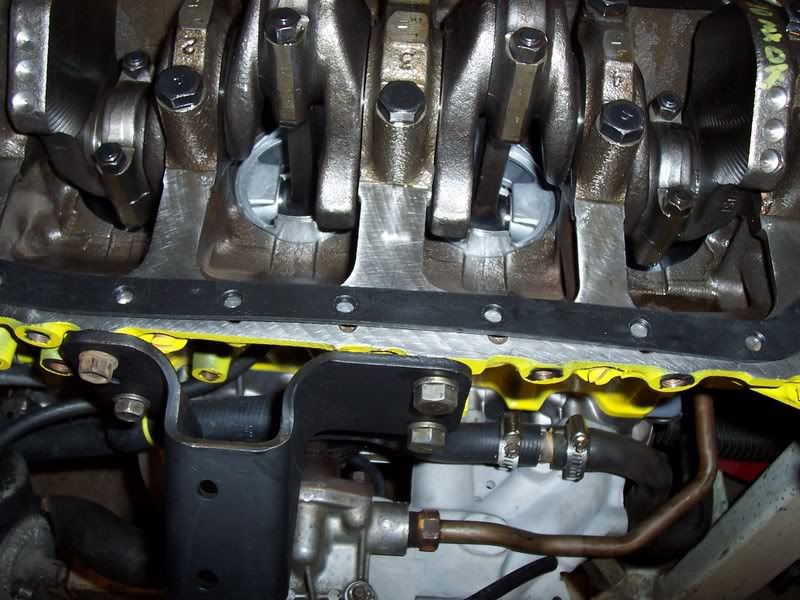

Replacing the oil pan under the vehicle is not fun. You will also need to remove both of the braces on the rear of the block, one of which has the clutch cable going through it. I don't have an automatic, so I can't say what it looks like. Be sure you don't over-tighten the bolts on the pan and make the new gasket get damaged. My oil pan gasket said not to use any chemicals, but I had to use Permatex® to make it stay in place. I put it on the block first.
When I had the engine in the shop on a stand, it was a lot better. Especially since I forgot to include the oil pickup tube, and immediately had to do it over!!!
PS- That wasn't a dumb question; the manual describes it.
Here's a few views...
Image Image
The front; remember to apply sealant at the points where the steel block meets the aluminum brackets/The rear
Image Image
The oil pan/Herein lies the problem; see how the gasket doesn't line up perfectly with the holes?
Image Image
That's why I had to use Permatex®, because the rubber gasket wouldn't stay where I wanted it
Image Image
Much easier upside down on an engine stand!!!/Notice the even line of the gasket
Image Image
No protrusions, or bulging

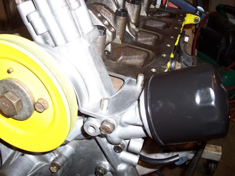

Also, for some odd reason, most G180's have studs sticking through in the bottom of the timing cover where it bolts to the oil pan. If you double nut them and lock the two nuts together, you can remove them to make it a lot easier to get the pan on and off. You can put them back in when you re-install the pan or just replace them with bolts like I did.
That way, if you ever have to replace your timing cover gasket, it makes the whole process a lot easier, since those pesky studs sticking through the oil pan make it darn near impossible to get the timing cover off with the oil pan still bolted on.
