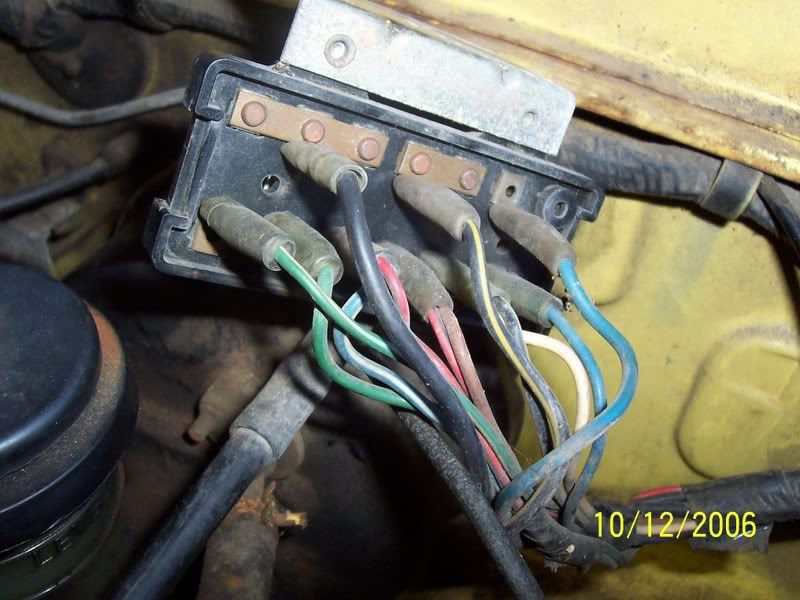

well i think i'm missing one but i don't know that much about the electrical part on these trucks
http://img481.imageshack.us/img481/1926 ... ockyn4.jpg
Thats what i have and my step-dad says thats it
BUT shouldn't there be somthing more??
I think it would of been on drivers side above the fender well

While I must admit it looks a bit naked, it has the correct number of fuses for a truck with only 2 headlights.
Mine is mounted on the drivers side and under a piece of clear (although scratched) plastic.

so theres no other fuses for like the radio and stuff??

Radio probably had/has inline fuse.
but yeah, that's your fuse box, or what's left of it.

The radio uses one of those fuses. If you haven't yet purchased a shop manual for your truck I'd highly recommend it. They can be found on e-bay regularly for less than $10.
And in the mean time, reference the wiring diagrams that Ben has posted in the Information section.

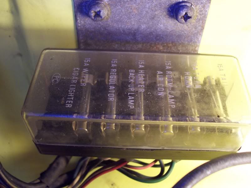

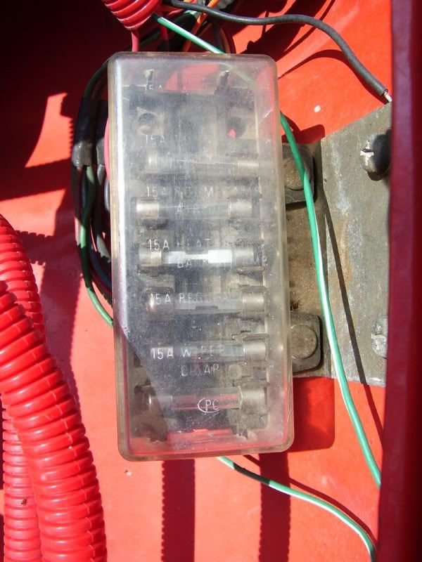

Here's a couple of photos.
Image Image
'78 1.8L 4-speed Fleetside
Image Image

here ya go

hmm so maybe someone just moved mine
thanks guys
