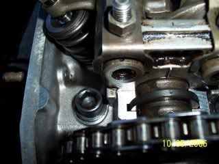

Be sure when the rotor points to #1 or #4 that the corresponding cylinder is at TDC by removing the plugs and having a friend rotate the crank by hand while you hold your finger over the plug hole. If the air pressure is pushing on your finger, you have the right stroke. The camshaft has a mark, and the #1 rocker arm shaft bracket has a mark. These must be lined up. I took a photo of mine when I did this a couple weeks ago....

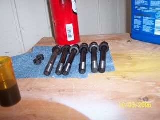

Be very sure to follow the proper tightening sequence as shown on page 48, Fig. 1.53., from the center-out when tightening the head bolts. Be sure the threads are clean by running a tap in and out the holes, and wire-brushing the bolts. I used brake cleaner to clean the bolts, and compressed air to blow out the holes. I lubed the bolt threads with ARP® assembly lubricant to minimize drag, and accurately measure torque.

That picture is worth 100 posts. That is the mark I have been talking about. The dot on the positioning disc/washer on the camshaft and the line on the rocker shaft holder right behind it.
You don't need to use the finger in the plug hole trick if you use the timing mark on the crank pulley. When it is lined up with the 0 degree mark on the timing cover, #1 and #4 are at TDC. Then just look at the cam to tell which cylinder is at firing position, whichever has both valves closed.
