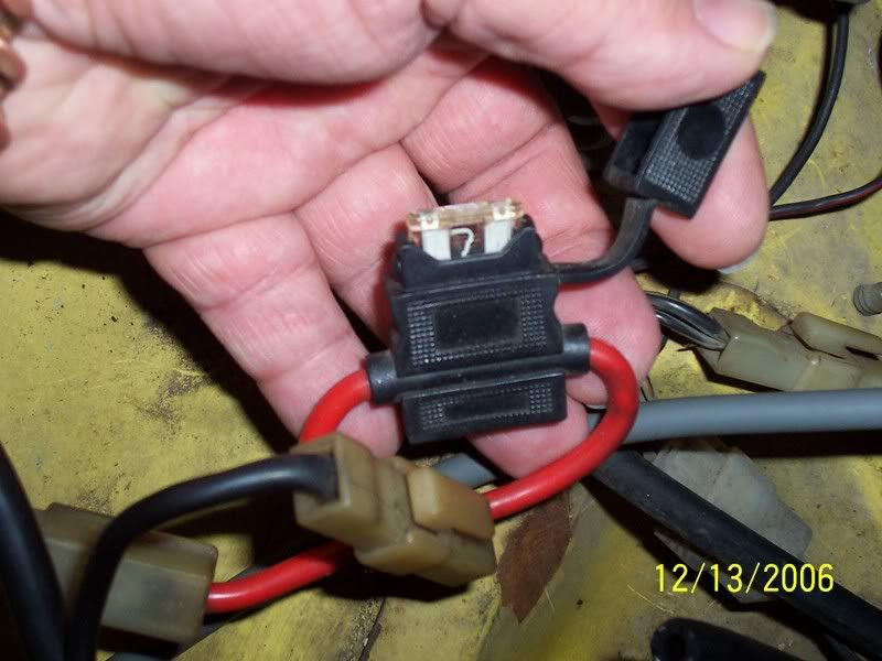

Here's a closeup of my 25-amp fusible link

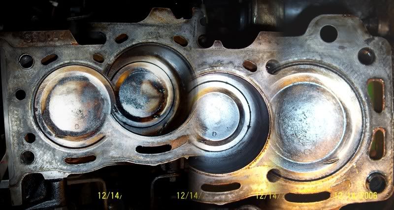

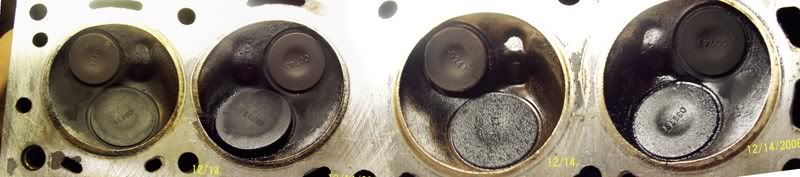

Fullaluv, in your pic of the head, it looks like a little oil consumption going on in the 2 cylinders on the left.Looks like 3 & 4 with 3 being the worst. Be sure to check for cracks in the pistons while you have them out.

I could be wrong but 1 and 2 look like the valve stem seals are leaking on the exhaust side...... does anyone else think this.... make sure the little spring clamps are right and not riding up when they put them on... just a thought

I think Cat Man is right, They do appear like the exhaust is sticking open, heck it looks like you can just about see daylight through one on the intake side aswell...
That could be the loss of oil right there, if so good eye ctmandu.
PostPosted: Wed Dec 13, 2006 11:59 pm
Posts: 2013
The cam and rocker assy's are still in place. That's why the valves are open.

Meanie's right about the rocker assembly. It looks like I better do it again though, to check all that stuff. I can see some marks on the pistons where the valves have gouged the piston. I did make some adjustment errors the first time around. Maybe the holes are there. I'll photograph some more today. I'll try to see if the stem seals are riding up. mytmouz, please tell me where exactly might I find the cracks in the pistons?

Look for a crack most anywhere. Especially where the valves hit. Also, if they hit you might have a bent valve, best get it checked.

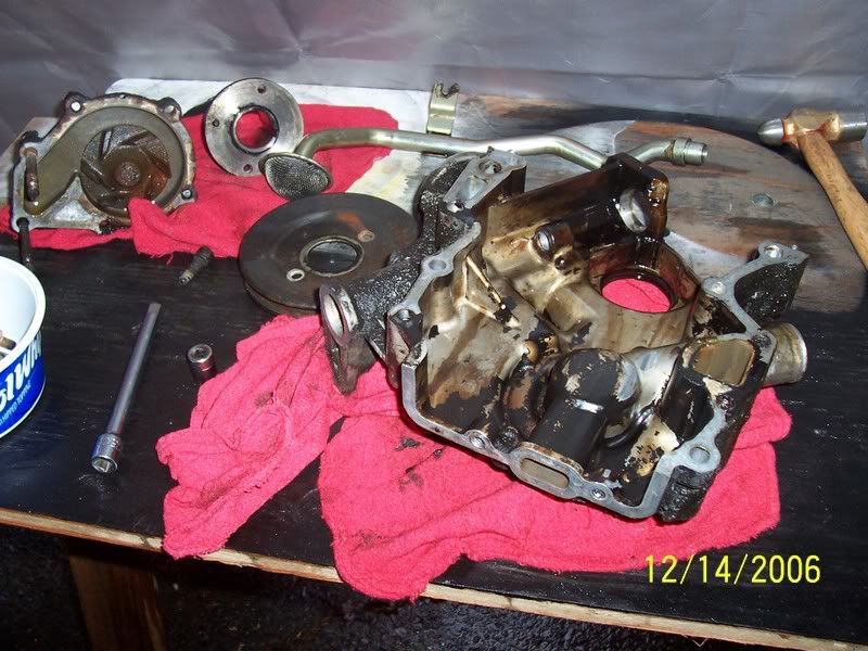

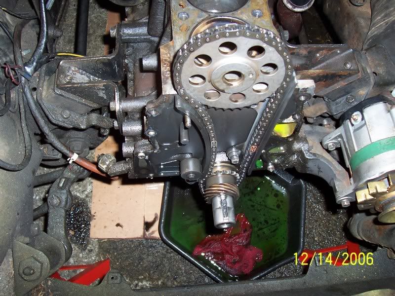

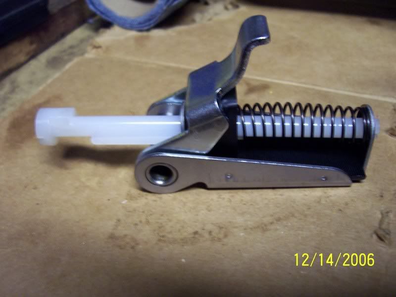

I'm back. I got the timing cover off, took almost 100 pictures, and I stopped short of removing a piston. Lots of photos to show:
Image Image
Image Image
Image Image
I worked the new tensioner a little until I understood it. The last two photos here show the "LOCK" and the "SET" positions of the adjuster in that order. You can see what is happening, and why the spring has to be depressed to put it in the "LOCK" position, for component assembly/disassembly. I wish I had had this clearly explained to me. Bottom line, the tensioner has to be left in the "SET" position, or the timing chain will wreak havoc. I will do more photos later, but right now I'll tell you there was some scoring done by the timing chain to the area.

That's the smartest gameplan that anyone can take. Taking time to figure out stuff like the tensioner mechanism will give you a deep understanding on how it all will work as a unit. And you were reading thru the manual. Man, you're making all kinds of brownie points today! These pics are great! This alone is valuable to the uninitiated.

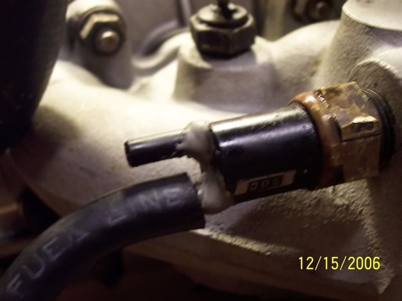

I'm going to check the timing chain for length and see if it needs replacing. You notice that sensor that I told you I repaired with JB WELD in the picture just above the laid-out timing chain? I never really figured out what hose goes on which of the two connections it has. I'll bring it up later.
