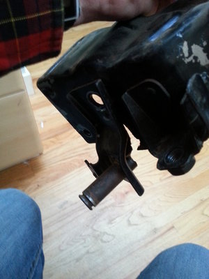

The clutch pedal bracket broke. Every time I would adjust the cable it would work for a minute and then suck again. My daughter called me to look at it and the pedal was way up to the left, almost to the firewall. I bent it back far enough to limp the truck home, but will need a new pedal assembly I think. Is this a common issue with LUVs?

And so I am now removing my pedal bracket (who knew every other part of the truck was connected to this piece of metal?) After removing about a thousand screws and switches and stuff, it is finally loose. (Picture Chris Farley upside down and backwards looking up into the dash...."Fat man in a little truck") :lol: I am heeding advice to take it out of the instrument cluster hole. I am wondering how to disconnect everything and know how to get it back in when I'm done. I guess I will mark all the connectors with a sharpie. At this point in the game, it looks almost impossible to move the wire harness out of the way. I am hesitant to unwrap it....I will post when I am victorious! 8O

I got it out today. I only hope I can get everything back in and working the way it did before. ANY advice would be appreciated.

Here are some pics...(I hope).

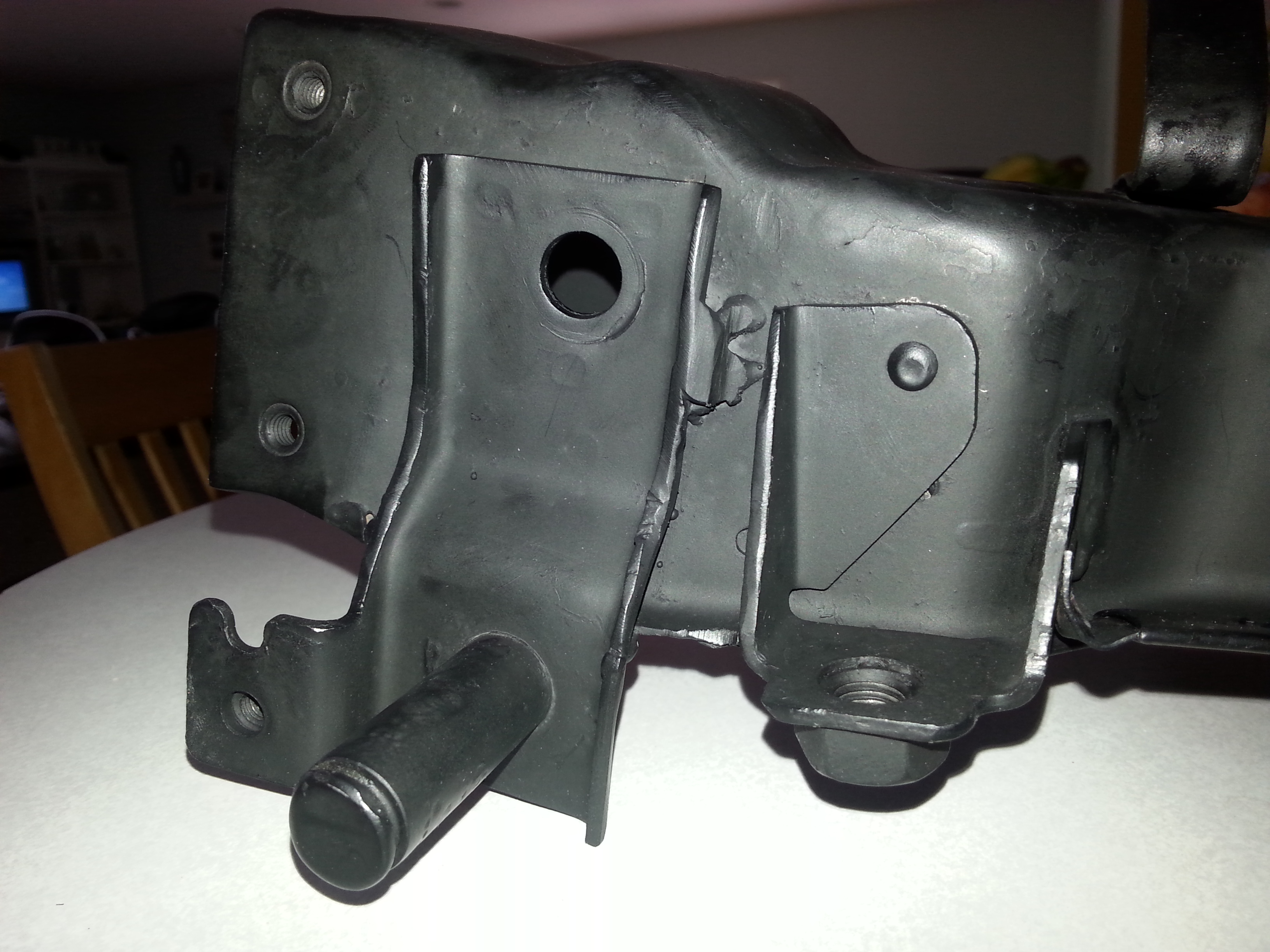

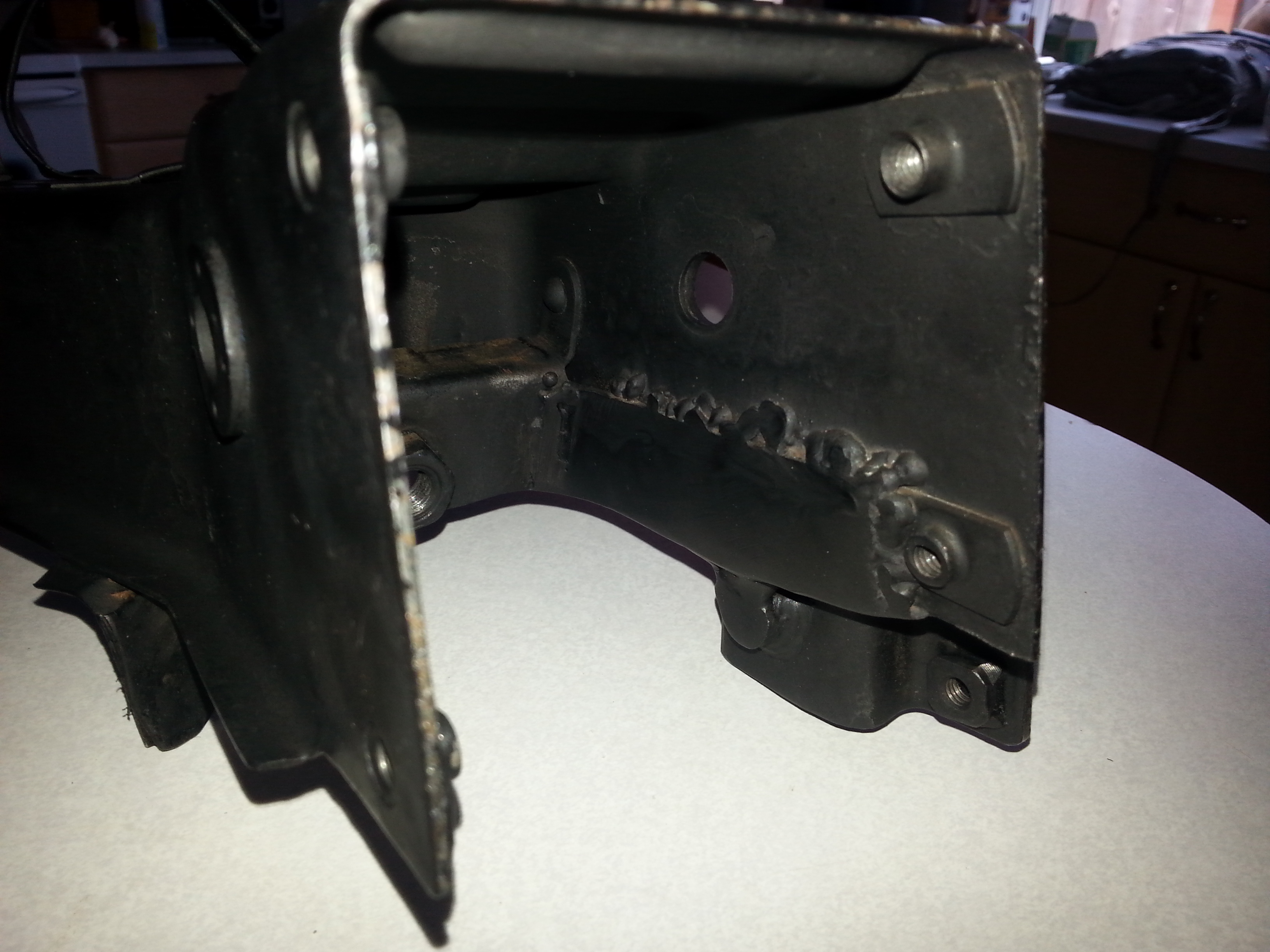

Got the bracket welded. getting it back in is about as easy as getting it out. :lol:

Have owned a 79 4X4 for 17 years I use to go thru clutch cables constantly. The pedal bracket was to week and would bend making the cable bind and eventually break. This is a very common problem with the 4X4's I always carried a spare clutch cable they would break so often. I'd weld the bracket back together but the design just isn't strong enough. I fabricated a bracket that bolts in using existing mounts, it supports the floating side of the pedal bracket, no more problem, ever. The clutch cable has lasted over 10 years since I did this, still have the last spare one under the seat. If anyone interested I can take a picture of it.

The pedal bracket is back in. (Amazing how easy it is to drive now). I have gotten all the electrical connections back together in their rightful spots and......would never wish this particular removal/repair/installation on anyone with fingers as big as mine are...ever. Thank you again for all the information and advice. With there being only one thread about the pedal bracket repair the moderator may want to move this or change the title.
