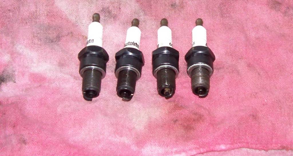

So went out to try and start and it almost took. Smell gas. Primary smell's gasie and is wet. Pulled the plug's and they are wet with gas and blacker than before it ran. Would it have flooded when my Dad was adjusting the mixture screw too much. Flooded, backfired then no restart as plugs were too wet? Can they be cleaned up to fire again?

PostPosted: Tue Dec 21, 2010 9:55 am
Yes, they should work again after you clean them up.

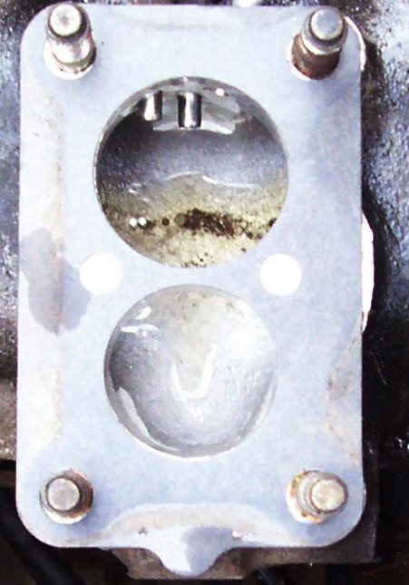

So this photo attached is what I found in the intake after removing the carb again. Is it normal to have that much gas sitting in there? Also... that black crap is a first. WTF? Any idea's?
holy hell lol deja vu. thats how my intake looked when my carb was adjusted wrong onlt my puddle was a little deeper... and when i turned the key i got nice big fireballs out of my carb lol
try backing the throttle screw out till it BREAKS CONTACT. with the throttle plate.. then put it back in 2 full turns. the black stuff.... could be crap from the fuel lines or the bottom of the tank, or it could be gunk from the line that breathes from the valve cover to the intake. or it could not be. lots of random black gunk producin areas of a truck.

I looked at the linkage pix from the kit & the chiltons manual and it doesn't show clearly how they all are to fit properly. The amount of sitting gas in the intake when the carb is removed seems way too much. Fouling my plug's I think. The weird thing is after the 1st rebuild a month ago, it started right up, then died in 5 minutes and I can't get it running again. Have fuel & spark. Compression. No vacuum leaks found. I hope I can figure this out. On 5 months not running now.

carb is cleaned & rebuilt right. The float tang was off. The float was sitting 40 degrees off paralell with the bottom. Now wondering what is the easiest or best way to clean the plugs & get the excessive gas out of the chambers?
PostPosted: Tue Jan 11, 2011 7:26 pm
Remove the plugs, throw them away, spin the engine over WITHOUT plugs to push excess fuel out of cylinders. Install new plugs. Note! Let fuel that comes out plug holes dry thoroughly before starting...
