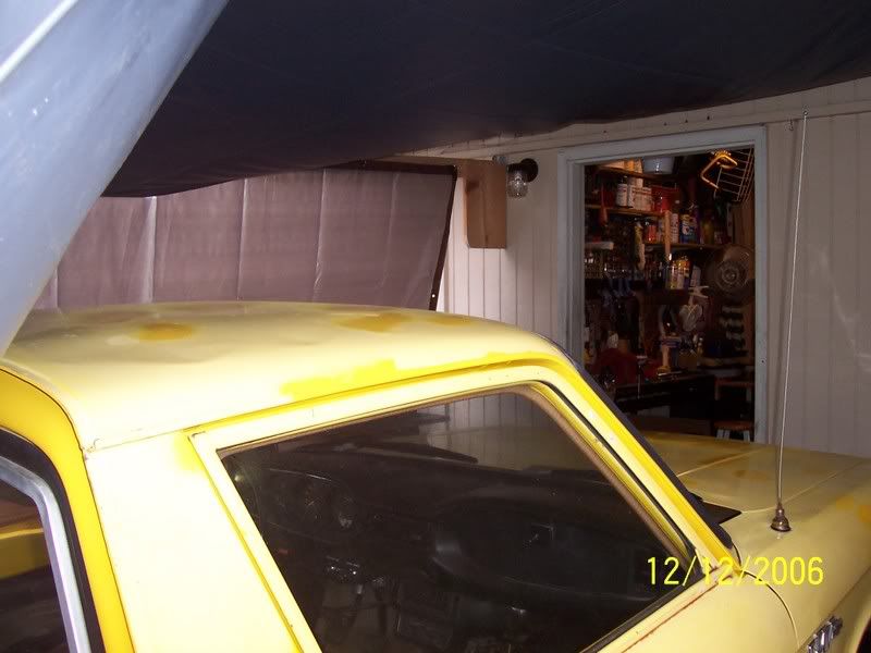

I'm getting warmed up again! I put an extra tarp outside. Doofus can't see what I'm doing, and I don't have to look at him. It also keeps more of the elements away, and I like it just fine. Note the board I added to keep the light to myself!!!! The top tarp is purposely sagging to keep the rainwater drained.
Image Image

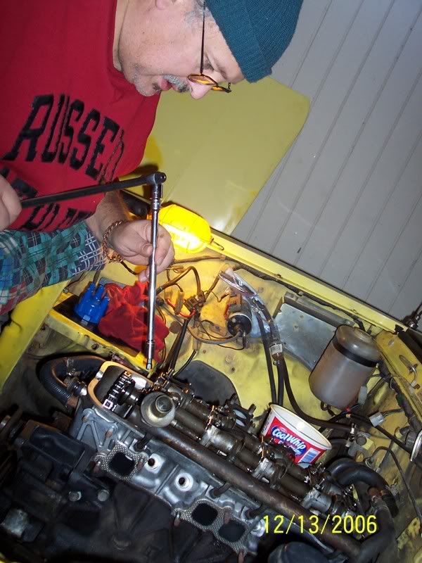

I found that the paperwork is all good on the LUV today, and I'm going to progress. I did remove the head again today, but didn't see much obvious. The head was carboned up some though...
Image Image
I'll be taking a look at the pistons tomorrow.
