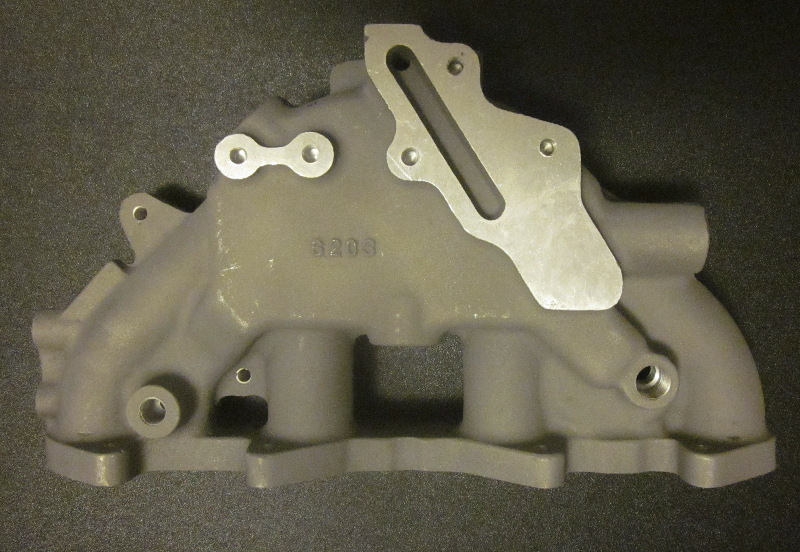

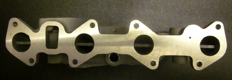

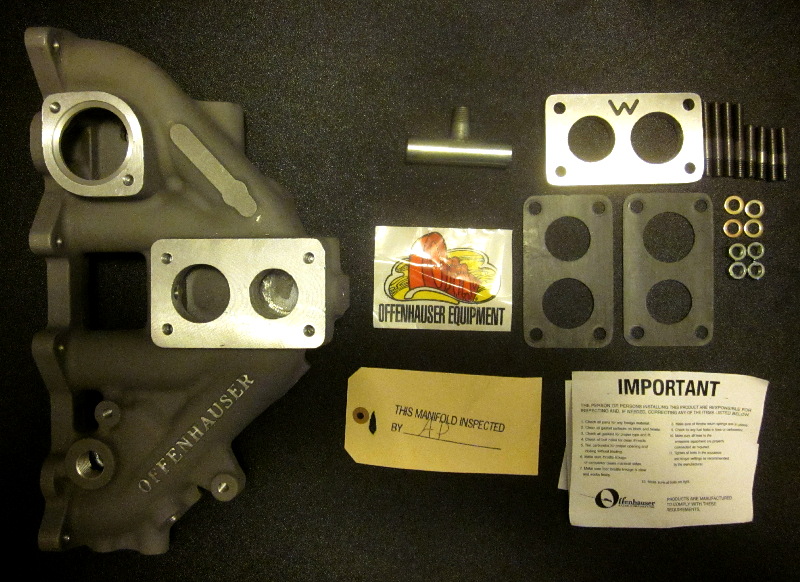

I got mine today from Mocadeth, NICE STUFF and EXCELLENT service! :ebiggrin
I thought I'd share some pics for others to see what to expect if they order the Dual Plane version. I don't know how it will perform yet, and am still wondering if the 6204 CW would offer more power or not and what other differences there might be in overall performance between the two? I'm guessing the dual plane offers better low end response and slightly less peak HP/TQ?
Either way I'm having fun, just got my rebuilt 1.8 engine home from the builders (J&S Engines in Spokane) looks like a first rate job! The only mod from stock is an RV grind cam. I will be adding a Pacesetter header, elect. ignition, and of course a Weber for the intake.
Question....This intake came with a carb adapter, do I need to use it with a Weber and which Weber model would be the best for my combo? I want the electric choke.

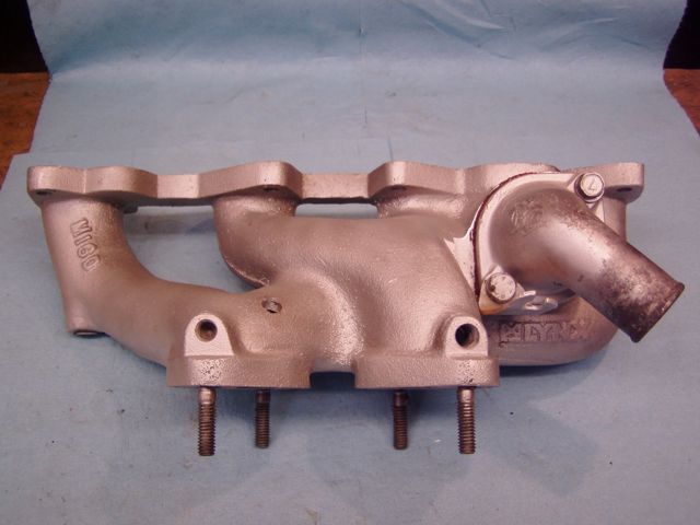

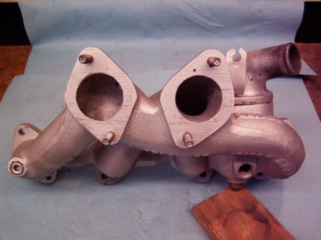

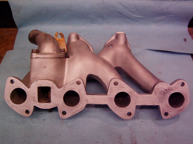

Another off topic question, I also own a LYNX M160 dual side draft intake. What carb model #s would I run on this intake? Delardos and Webers are all I have to go on, does anyone have specifics and precise carbs numbers and sources to properly set this thing up? Would this be a HP upgrade to me Offy intake or a step backwards?

This is the style LYNX intake I have

Glad you received the intake without any problems! There are tons of pics of both of the intakes back like 3 pages and there are even some pics of other intakes that Offy used to make for the LUV back at about page 9 or 10. If you look back at the pics around page 9 or 10 there are also some scans of the sheets Offy sent me from their book and that shows a comparison chart and other specs. That may help you a little with the performance comparison. As for the Weber carb adapter, I am not exactly sure, but I think it is actually a spacer? You may not even need it, I really am not sure, you would have to check with someone here since I haven't had my own intake installed yet. Good luck with the build and I am sure if you have questions you might find most of the already answered in this thread or someone can help you.

Yes, use the included spacer. The stock setup has a (crappy) spacer between the carb & intake too.
The Weber 32/36 bolts up beautifully. You will have to fab the throttle linkage brackets (the supplied and the stock one) together. Pretty simple 5 minute job.
And plugging all the holes if you decide to bypass the smog is a bit of a pain, otherwise it is a painless and noticable improvement.
As for the dual sidedraft intake, my guess would be that if you do the ignition upgrade, cam, G200/ G180 head, and header, you may see performance gains over the Offey.
But without those other upgrades, you would be overcarburating it.
Like that Offey intake for a 4bbl Holley. Just seems to me like major overkill for our little engines.
