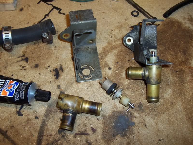

I got the parts from the two hot cold water valves, and decided to tear the one Catman gave me apart to see what it looked like. I found the parts inside were in better condition than mine, so I swapped the parts around, and I might have a working valve together now!!!

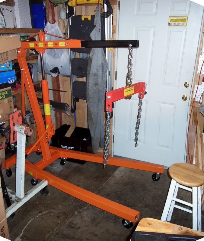

I went and got a foldable engine crane today. Put it together. I also got a load leveler. I will use it tomorrow to pull out the engine from my LUV, and then practice mounting it on the engine stand. My goal is to be ready when the block is here from Pacific Auto Machine. I want to know exactly where I'm mounting the bolts and this engine crane is going to make it all better. No more he-man antics and dropping the engine. Then it's going to be assembled with care. I got Plastigage today too. The pistons, bearings, and gaskets are arriving tomorrow. I ordered at the store with the PartsAmerica prices! The machine shop will get my pistons on Friday, then the work should be done sometime next week.

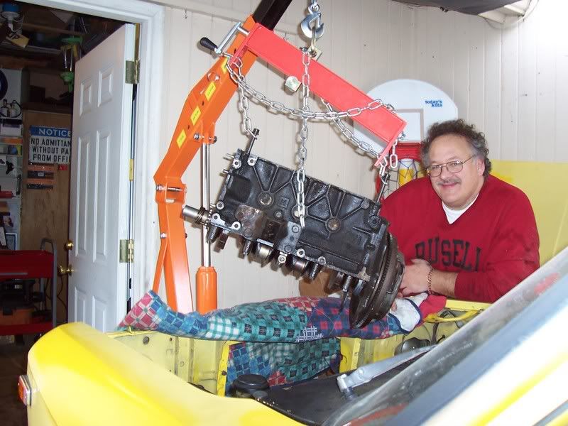

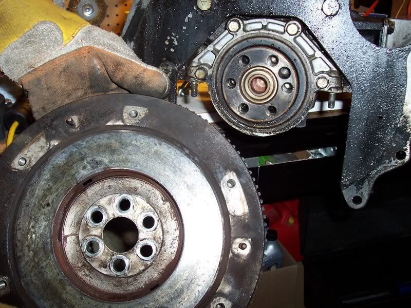

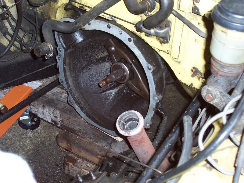

Got it out, yep! I took it out and some things apart. The legs were too spread apart to get through my shop door! I had to fold one up, but it worked! :D
Image Image
Removing the engine/The transmission input shaft and the clutch fork
Image Image
Hanging over the workbench/Pressure plate and clutch plate
Image Image
Flywheel/Signs of overheating
Image Image

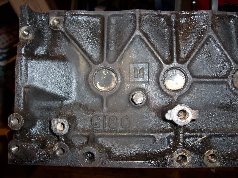

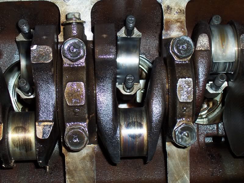

Debris in #3 main bearing. It was full of sludge, top and bottom/G180
Image Image

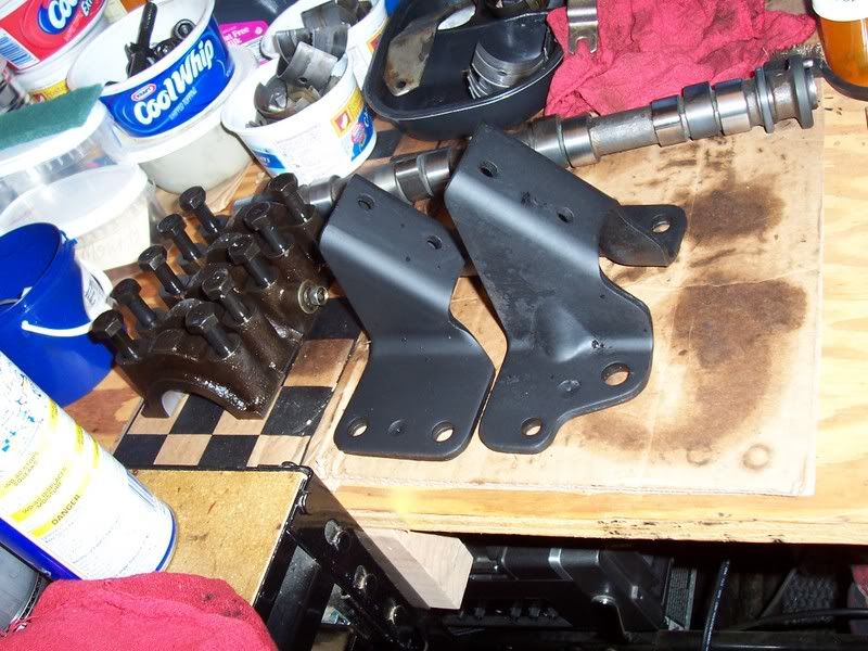

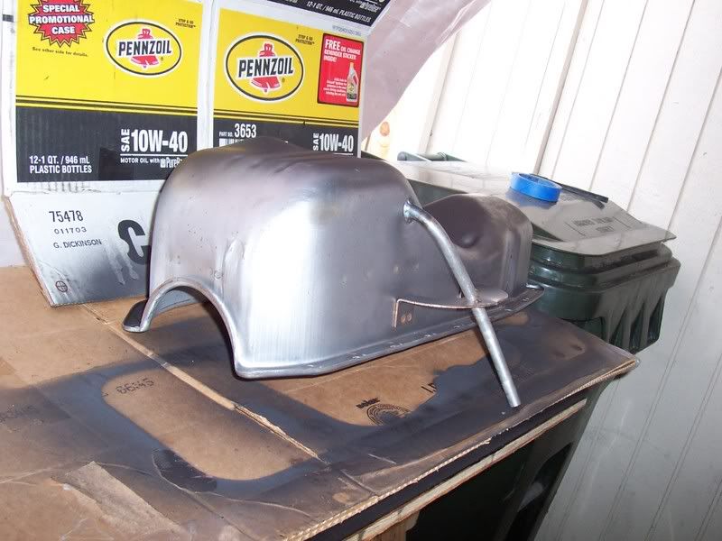

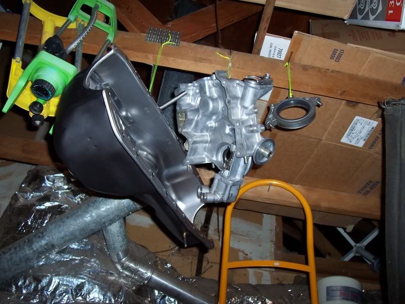

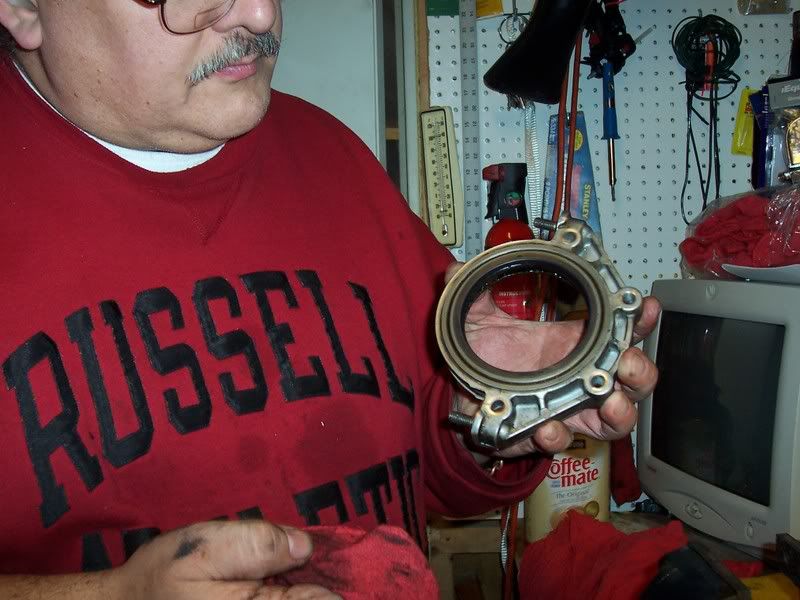

I got a lot to say today. I might not say it all cuz somebody might want to put a muzzle on me. They're already thinking of putting a bag over my head! Well photos can be joined with software, and I use Arcsoft's Panorama Maker to join photos. My avatar is two photos that were subsequently resized to 150x150 pixels.

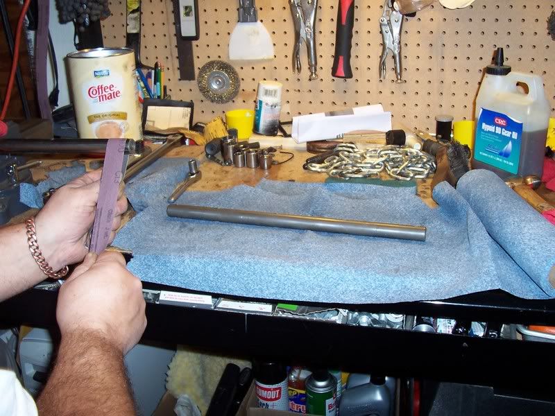

This morning I went to pick up my new pistons and take them in to the machine shop for them to put on the rods. I also picked up the bearings, thrust washers, a new head gasket, pilot bearing, clutch throwout bearing, and chrome piston rings. I took in the rocker shafts which I had rubbed for some time with the green stuff, but Ted at Pacific Auto Machine said they weren't good enough and gave me some emery cloth strips to do it better. I picked up my engine top cover, and oil pan all cleaned up and ready for painting. Really clean! I also got the front cover cleaned, and the oil pump parts they checked out and recommended. I discussed breaking in the new engine, and was told there would not need any breaking in since there was no new camshaft. I discussed the oil pump with Ted and he said they will loan a pressure pump to me for priming the oil galley. I painted the top cover and the oil pan with hi-temp paint, and installed the oil pump into the front cover. Some of the parts are hanging up for staying out of the way. I got started on the rocker shafts, then my wife called me in for her homemade pizza.
Image Image
Image Image
Image Image
Image Image
