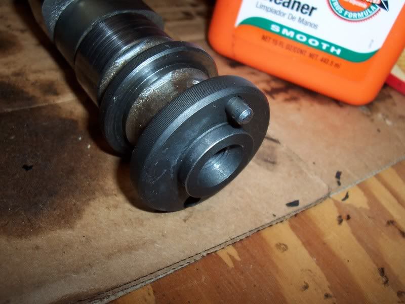

What I have to do with the cam is take it all apart, and clean all the grit out. I left it at the machine shop and forgot to bring it back home for that. I need a ride in just for that now. Have to wait for Monday.

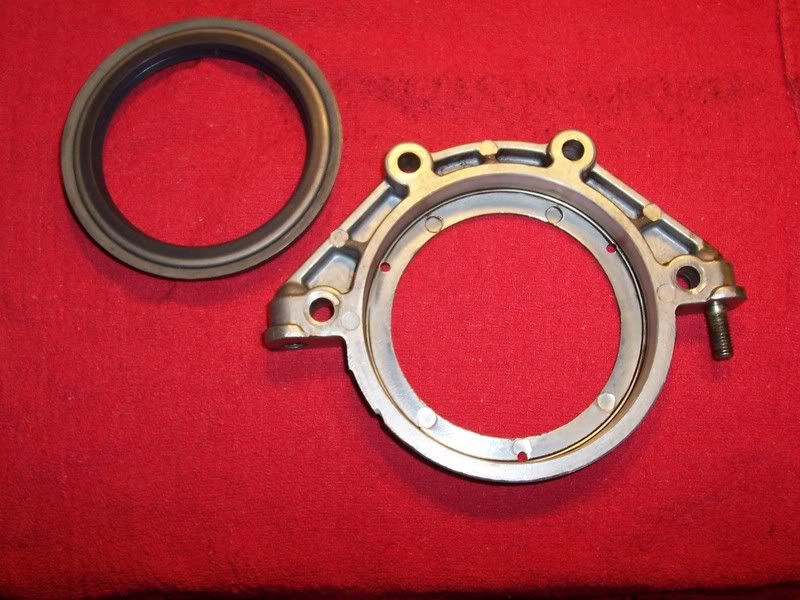

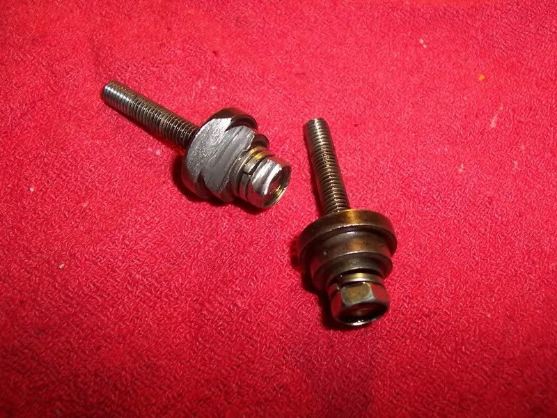

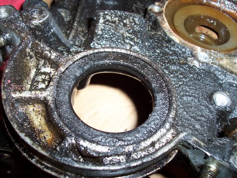

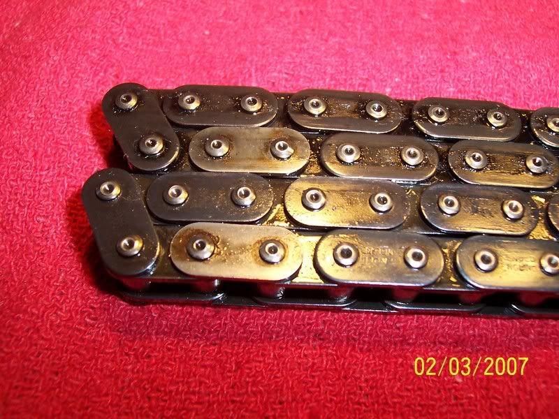

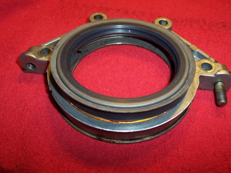

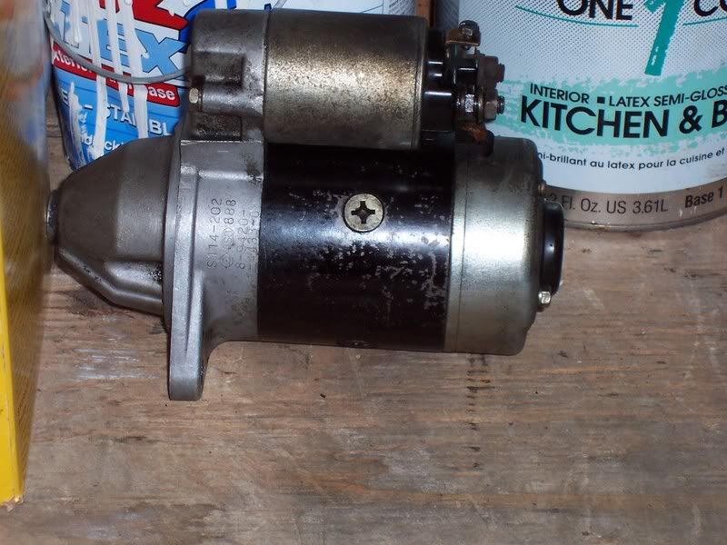

I cleaned up some parts today. The starter, the rear main oil seal retainer, and the top cover. I have photos of the oil jet from two engines: the one from my first engine that was damaged when I didn't have the timing chain tensioner adjuster set properly, and another off Taz's engine. The oil jet fastens through the lower bolt hole in the timing chain guide. I also compared timing chains from each engine, and found that by comparing side by side, the chain from Tazman has less wear. I will use it. The last photo is of the short block with the crankshaft and pistons still in, waiting to be removed.

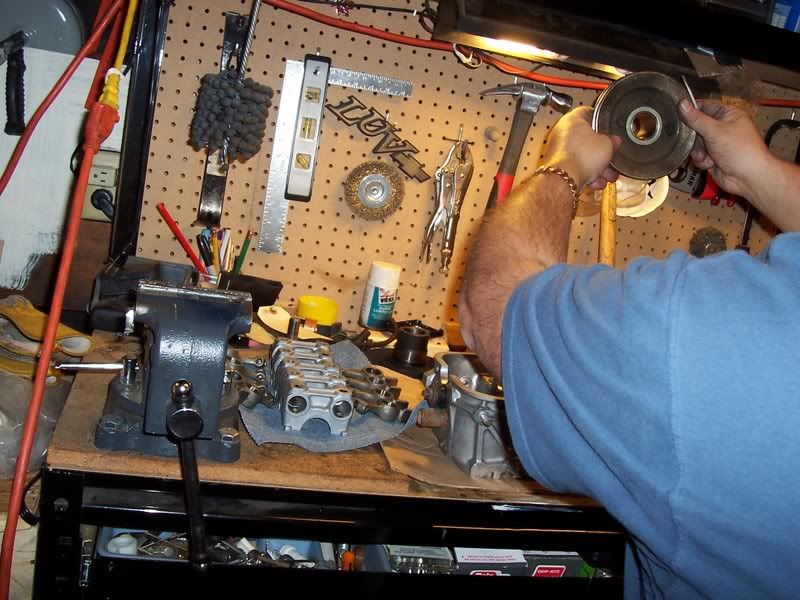

Here is the shop where I'm having the work done on my block, pistons, and crankshaft, as well as the oil pump, front cover, oil pan, and valve cover. The latter are being cleaned, and the block and crankshaft have already been cleaned and magnafluxed. The block will be line bored, cylinders bored, and new pistons will go on the rods with chrome rings. The crankshaft is being ground and polished. I took in the three oil pumps, and they fixed me up with one good pump by swapping parts around. They also said the vaseline thing would work! However, they're going to loan me a oil pump to prime the oil galley, so my hats off to all you guys who said it must be done.
This shop has been in business since 1961, and the people working there really know their stuff. They're friendly and knowledgeable, and always take the time to answer any question I might have. They specialize in rebuilding older engines, so Chevy LUV owners, tell 'em John sent ya! I have no doubt they can handle anything you want done.

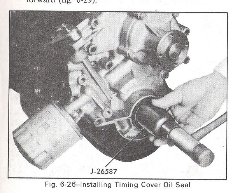

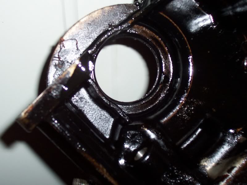

Dan, that's a good question. Tell you what I'm gonna do. I have a front cover that I removed from Tazman's engine. It's greasy, and grimy, but I don't care, I hadn't planned to use it. Why don't I go out and take a video of myself trying to remove that seal, and see if I can do it? I'll set up the camera, and we'll get this video here for ya within the half hour if it all goes well. When I took the engine apart, I removed the seal by tapping on the back of it through the opening. Let's see about removing it from the front cover after the harmonic balancer is taken off the shaft!

The answer is most definitely, yes. I would use caution to not damage any of the aluminum around the seal by trying another spot on the seal if it doesn't come off as easy as it did for me. When you replace it, use a large enough drive such as a large socket, or the right installation tool. It's tool #J-26587. My manual has a picture of it being installed, so there is your answer.

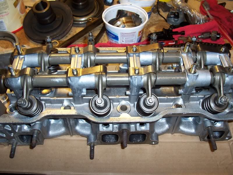

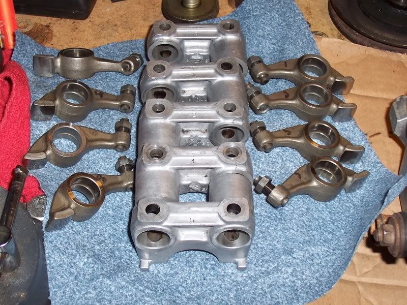

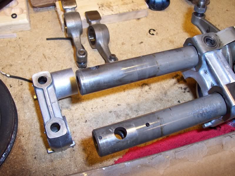

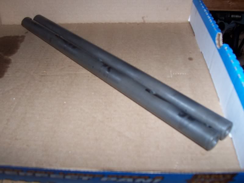

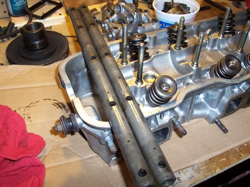

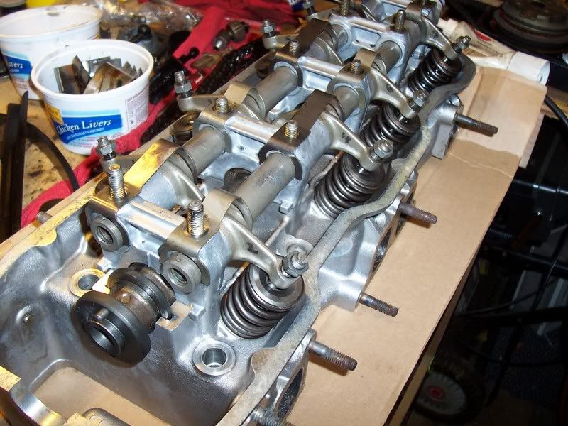

Larry took me to the machine shop again today, and I brought my cylinder head back. I need to take the rocker shafts apart and return the shafts alone for hot tanking. The reassembly will be all mine.
Here's a few photos.
Image Image
The head as it came from the shop
Image Image
Taking the rocker arm brackets apart
Image Image
I also cleaned the harmonic balancer (Notice the white enamel on the timing mark!)
Image Image
Rocker arms were numbered with a Sharpie®
Image Image
The rocker arm shafts ready to go and the camshaft
