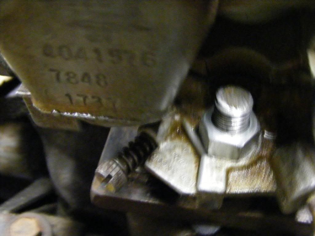

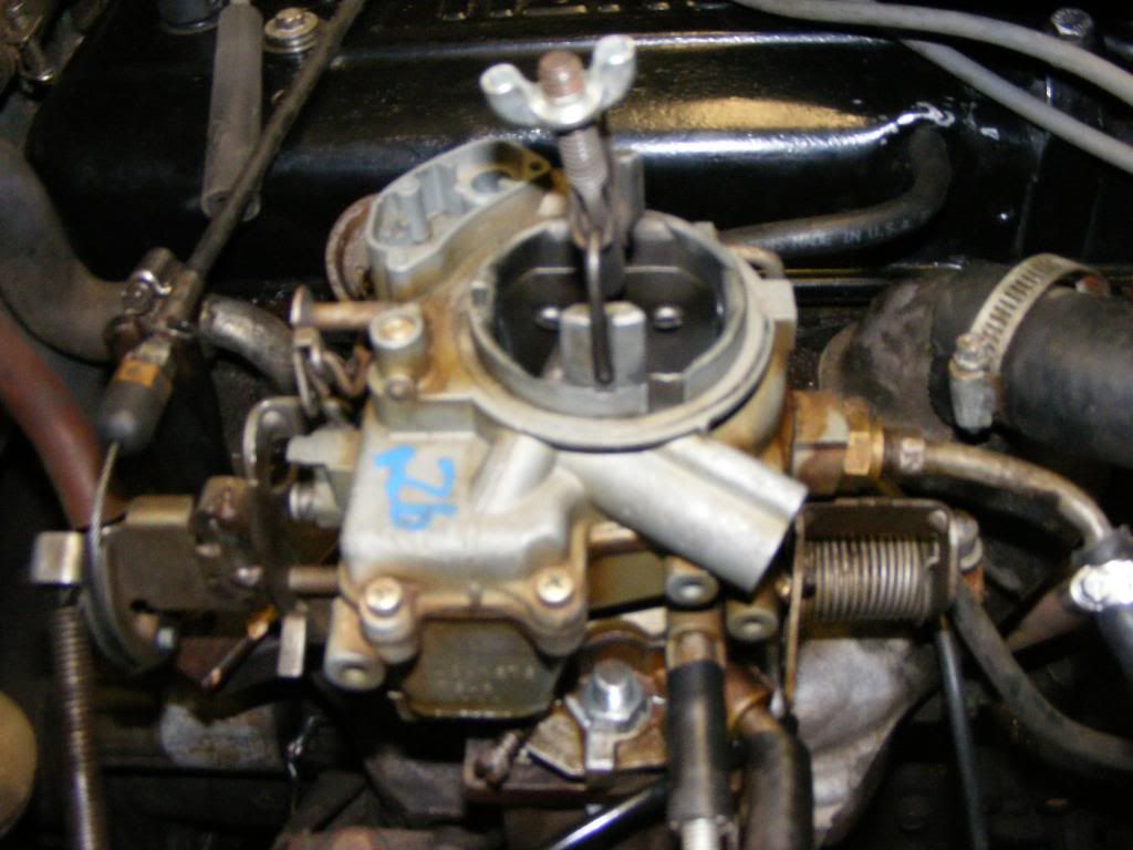

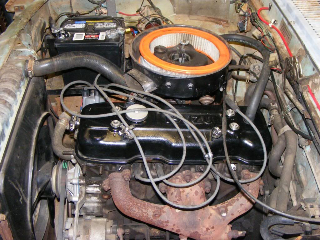

I'm a bit curious about this carb you have. It doesn't sound quite like anything I've seen on a LUV before. Any way you can get a few pictures of that up here? I've seen Webers and rebranded Webers, but that is about it. I think I've heard the name Elkton associated with Motorcraft before, but I don't know about the part number. I think there was a version of the Weber 32/36 made for Fords that was rebadged as a Motorcraft part number, 5100 I believe, and I think it bolted straight to the intake. There is also a Motorcraft 2100 that might bolt to the Weber adapter plates that fit a LUV. Both are 2Bbl carbs though, so who knows what you have there. Pics, please. :)

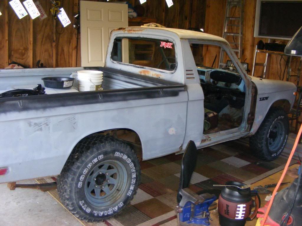

Here she is!!
Love the flames!!! I think I will leave them on there........

That carb is one of the oddest things I've ever seen attached to a LUV. I did find something that looks very similar on ebay With lots of pics here. Looks pretty close and they say its for a Dodge Slant 6 from the 70s. All I can say is wow, someone got creative. Could have been decades ago too. Looks like it has an adapter plate under the carb that bolts to the stock intake, probably hand fabricated and one of a kind.
Given that, who knows what else could be lurking on this truck. There could be all kinds of not stock parts or creative modifications.

That was a great job finding one that was extremely similar!!!! Following your lead and looking at other carbs, it greatly resembles the Holley model 1945.........What do you think?? Yes the adaptor plate is handmade. It is kind of rough but I guess it does the job. The carb seems to do the job, but maybe upgrade when I get the motor lined out. Tks 800!!

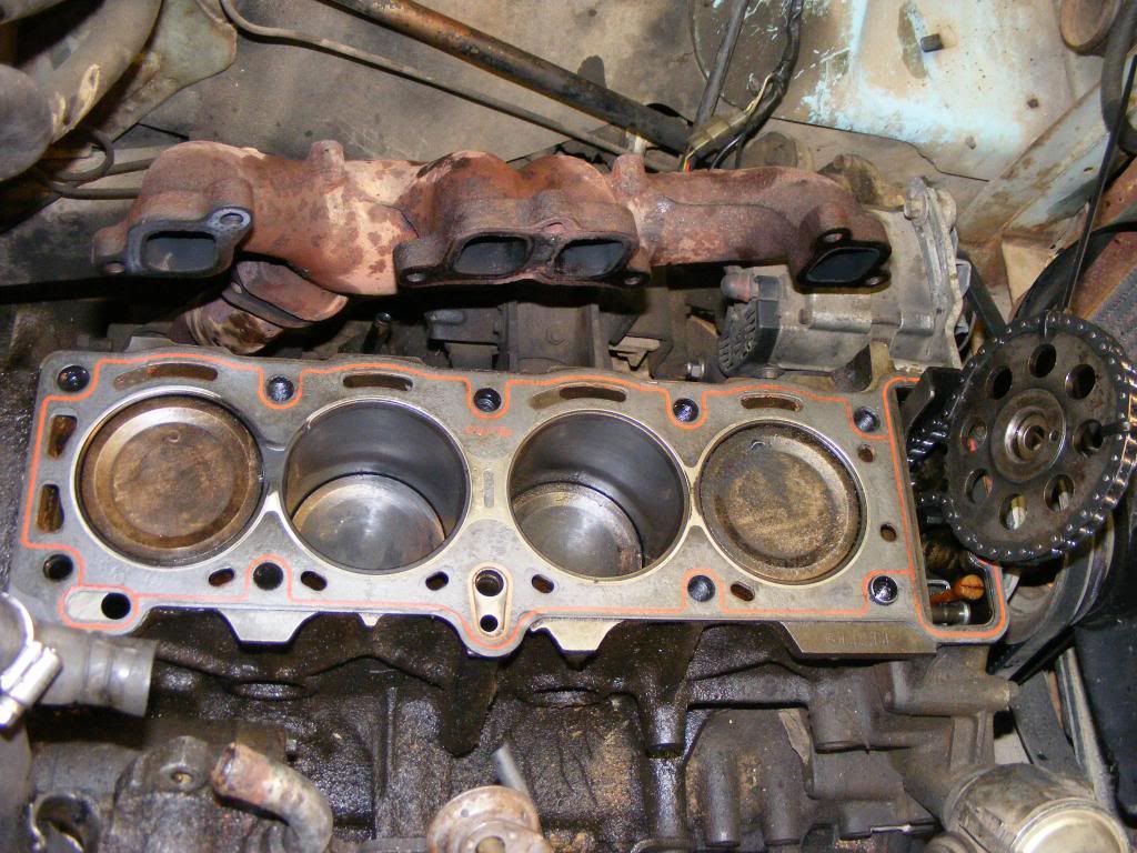

Well, here's the pistons they dont look too bad.
Here's the culprit! Good job on diagnosing!
There is alot of carbon buildup on the valves and sludge around the cam. What is the best way to clean it up? Also how do I clwan up the piston tops? Thanks!

PostPosted: Sat Mar 16, 2013 7:17 pm
You said 2&3 had 0 compression, the thread says 2&4 are not firing then a picture shows up with 3&4 cylinders that should be 0 compression. Do you know what cylinders are what?
PostPosted: Sat Mar 16, 2013 7:23 pm
Joined: Tue Feb 19, 2013 7:47 am
Posts: 40
Location: Greenbrier, AR
My mistake. 3 and 4 cylinders are the ones messed up. And I hope I do or I am totally screwed.

PostPosted: Mon Mar 18, 2013 12:21 pm
Posts: 550
Location: Redfield SD
Well it had been leaking for a while because of the carbon build up between the cylinders.Have you head machined while you have it off.Have them shave a couple of thousandths off so it is straight and will help compression.I would have Vitron seals put on the valves..they help oil consumption and last longer than the umbrella seals.Three angle valve job too.
