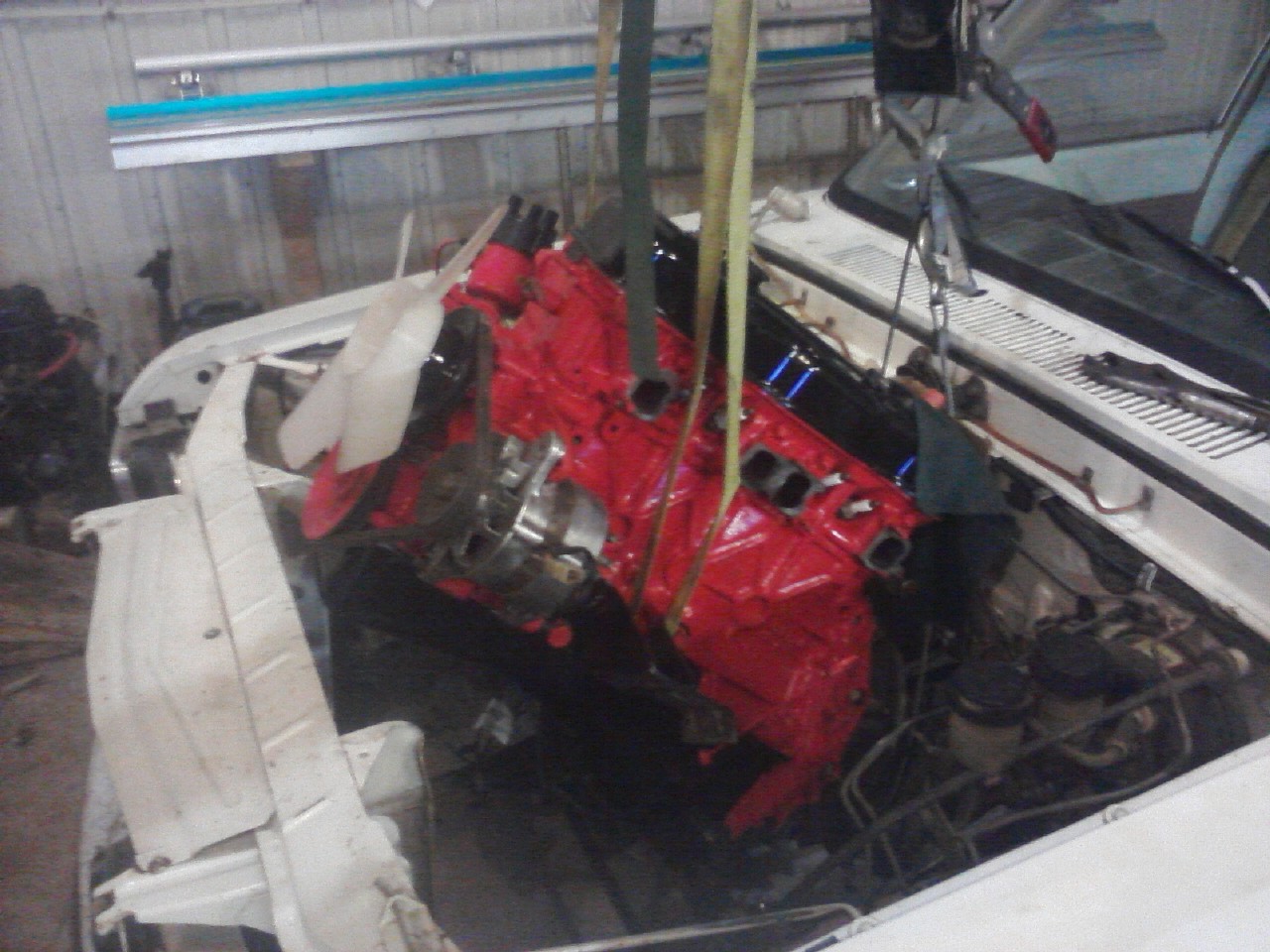

One more question can I install the engine and tranny as a unit ?I couldn't come up with a definite answer searching the forum.

Take the front wheels off and get the front as low as you can, and you should be able to install the engine and trans as a unit. I never could get my cherry picker to raise the stock engine high enough when I was taking it out.

Not unless you cut the tranny support crossmember out & then replace it after the engine & tranny are positioned. The 4x4 oil pan sump won't clear the front drive axle assembly sliding either straight forwards or back, so even with the crossmember removed the unit would have to go in with the tranny pointed down at a steep angle.
Normal installation is with the engine in place, then the tranny tailshaft has to stuff between the crossmember & tunnel far enough to allow the input shaft to clear the clutch as the front is raised, then slide forwards to mate to the engine. Remember the tranny needs to rotate 90 degrees as it is slid into the final position. Since your truck is 4x4 the t-case makes this even more of a tight fit, so remember the t-case outer half will unbolt from the side of the tranny if need be.

I do have the cross-member cut out as I took the tranny out first and them decided to pull the engine to replace the main seal and oil pan gasket. So I was thinking if the oil pan would clear the front axle with the tranny attached it would be alot easier to get it all lined up and bolted together and then install them as a unit.

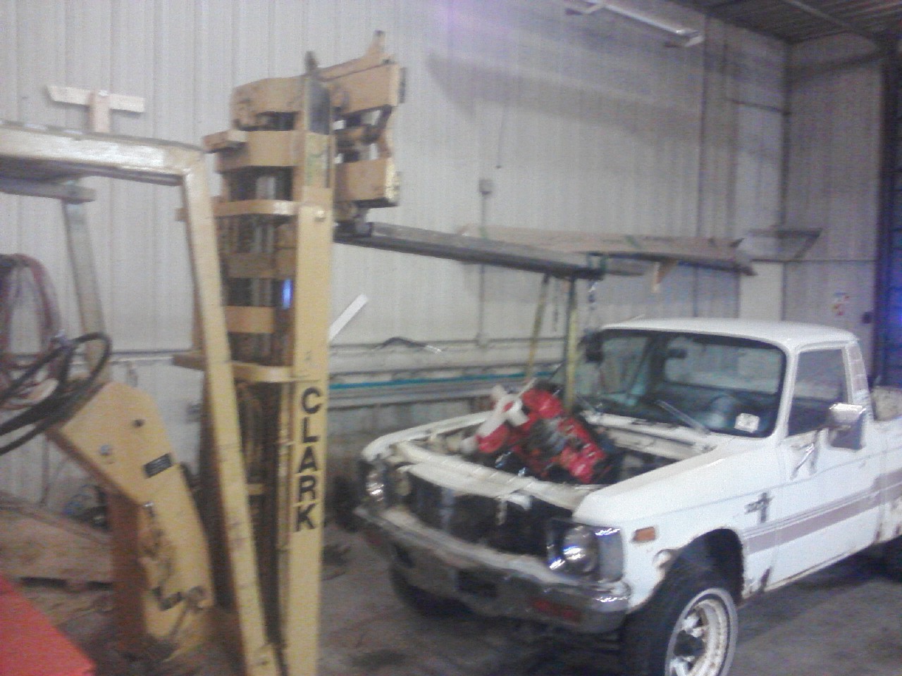

Thanks for all the help guys.I got my engine set in as a unit on sat.Everything worked out great I used a forklift with a fork extention for my hoist. :ebiggrin .I then put a cable come along around the bellhousing to ajust the angle.I'll try to post some pics of the processes.

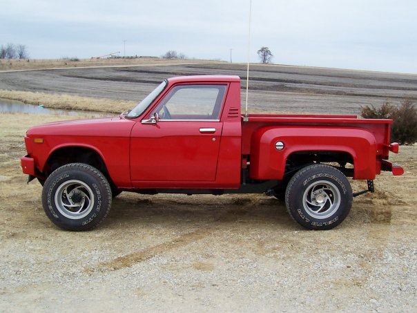

luv'n it,, keep us posted with pictures, ready to c this truck hit the road, and those little g180's are really pretty good for what they are and even if you can get 110 hp out of it will still feel better that 80 horse,

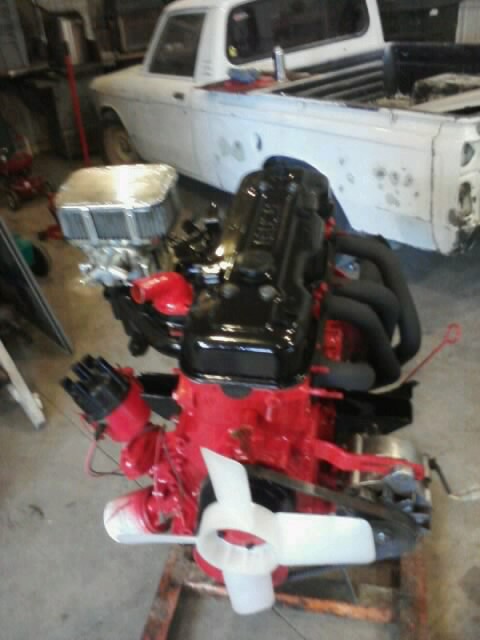

You did a nice job on detailing your motor! Nice work!
