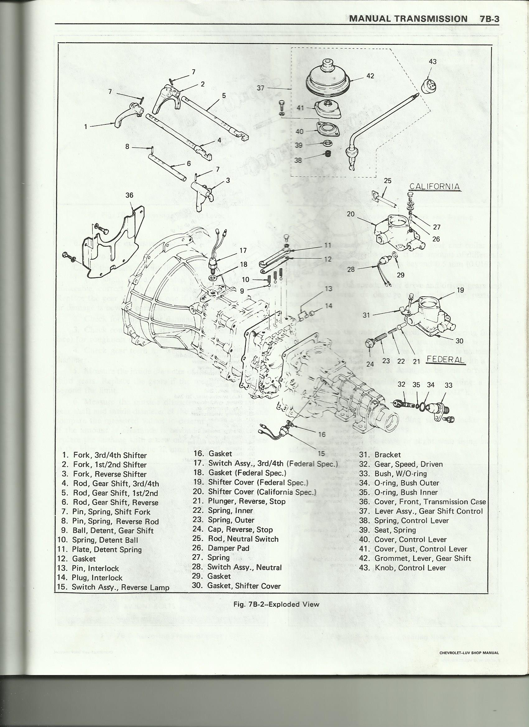

Federal spec trannies have two electrical switches: one on top just behind the bellhousing bulge is the 3rd/4th gear or CSR switch (which is part of the coasting richer system in the carb); one on the rear driver's side corner of the shifter tower (not the shifter tower cover) is the backup light switch. Cali-spec trannies don't have the CSR switch (the port has a plug instead) but do have a neutral safety switch in the shifter tower cover right above the backup light switch position. All are mechanical switches that screw in with a ball detent on the end and two wires. New backup light & neutral safety switches can be had, the CSR switch I can't find new. You'll have to determine which switch you broke based on location, but I think you broke the CSR switch, probably the best source for replacement is from someone's spare tranny.

Oldestisuzuist, the one that is broken is located where you have described the back-up light switch.
Here's a picture just to be sure.
If it's a backup light switch rockauto.com has them listed, someplace like Autozone probably does also, but probably not in stock locally.

Yep, it's #15, reverse light. Thanks, I looked all over the internet for that very diagram. You have been more than helpful,sir. Thanks.
