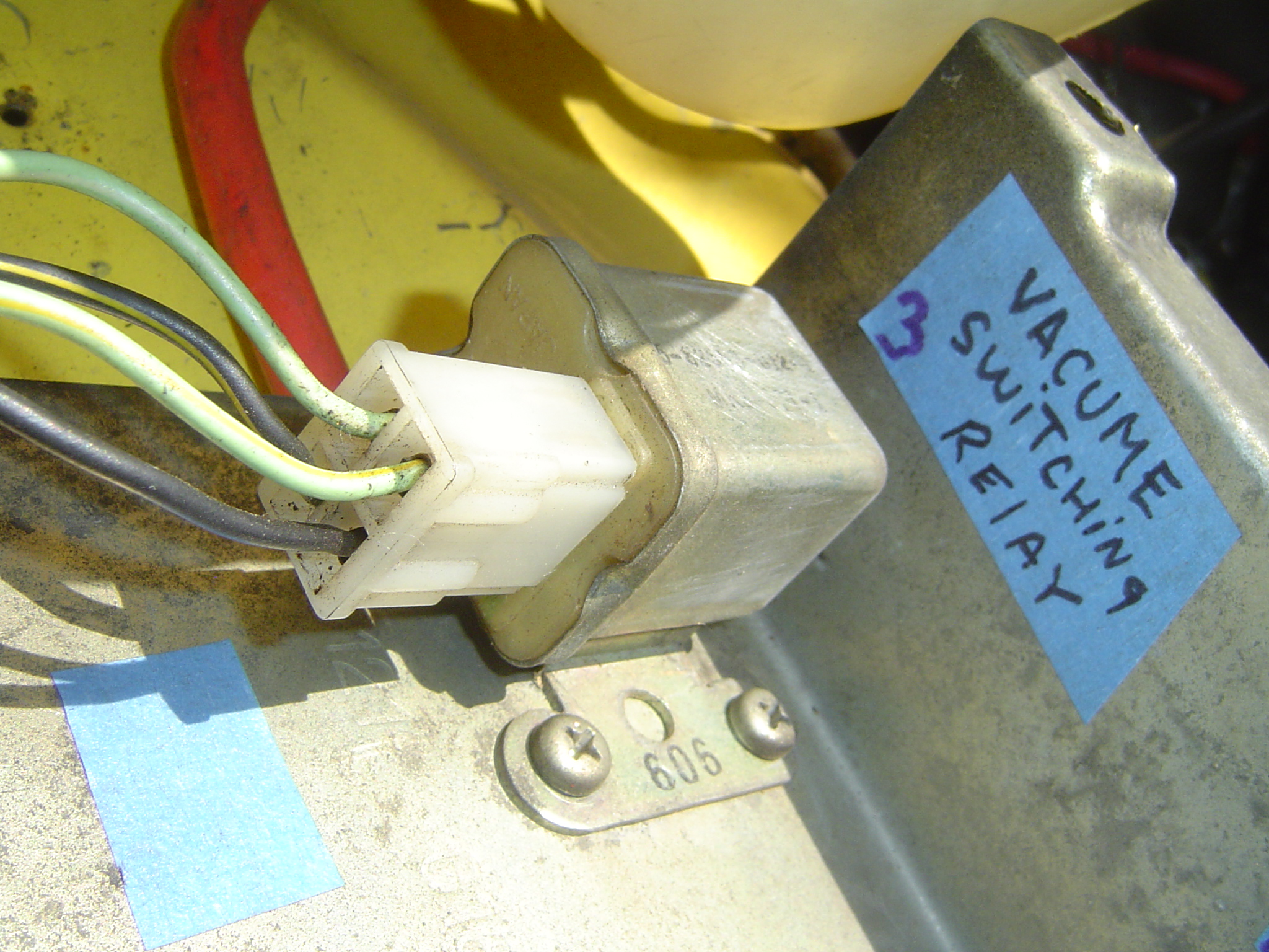

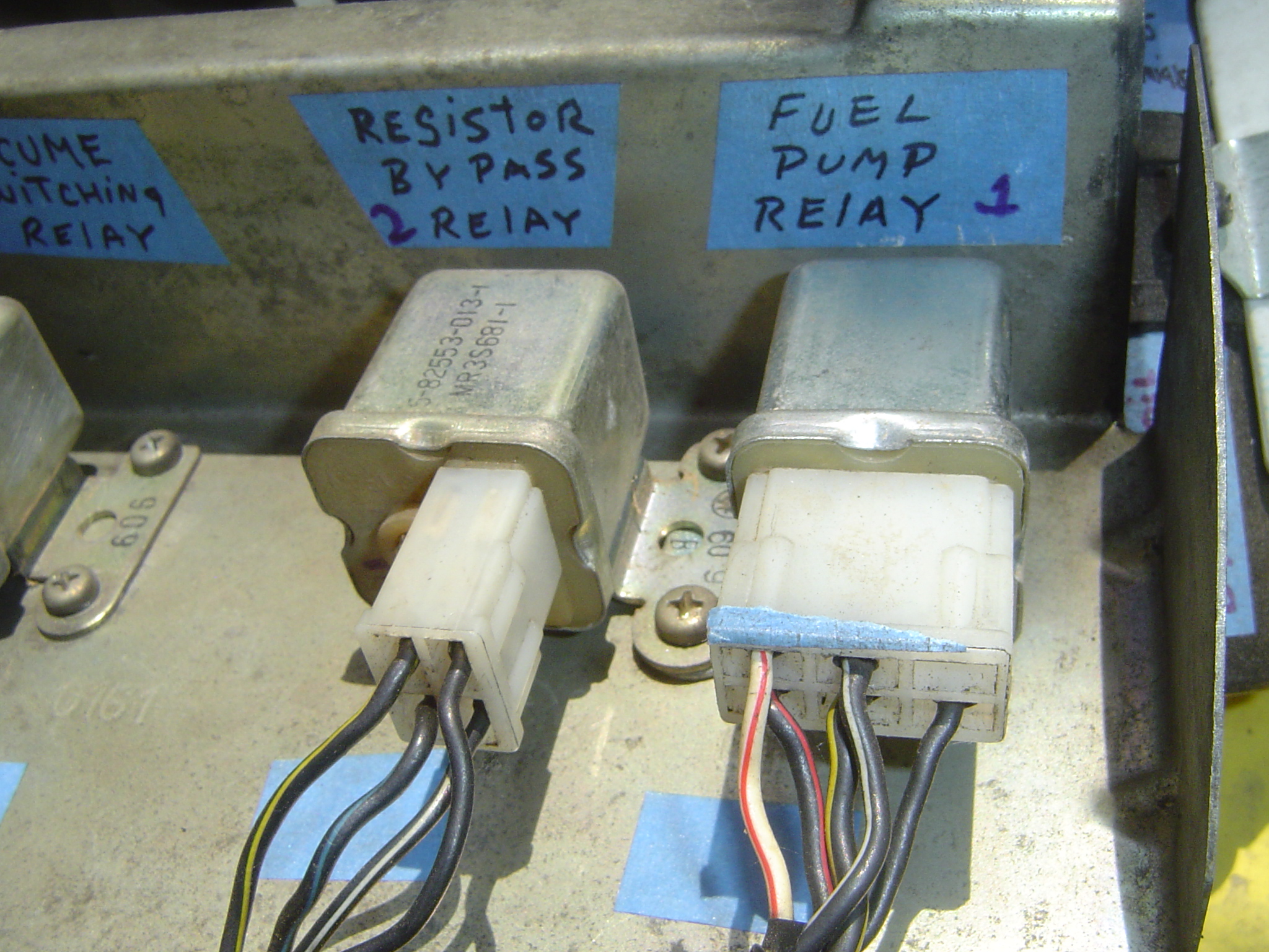

HERES A COUPLE PICS OF MY 1977 RELAY WIRES SHOWING WIRE COLORS AND LOCATIONS IN PLUG

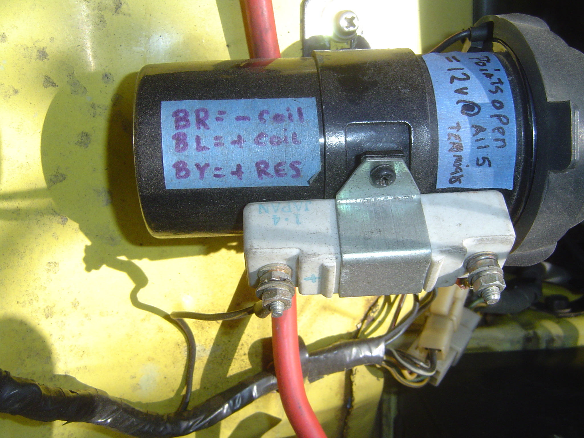

ALSO HERE IS THE COIL HOOK UP AND COLOR
The note about 12v @ all 5 points (** with points open) refers to both the +, - of coil, both terminals on the resistor and the terminal on side of the distributor.
