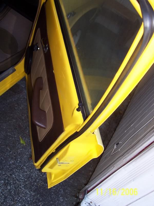

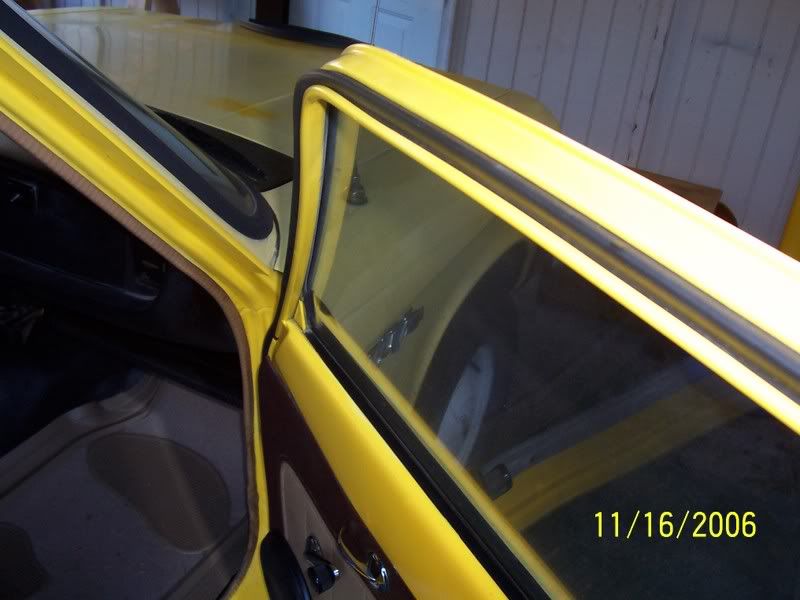

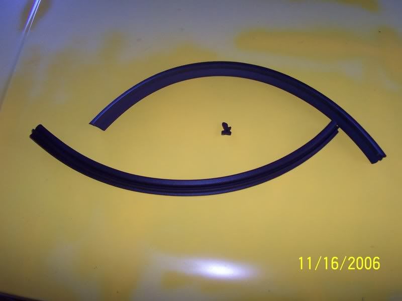

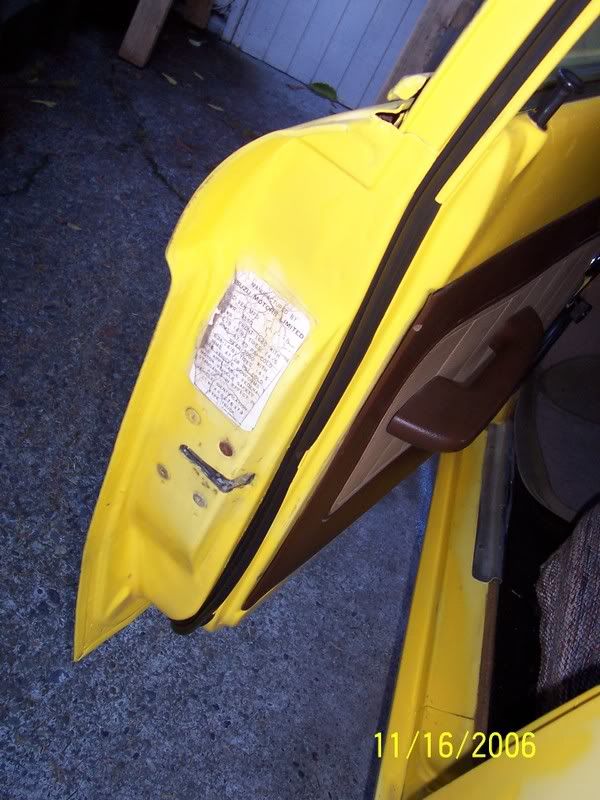

Yesterday I did the weatherstripping on the doors. I removed them and brought them in the house to be warm and dry faster. Outside the weather was blowing up a storm, and I disconnected all my office equipment in anticipation of a lightning strike. Even with a UPS I don't want to fry up all the stuff in my office! Here I am today with some photos for all you LUVvers.
Restoration Specialties sent an ample amount of weatherstripping, and I put it right on. It's just what I wanted, and thanks to LUVTruck.com for the referral!
Image Image
'78 1.8L 4-speed Fleetside
Image Image

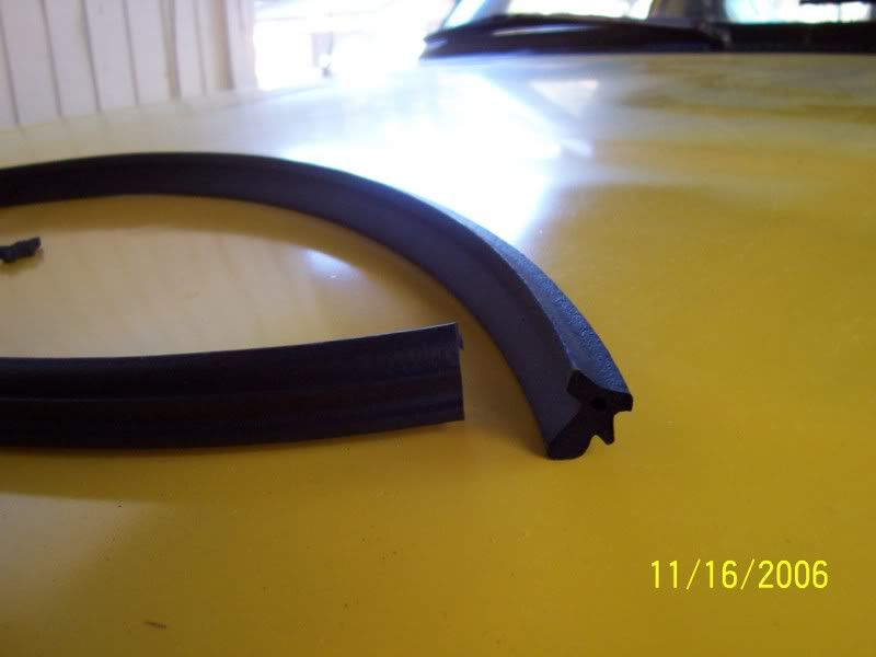

I just did mine aswell. On the corners here, I was not happy. (Same as yours) Im think of cutting two pieces at 45 degrees and glueing them together to make a sharper corner here.

Stead of Completely Cutting The Corners I Would Try Barely Sliceing The Back Side First...That Way It Wont Fold...Then Glue It

I might still be able to do that. I didn't even think of it. Figures, being the very first time I've ever done weatherstripping. I didn't put much glue on the top of the doors since it had the channel and fit very snug. I might be sorry later if it shrinks but it looks like a good seal, so I think I better leave it alone. The passenger door shuts very easily, but the driver's door takes some effort. I expect it to get better with some use.
I could use the two leftover pieces to replace the corners at a later date if need be.
Stub, did you get the same amount as I did? 22 feet? Did you have the leftover? I was thinking of practicing first on a three-inch length, then doing the corners. I think I want to leave it like that for now though.

I oredered 25 just incase.
I think Im going to do the corner thing, cause it just doesnt look right.
and its easy to make a sharp corner by adding two seperate pieces.
Plus I did not glu anywhere that I thought would be snug enough.
You can always glue later after it shrinks a bit, then your golden.
This all seems useless when you can see daylight through your door after you install brand new weather stripping. :roll:
