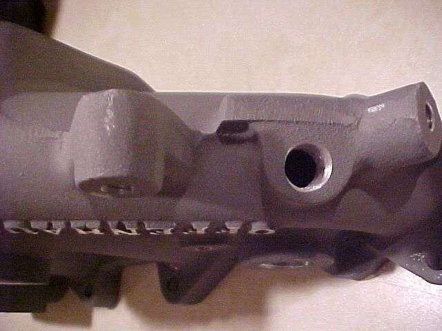

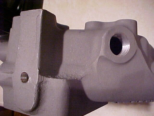

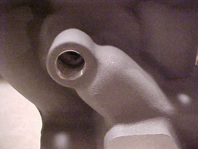

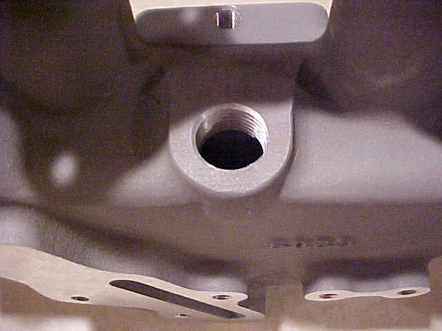

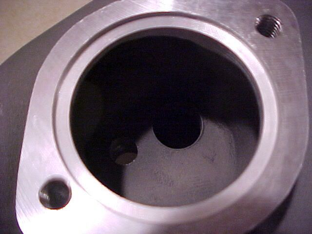

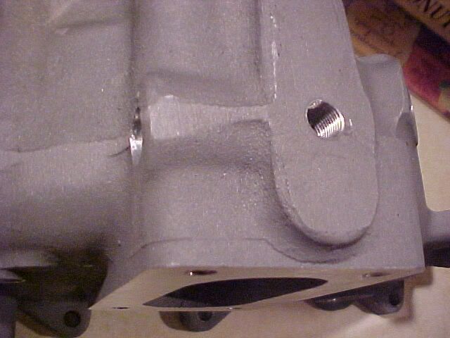

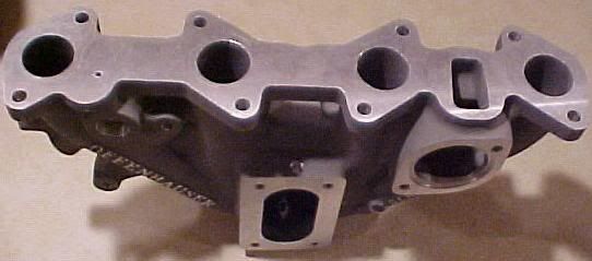

I don't mean to confuse the issue but could the other threaded holes that your talking about be for the Stock location of Carb linkage bracket? These holes I'm talking about would be on the bottom outside corner towards the firewall/fender corner of a stock manifold.
I was wondering about threaded holes on these new Intakes for the purposes of Weber or Stock carb linkage brackets.
I was wondering this because earlier today I had to fabricate something for my linkage after Installing a Weber. With the new carb it caused me to have relocate the linkage and I had to be creative to get it right and it still look good and not so rigged.

I am hoping that Taz or someone can answer this question. I really don't know because I haven't installed one yet and I am not good with the mechanical parts. I am not sure if these holes are for smog stuff or something else. I do know that with this manifold you should be able to bolt a Weber 32/36 up to it directly.

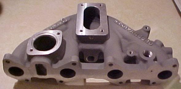

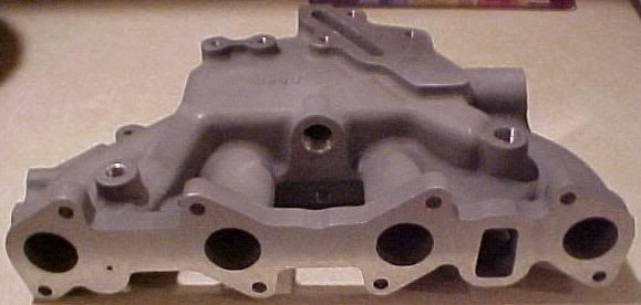

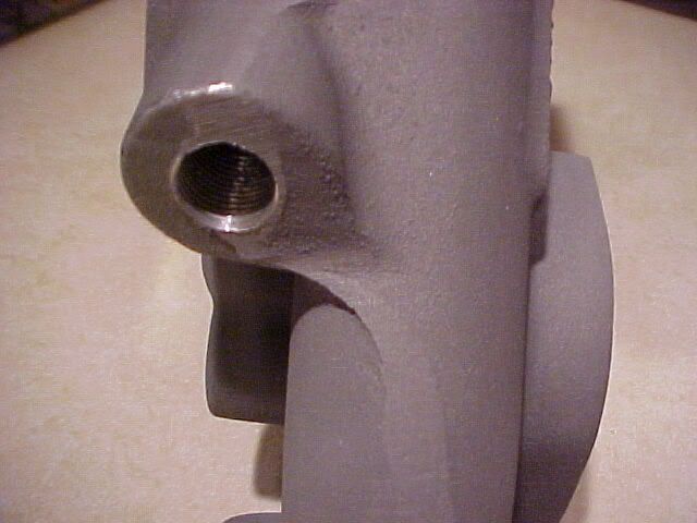

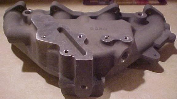

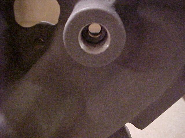

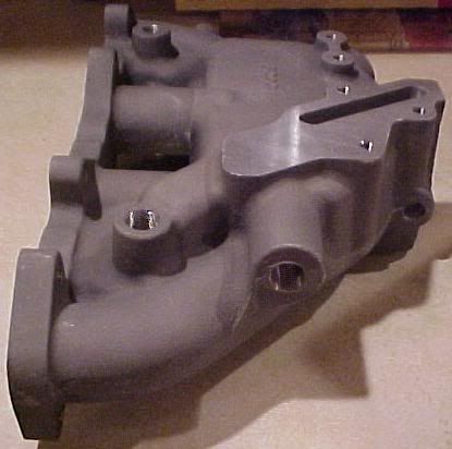

Posts: 946
Location: Meshoppen, PA
Hope this helps Shawunltd, I took a whole bunch of pictures from all angles and of all the holes in the manifold. There were more than I thought! They all must be there for a reason and I suppose if they weren't needed then you could always plug them up.

PostPosted: Wed Nov 14, 2007 12:04 am
PITA Old Fart
Posts: 2286
Ok I'm typing this with one hand, so please excuse the mess.
The hole on the bottom with the bolt holes on either side and the long indented groove is for the egr to bolt on to. It can be tapped and plugged for those that aren't using their smog stuff. The other two bolt holes are for linkage and there also is a threaded hole for the coolant temperature sensor.
The "t" shaped pipe fitting is for coolant lines to connect to. The other fittings you need for the vacuum booster to your brakes, and the other vacuum fittings you will need have to be used from your old stock POS Isuzu manifold. It's all pretty basic stuff. Once you remove your old manifold, just put the two beside each other and swap everything over.
BTW...Once you put the two manifolds side by side, you will notice the difference in the quality of the casting/machine work immediately. The stock POS Isuzu is a cheap, machine made and mass-produced piece of junk. The Offy is expertly engineered and designed, plus it's individually hand-cast and hand-machined from a higher grade metal.
Some would say that paying for a new manifold when you already have one is kind of silly...but IMHO it all boils down to how well you want your truck to run. With the price of gas being what it is and the anticipated increases I'm sure we will all be facing in the near future, every little bit of improved operating efficiency you can squeeze out of your old truck has to be viewed as a wise investment.
I personally had the opportunity to drive my old Luv that was completely stock with all of the smog stuff intact right after I did all of the mods that were possible to my old G180 engine in my shortbed stepside truck - and there was no comparison in hp/torque at all. Plus my truck got way better mileage - which immediately convinced the new owner of my old truck to get to work modding his.
With every mod you do - you pick up a few more hp, a little more torque, a little better gas mileage - and it all adds up.
And on that happy note, I'm going to get off of my soapbox, STFU, quit boring you guys, and go refill my Jack-n-Ginger...lol
