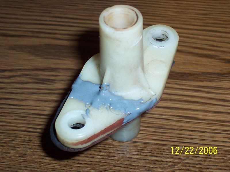

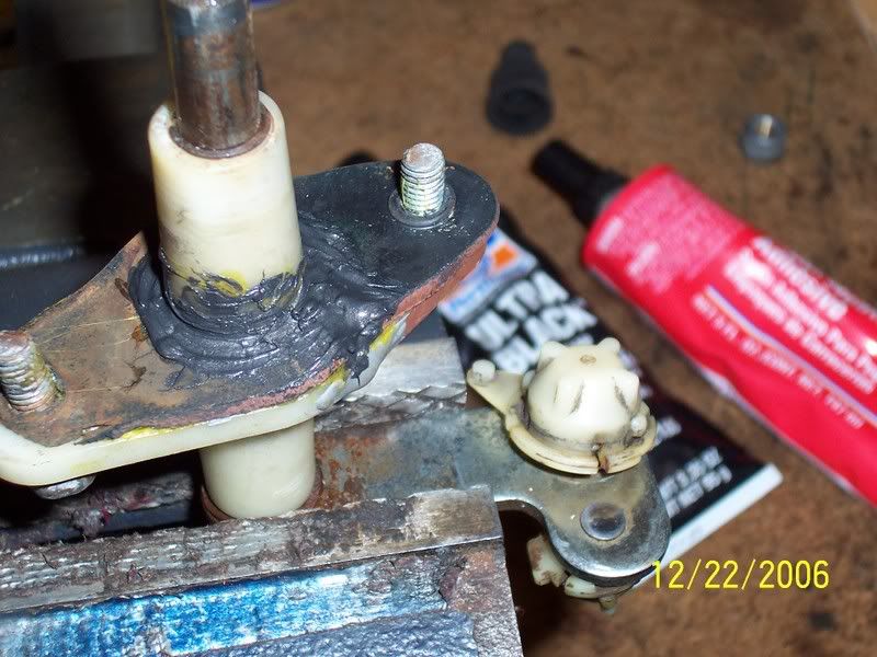

I glued the wiper pivot shaft bracket together with JBWeld. After it was cleaned up and greased, it fit together easily. I replaced the snap ring, and used weatherstripping glue to hold the old gasket in place, then added Ultra Black Permatex® to fill the gap. I'm going to let it set for a day, and put it back in the LUV with more Ultra Black. This time I'll add grease to the rubber boot, replace the wiper arm, and then put the heater unit back in with Ultra Black around the heater core tube grommets. At least I cleaned the heater up, and it should look better when I take an interior photo!!! The wipers should be a lot quieter, as well as not leak.
I'm waiting for the engine parts and tools... :microwave:
Image Image

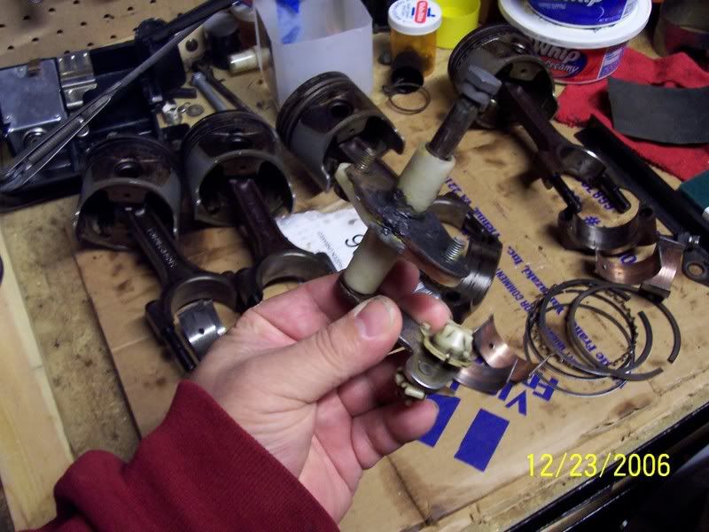

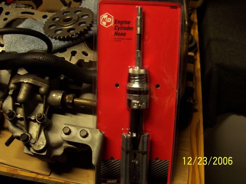

Today I hope to get in there and put this repaired wiper spindle back in. I got the cylinder hone, only now I've decided to use the flex hone, which is on it's way...
Image Image

PostPosted: Sat Dec 23, 2006 1:05 pm
Posts: 426
Location: Auburn, WA
Hey FullaLuv:
Your plastic repair job looks good. My dad swears by JB Weld but for plastics used in cars I really like the POR 15 Epoxy.

Hey! I got the new rod bearings delivered today. They're made in Australia!!!
Eric, I have a box of the POR-15 epoxy. I got it with the POR-15 floorpan kit that I used last October. I tried to find a photo of the epoxy, but there is illustrated the way I miss so many photo ops and why I'm clicking the shutter so much this time around. I might think I overdo it sometimes, and some have said so, but in the end the pictures are great to look at, and share. I looked at your repaired antennae, and I thought you did an excellent job. For the wiper spindle bracket, I think JBWeld was the better adhesive. I bet Nascar_44 $2 it'll last at least a year, so I'm expectin' to have that to spend next Christmas!! The POR-15 is more solid and thus was the right choice for your repair. Is your antennae still up?

The JBWeld didn't hold it when I tried to mount it. Aw shucks, I ain't gonna cry; just tell me where to send it, or collect it when ya get here. I already have the air fresheners!! :smt119
The JBWeld was pretty, and Eric I wish I'd added the POR-15 on the top of it, but oh well, I put it on when the JBWeld flaked off. I put a whole walnut-sized gob of it on. I was going to photograph it, but put it in already! I can photograph it anytime just by pulling out the ashtray. It went in, but I don't know yet if it's a success until I run the wipers, and that won't be until I rebuild the engine, so wait. If it doesn't hold I'll get one From BlackLuv or the guy Eric pointed me to.

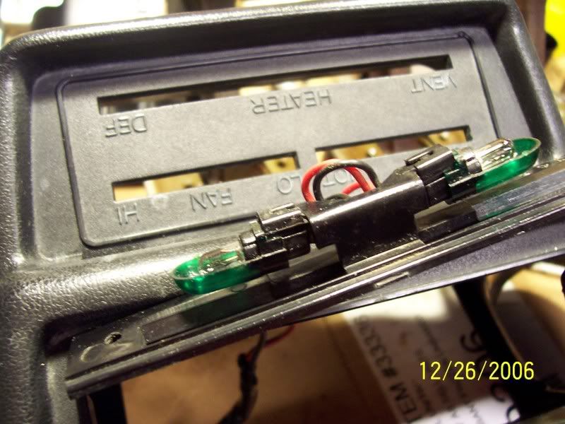

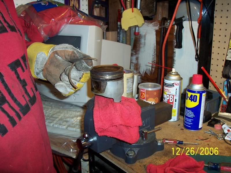

We had a nice Christmas and I hope everyone else did too. Today I put the heater back in, and that was not easy. I don't fit in the space between the seat and the door opening at the floor level. I got it done though. I got the dingle berry hone today. I cleaned the grooves on the pistons with a half-ring, and used a nylon pad to clean the surfaces. I'm still waiting for the rings and main bearings.

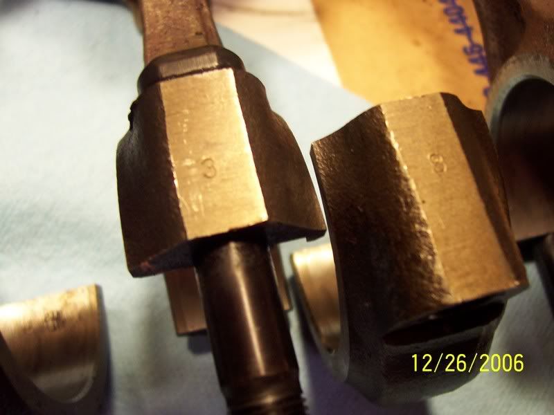

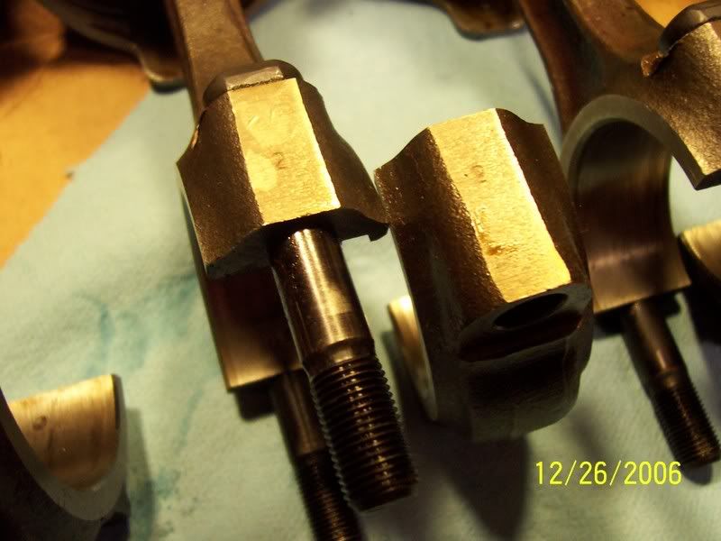

PostPosted: Tue Dec 26, 2006 9:22 pm
Posts: 2013
Please tell me that you marked the pistons and rod caps so they'll go back together in the same spots?
PostPosted: Tue Dec 26, 2006 9:24 pm
Posts: 1075
Location: Covington, WA
Was I supposed to do that?
'78 1.8L 4-speed Fleetside
Image Image
PostPosted: Tue Dec 26, 2006 9:43 pm
Posts: 1075
Already was done on the passenger side...
Image Image
Image #4 will be fine... :D
