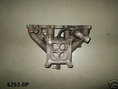

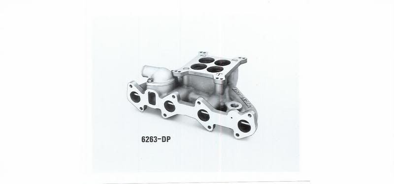

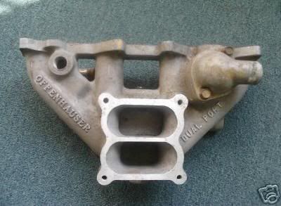

For reference here are pics of the other Offenhauser manifolds for the LUV. Thanks goes out to SoYank for providing the pics for us. I am not sure on the last one, is it the 6059-DP? If so I will redo the pic and add the number to the photo. If I have any of these pics labeled wrong please let me know so I can correct it.
Image Image
Image Image

Oh yeah, anyone know what the model # is on that last photo? I believe it is the dual-plane model. Is it the 6059-DP? If we can confirm this I will add that number to the picture for identification purposes.
