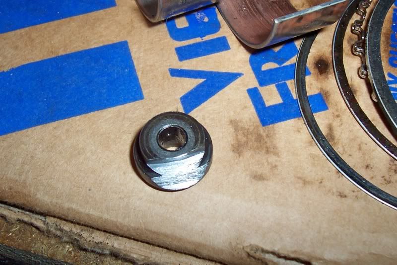

I also got a closer look at that damaged bolt head near the timing chain. I had known there was something having to do with oil flowing through there, but I was sort of holding my breath till I had to look at it. When I finally took it off and studied it, I learned there are two tiny passages for oil jets that spray the timing chain on each side of the crankshaft sprocket. The bolt is just small enough to allow oil flow into the fitting which has these oil jets (or holes) placed at an "8 o'clock" and "5 o'clock" position. I realize this part would have been ruined if I had continued running the engine much more. It was only 1/16th of an inch away from cutting into the "5 o'clock" hole. If you click and enlarge these photos, you should be able to see the holes clearly. This part installs one way and doesn't turn. Page 5 of this thread has another look at this part before it was removed.

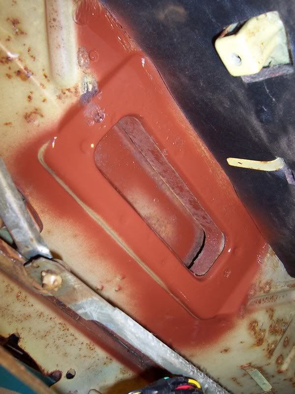

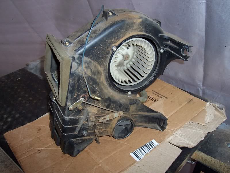

I worked on the heater unit today. I removed it from the cab, and took photos along the way. I found the foam rubber cushion between the air inlet and the opening was wet and the opening badly rusted. I scraped it, wire brushed it, and sprayed primer on it. The book didn't say, but I had to take off the air inlet before I could get the unit removed from under the dash. You can see from the photo of the entire unit that the leak is coming from above the heater core, so I will be focusing on sealing the air inlet. I'm thinking about letting the foam dry out, then applying a large bead of silicone sealant when I replace the air inlet. I also thought about replacing the foam with a different cushion. Maybe I could use some door weatherstripping!!
After studying the photos, I am beginning to wonder though. It looks like the leak might be just off the air inlet; see how the rust starts away from the cushion in the last photo? Notice the black mark on the left of the rusty opening. I better give it another hands-on look and scrape it away to see if there's a leak through the metal.

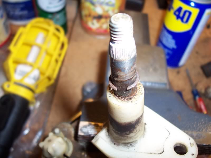

I looked some more at the heater and the leak trail. The rust marks seem to indicate there was a leak...at the wiper arm shaft. I know this topic has been covered here before, and I also put the boots from some ignition wires on my shafts back when I painted the cowl black. I skipped the grease though. I stand corrected, and I better take it apart and redo it; this time with some heavy grease like 800xl told in January of 2003.
http://forums.luvtruck.com/viewtopic.ph ... per+shafts
I know it wasn't the coolant from the engine, so I don't have to examine the heater unit any further. I'm just going to put it back in. Tomorrow.

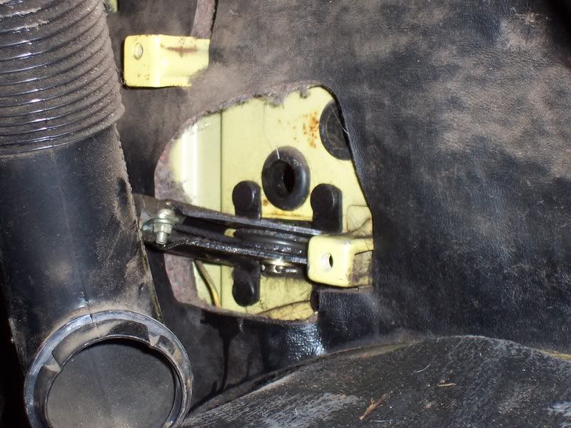

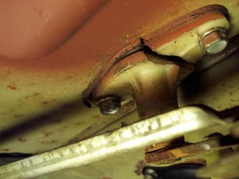

I didn't put the heater unit back in today because as I was cleaning up the area, I noticed the wiper pivot bolt bracket is broken all the way across. From the angle I was working in yesterday I couldn't see the crack, and so when I found it I decided to take it apart and fix it. I'm going to super glue it, and then coat it with JBWeld. If you have this part and want to let me know, I might replace it. It doesn't need to be completely disassembled; if only as far as the third photo, it would be fine. I'm still going to try the repair.
Image Image
The first two photos were taken through the ashtray area. LUV owners might look through there to check their bracket too.
Image Image
It was difficult to remove the white plastic bracket from the bolt. Notice the snap ring in the fourth photo.
