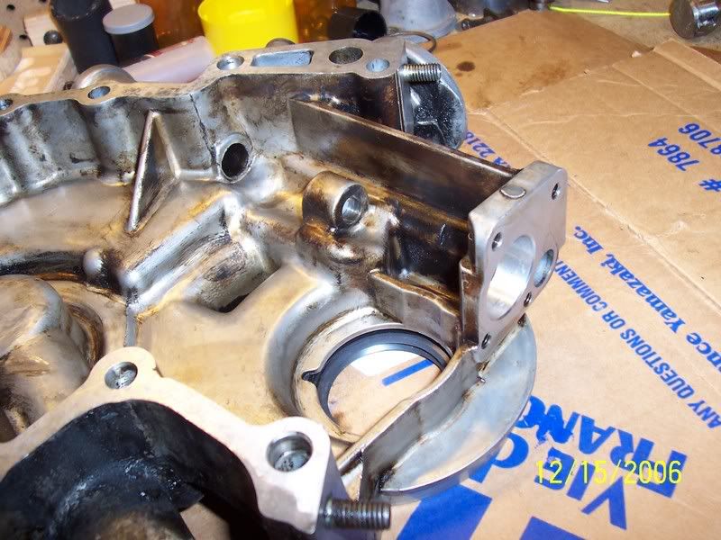

I worked several hours today cleaning the grime off the front cover. I also installed the crankshaft oil seal into the cover. In these two photos you can see the result of scraping, spraying, rubbing, brushing, and sanding. If you look closely at the inside of the cover you may spot another gouge mark where the chain ran rampant.
I'm quitting for the day.

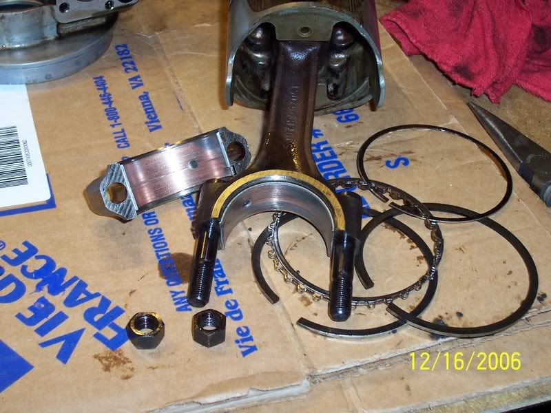

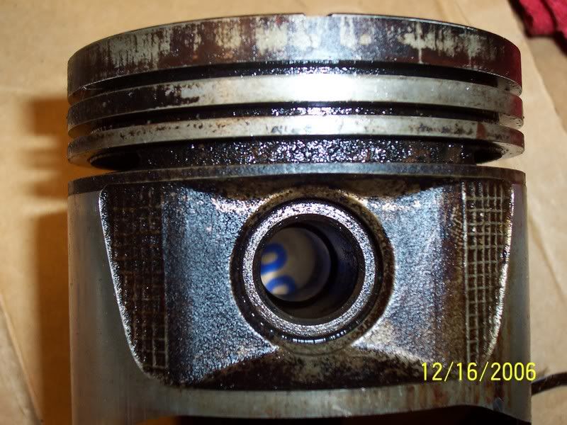

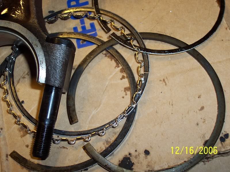

I had a great time having Eric Q over today, and among other things we pulled a piston out from the #3 cylinder. I removed the cap, and when I just pushed up on the connecting rod, Eric took the piston and lifted it right out. Here is the piston.
Image Image
I noticed the oil control rings seemed to be pretty tight and flush against the piston, while the compression rings were loose and springy. I wonder if replacing the rings will look the same, or if the oil control rings should also have at least some springiness. I need some expert opinions and advice.

PostPosted: Sat Dec 16, 2006 8:11 pm
Blue Meanie wrote:
You're feeling relaxed about it and you're not going to get in a hurry.
That's the smartest gameplan that anyone can take. Taking time to figure out stuff like the tensioner mechanism will give you a deep understanding on how it all will work as a unit. And you were reading thru the manual. Man, you're making all kinds of brownie points today! These pics are great! This alone is valuable to the uninitiated.
I'm so proud... I think i feel a tear welling up in my left eye.
I was just catching up on this thread and this quote is exactly what I was thinking. Good job FullaLuv. On my 80 (My first LUV truck rebuild) I took the eng. all apart to figure it out too. Then I took it to a shop to have him rebuild it. This second time (on my 78), I just pulled the eng. out and took it to him complete.
I applaud you on your ambition and guts to dig in there to the unknown.
Oh. And from what I know, I think the rings should all be about the same in springiness. On mine, some were pretty gummed up and stuck in the groove also.
PostPosted: Sat Dec 16, 2006 8:34 pm
Posts: 2013

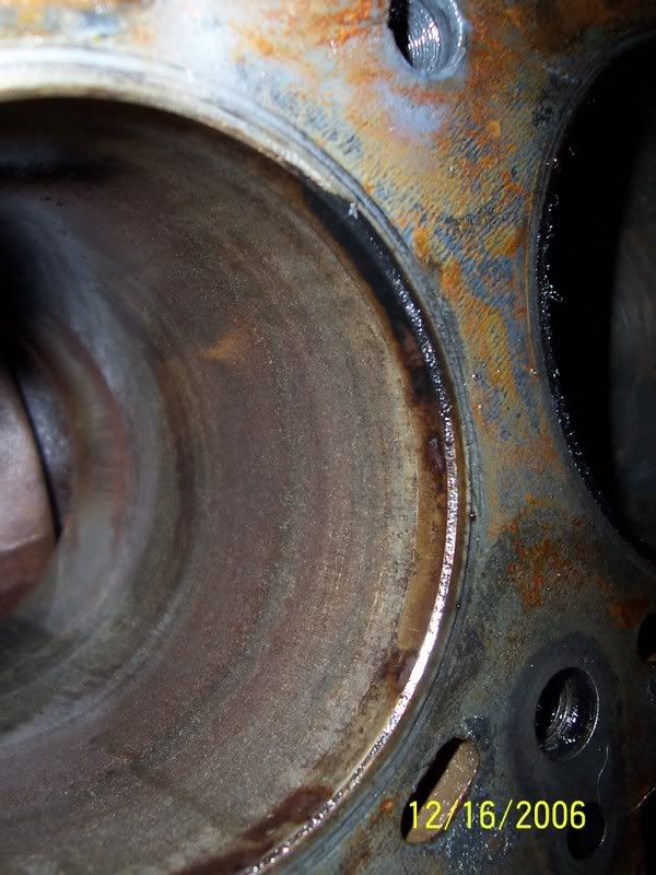

In this pic, im concerned that the wear on the oil wiper ring isn't consistent. The top arrow shows an indication that the ring gap rode deep in the groove. The bottom arrow shows were consistent wear starts and is even around the rest of the ring.
Can you see any vertical marking in the cylinder?

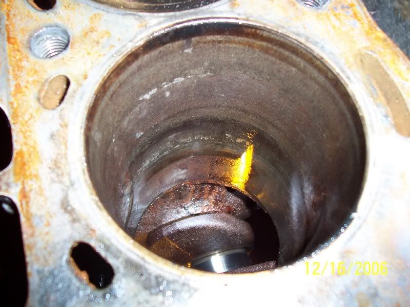

Here's a couple of pictures that were taken just now of the #3 cylinder. I don't see any vertical lines. I haven't removed the other pistons yet. I'm not too sure about the uneven wear. Tell me if you want any more photos.
I saw the oil control rings and the expander were very tight in the groove. I think this could already be an indication of oil bypass, but remember I didn't leave a cloud everywhere or anywhere. I just don't know if I should do the rings or not. The rod bearings are worn though, huh? They're a standard size. I haven't cleaned the rings yet to check for a specification.

I noticed the black mark on the second photo seems to indicate a leaking valve stem seal, huh? Maybe I should check through the spring on the #3 exhaust valve and see if it rode up on the stem...

PostPosted: Sun Dec 17, 2006 12:04 am
Piston rings are cheap, I would get a set. If you hone the bores and rering along with the head you just had done you should be in great shape. I like the way you read up on the task before diving in, I think you should have no problem with the reassemble.
PostPosted: Sun Dec 17, 2006 12:13 am
Posts: 2013
That rod cap looks like it's seen better days. You'll be checking the others when you work all the rings. I'd pull a main cap or 2 to check those bearings. If they look worn, I'd pull the motor and get it all reworked.
Like you said, you're not gonna be in a hurry about it.

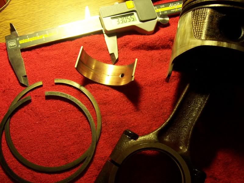

Ok, I checked the compression rings and bottom half of the #3 rod bearing. The rings have an "N" and a "T" The rod bearing has "STD". Now I'm not as experienced as some of you, but I think I can go ahead with standard-sized rod bearings. I'm actually going to hold on until I've looked at all of them. I thought I was ready to order, but when it comes time to make a choice, I don't have the decision made. For the rings, I have no answer to what the letters mean.
Anybody know?

I'm not finished taking out all the pistons. I plan to do so today. I figure on doing a measurement of the ring gap in each cylinder just to give me a general idea of where I'm at. My pistons are marked D, C, D, C in that order. My Series 8 manual lists them as Standard sizes, but they are 0.010mm in difference. Would that make it so I couldn't order a full set of rings, but instead might need to order 2 of each size? That's going to be more expensive since a set is generally a bargain.
This is a very important issue to me, really. You know the clearances are critical to an engine's performance.
Here's a measurement. I checked the #3 piston, and I get 3.3055", and the manual says the "D" piston should be 3.3061-3.3065". Do any of you think this is too loose?

PostPosted: Mon Dec 18, 2006 12:59 pm
Posts: 2013
0.010mm is tiny (0.0004 of an inch). That's way smaller than a human hair. As long as each piston fits each individual bore correctly, it will be fine.
Dont fall prey to over thinking the project. There should be a measurement for piston to cylinder clearance. Using a feeler gage will give you a piston to cylinder tolerance. This needs to be done before and after you hone the cylinder. If the tolerance is too great before you hone, you'll need to oversize with new pistons and boring. If it's within tolerance before you hone, measure after you hone to make sure it's still within tolerance.
Most machine shops will want the new pistons before they bore any cylinders. This way they can fit the bore to each piston to get correct tolerances. Any differences between the cylinders is so slight that it will not be noticable.
When you remove the other pistons, take note of the ring markings. What marked ring is in each ring groove and does the marking face up or down in the groove. Draw pictures if you have to. I did on alot of stuff i've worked on. MS Paint is great for stuff like that. This will be for reference only. When you get a new set of rings, the manufacture will have directions and markings that they will specify what rings fit where and how.
Im really glad to see that you're taking a serious approach and you want this to be correct but try not to over think this. Micro-engineering the project will fry your mind and keep you awake at night.

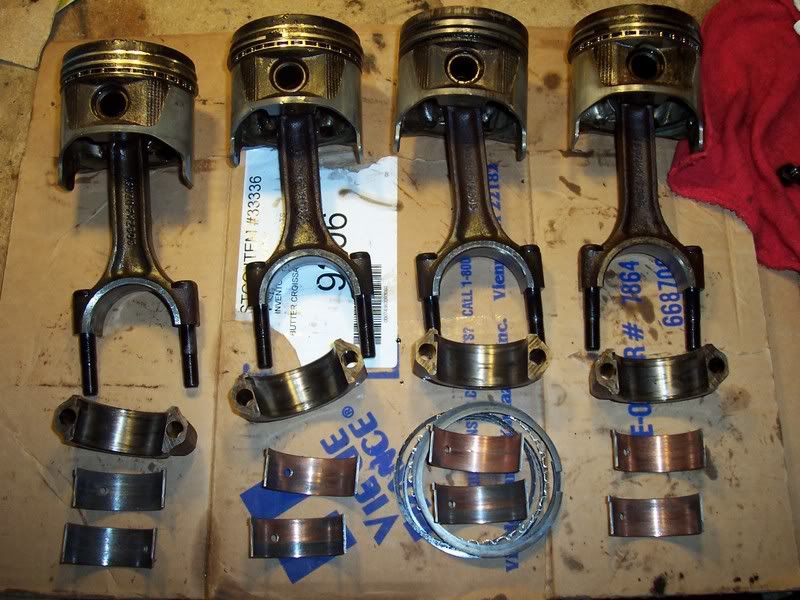

PostPosted: Mon Dec 18, 2006 1:43 pm
Posts: 1075
Location: Covington, WA
I'd like to joke about staying awake at night, but the truth is I've been sleeping like a baby.
I took all the pistons out. Here's a couple pics for ya. I'm using the first one for my desktop wallpaper today.
Image Image
'78 1.8L 4-speed Fleetside
Image Image
