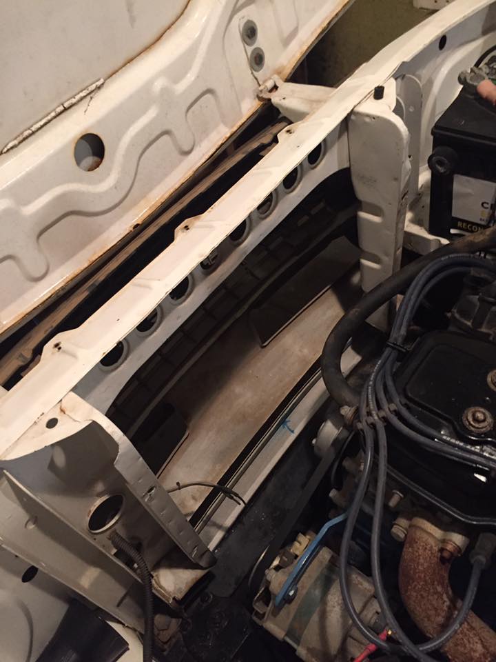

I ended up getting this, it was just expensive:
Griffin Aluminum Drag Race Radiators 2-26135-X from summit. I cut some aluminum brackets and used rubber grommets to attach it.
I didn't realize it at first but I think the reason I didn't have to cut anything myself was because the previous owner cut the area on the bottom of the opening:
