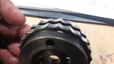

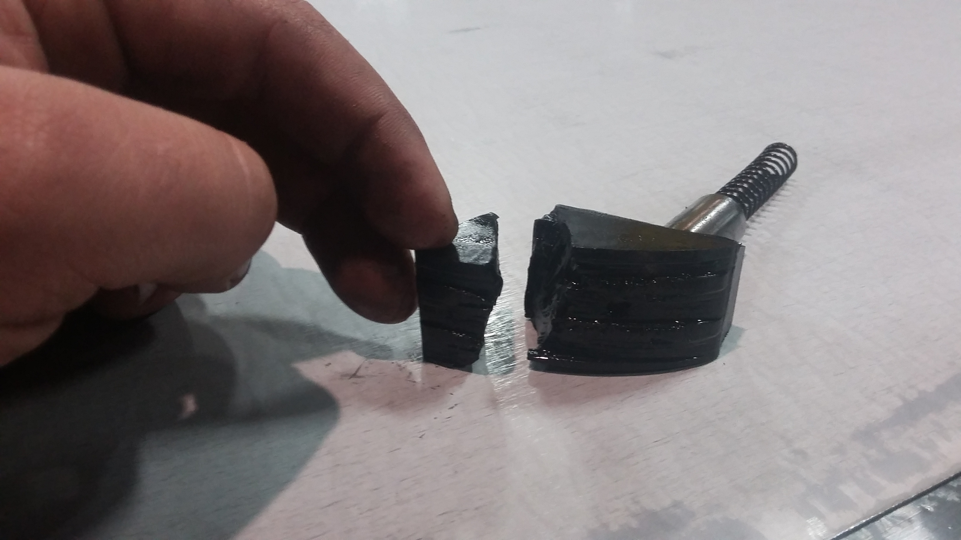

Why did it happen? The timing chain got too loose from wear and climbed up over the sprocket teeth breaking them off.
 Post subject: Re: Wont start.
PostPosted: Wed Jan 06, 2016 8:32 pm
Posts: 326
Location: Lodi CA
Look at the bottom one.

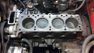

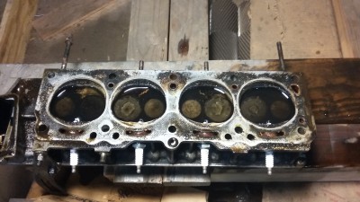

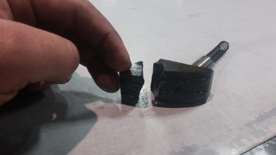

Well this morning we took the head off to see is there was any damage and thankfully everything is ok. I did have a small leak on my head gasket so I'm going to replace that. I think what happen is that the timing chain tensioner broke some how and this caused the chain to eat up the teeth.

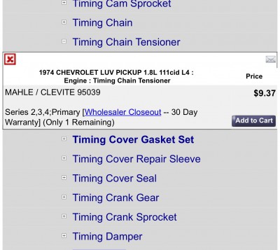

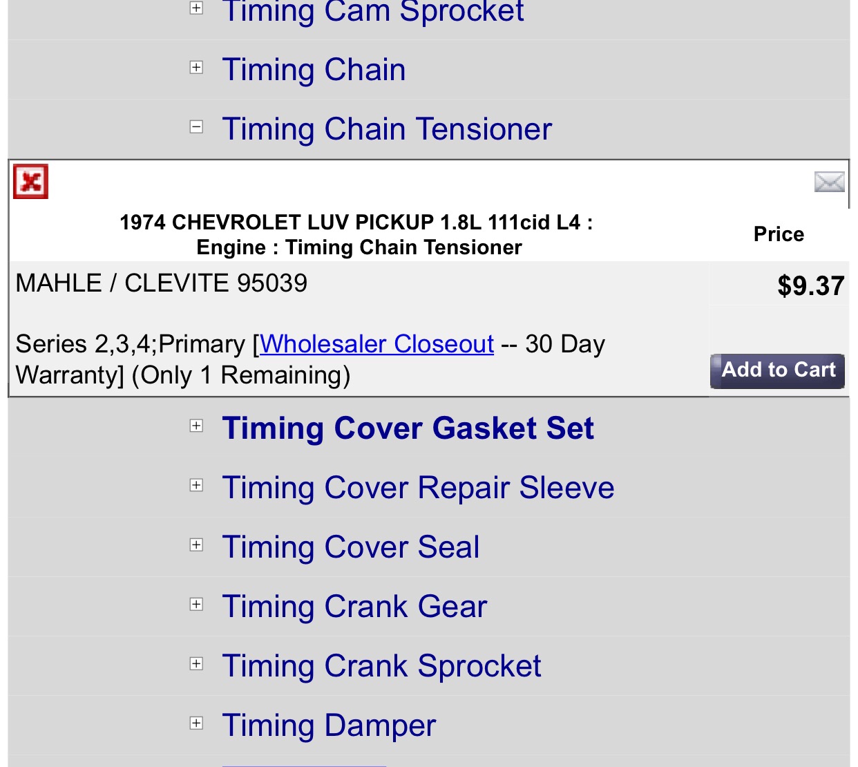

Might anyone have a clue to where I might find the parts I need. Rockauto.com has a few of them but they are out of the timing chain tensioner. Is there a "kit" for the timing chain?
PostPosted: Thu Jan 07, 2016 7:40 pm
Rock auto has them listed for less than $10. It says they have one left.
PostPosted: Thu Jan 07, 2016 7:41 pm

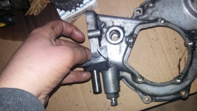

Ok so I got the cover off, I did have to remove the oil pan. So my parts came in but the tensioner is correct but I need a different one also. The upper one I guess I can call it. Or does anyone know the real name of it.
File comment: It goes right here
