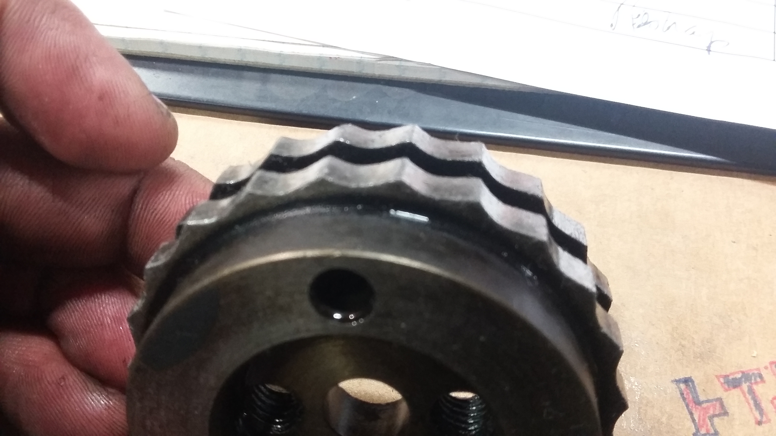

Why did it happen? The timing chain got too loose from wear and climbed up over the sprocket teeth breaking them off.

Look at the bottom one.

My first 74 wore out all of the sprockets. I replaced them and kept driving it.

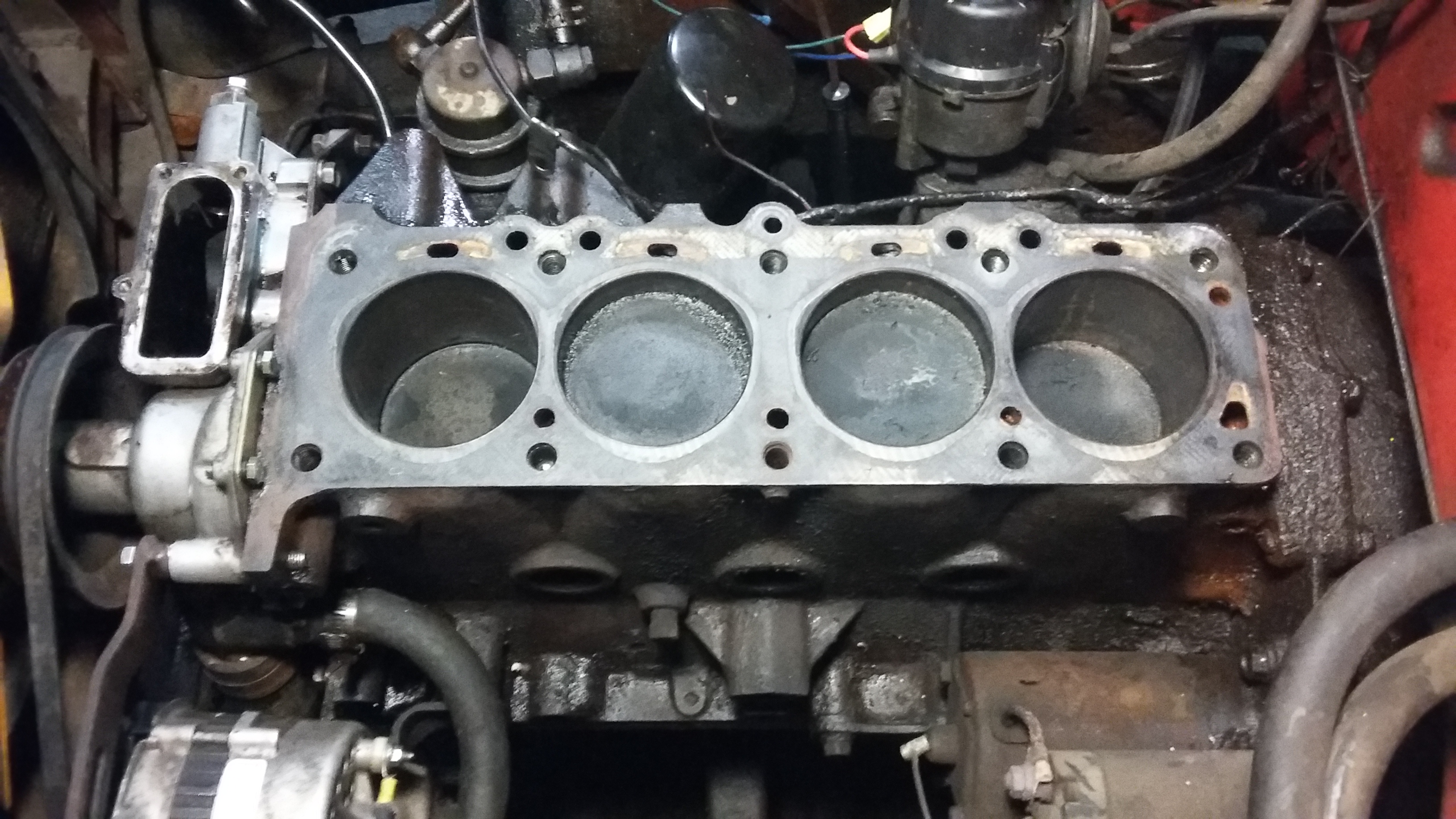

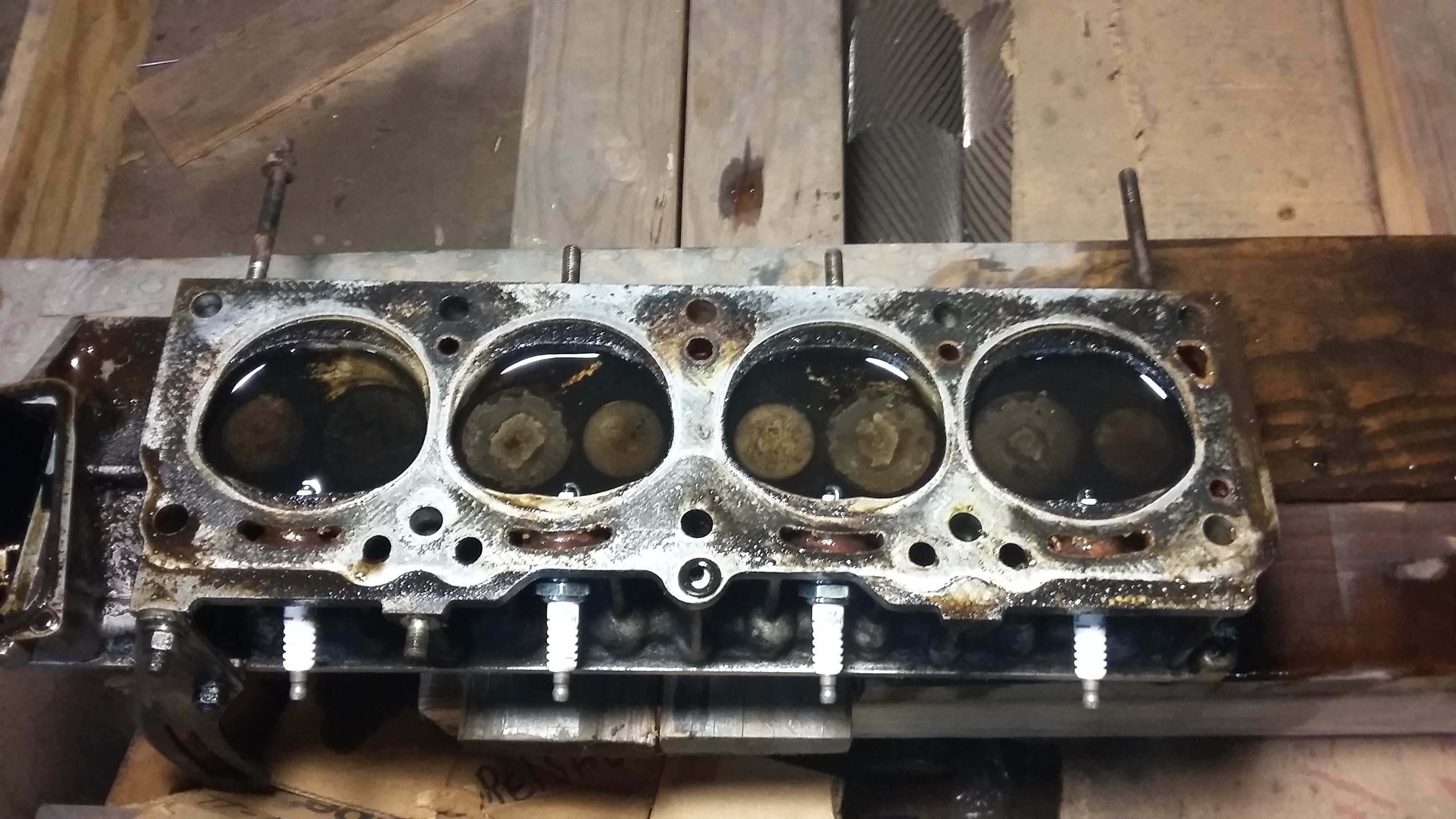

Do you think I should take the head off and check out how it looks underneath? Or just replace the gears?
 Post subject: Re: Wont start.
PostPosted: Thu Jan 07, 2016 10:19 am
Posts: 326
Location: Lodi CA

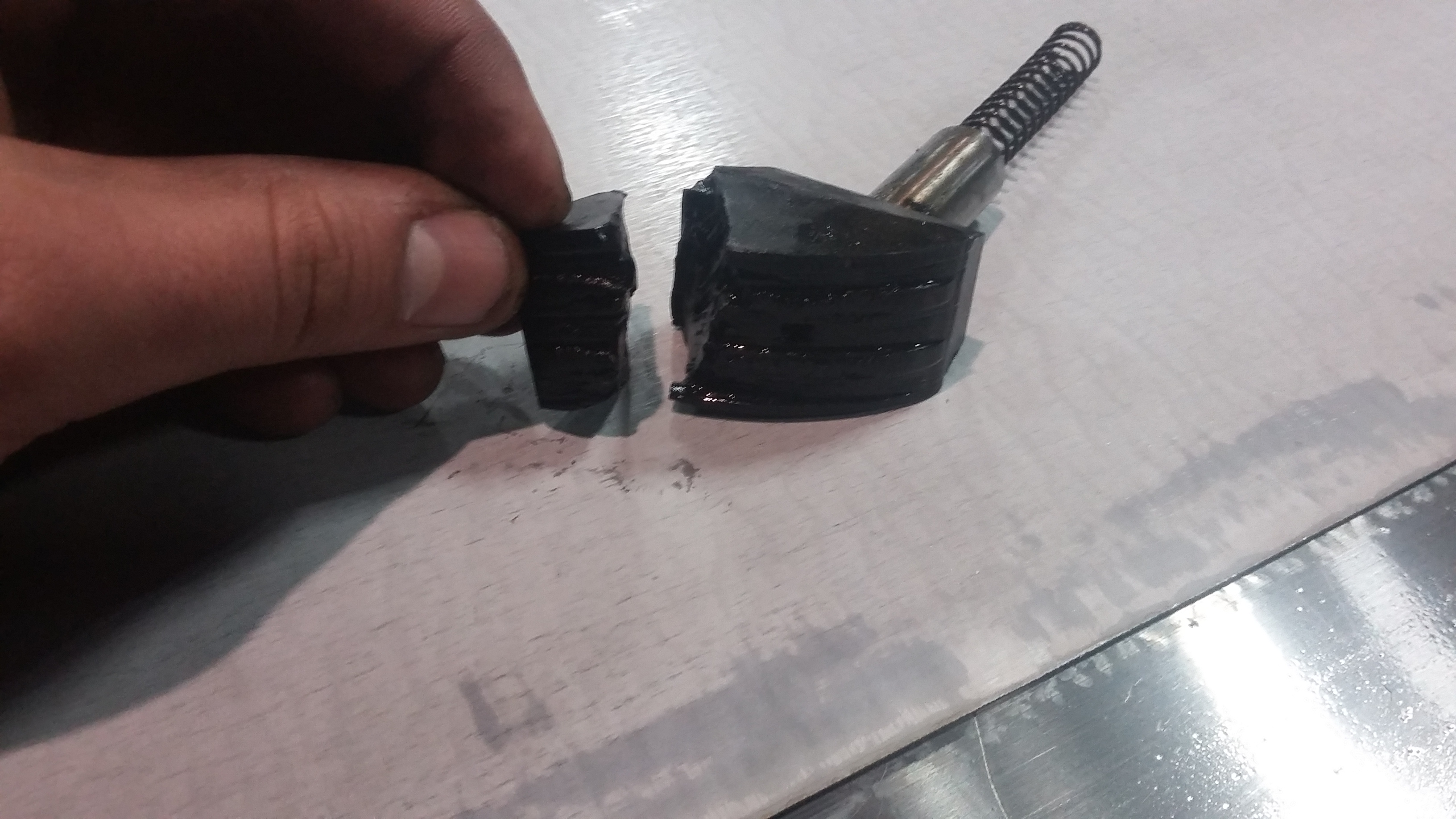

Well this morning we took the head off to see is there was any damage and thankfully everything is ok. I did have a small leak on my head gasket so I'm going to replace that. I think what happen is that the timing chain tensioner broke some how and this caused the chain to eat up the teeth.

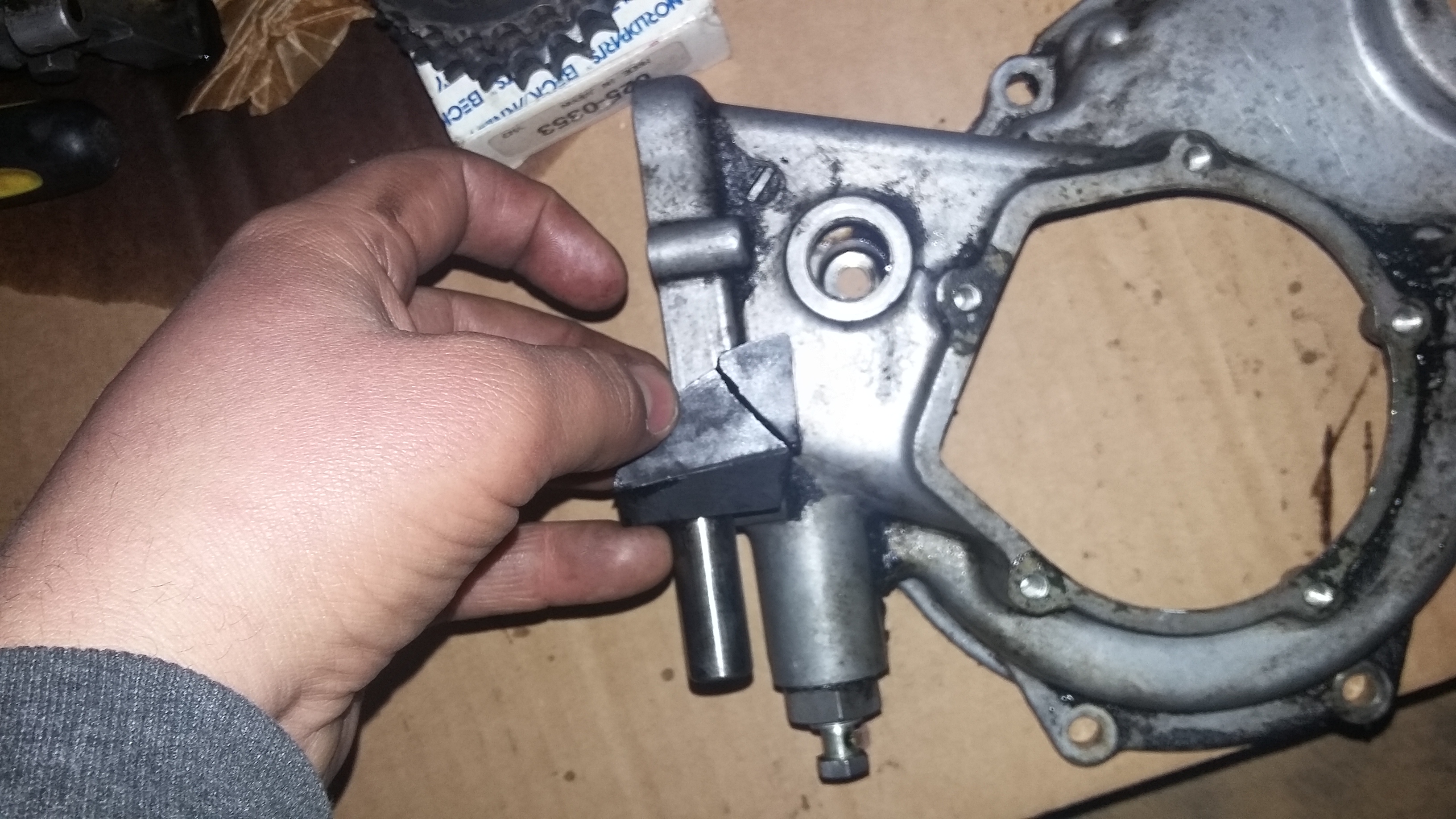

Ok so I got the cover off, I did have to remove the oil pan. So my parts came in but the tensioner is correct but I need a different one also. The upper one I guess I can call it. Or does anyone know the real name of it.
File comment: It goes right here

Found it cloyes #9-5020
