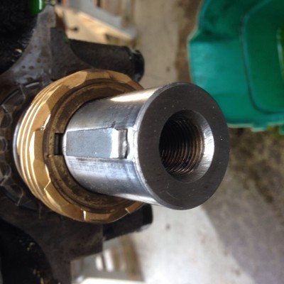

Trying to fix my screwed up timing chain and pulled the front cover. Looking for the timing mark (slit) on the crankshaft. Is this it?

It's the only slit I could find, but it that's it then it's up top at 0degrees when the timing Mark should be on the bottom...
P.s. I have a manual but the picture sucks a**

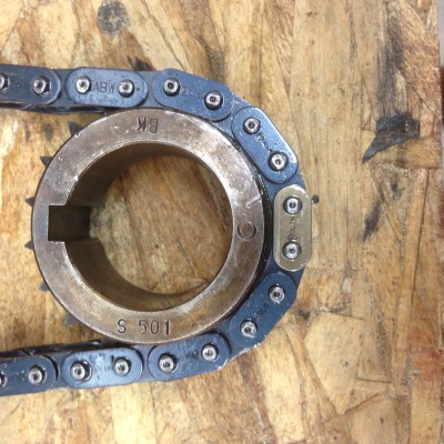

Ok I think I got it but damn the manual is confusing as heck. I think the mark in the crank shaft timing sprocket is how it needs to be. See pic.. Is this correct? Mark plate on chain lined up with circle Mark on sprocket...

Manual says slit but all I see is a circle marks.. Ugh....

Waiting on confirmation that that is the right timing Mark. Don't want to have to take this bitch apart again..

Looks correct. I never went by any slit, dot, or timing link. Basicly put the key way straight up and the pully should point to 0 degrees ignition timing. Then look behind the top timing chain sprocket and should line up with a "slit" or "v" at the top. If not, turn the crankshaft one more revolution to line it up on top correctly. At this point the distributor rotor should point to #4. If not, just change the spark plug wires in the cap instead of redoing everything. 1-3-4-2 counter clockwise.
