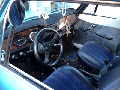

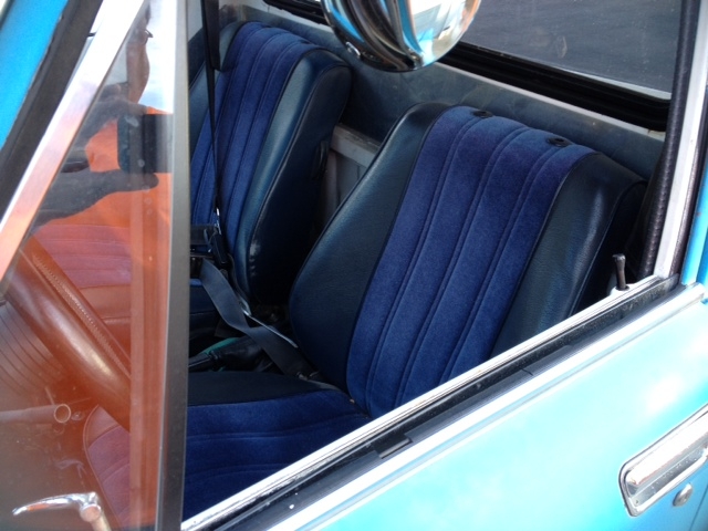

I think my seats were about as easy to swap in as any I have seen. They were I believe BMW 318I or E30 seats. The 2 outside rails lined up with the factory holes in the floor so I only had to drill the 2 inside bolts for each seat. I didn't care for the head rests so I left them off. They matched pretty good also but I am thinking they had been recovered at some point.

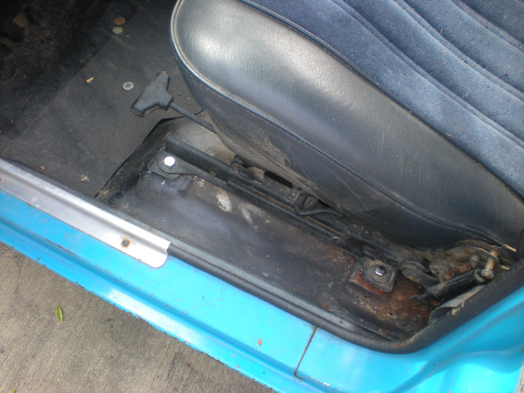

There was a gap from the seat rail to the floor on the front 2 inside mounts. I used 2 old larger size 1/2 inch drive sockets as spacers. They were the perfect height for the rails. The rear is flat with the floor.
I don't have a pic of the inside but here is the outside mount. Before I re-did the floor too...

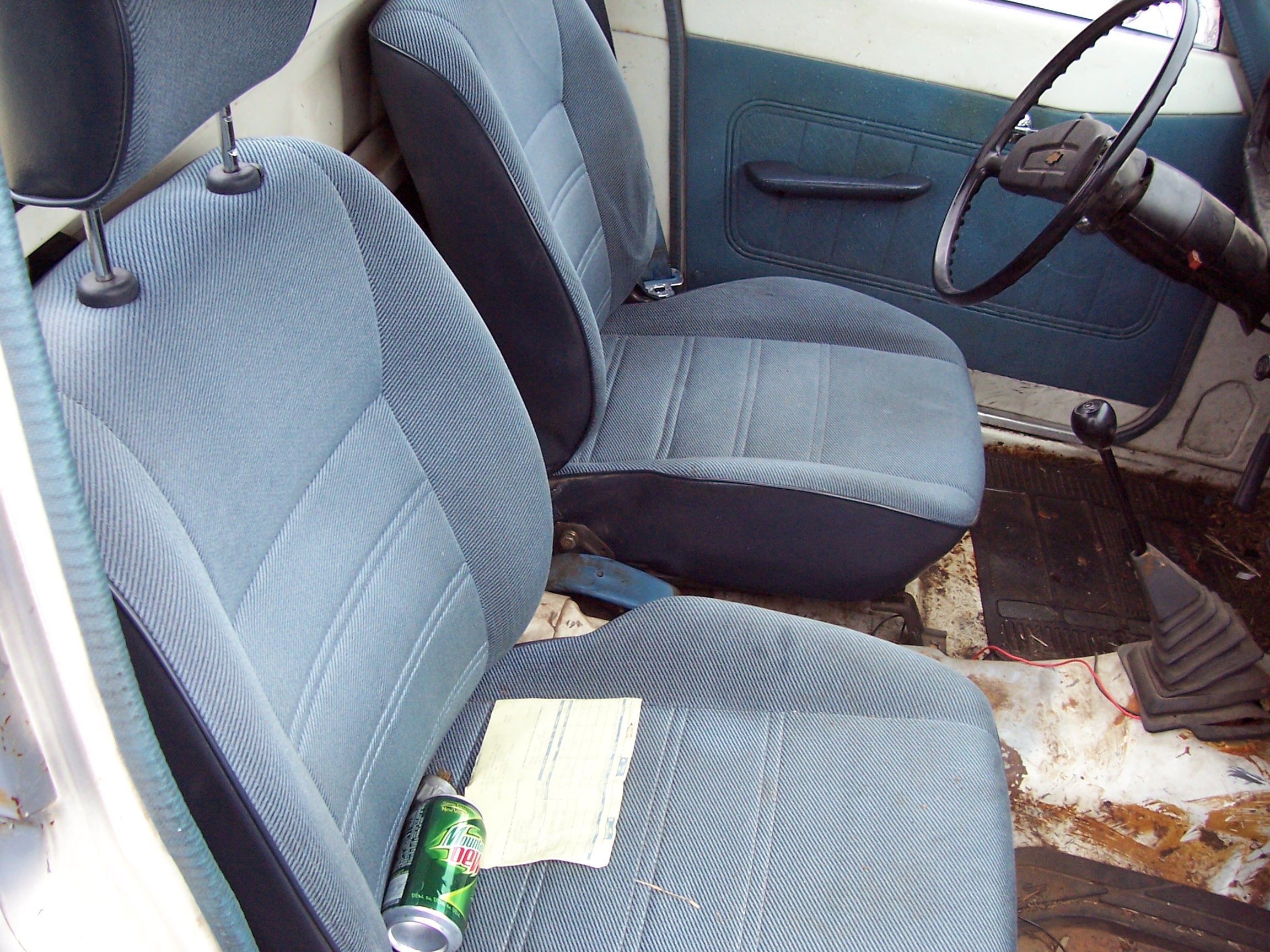

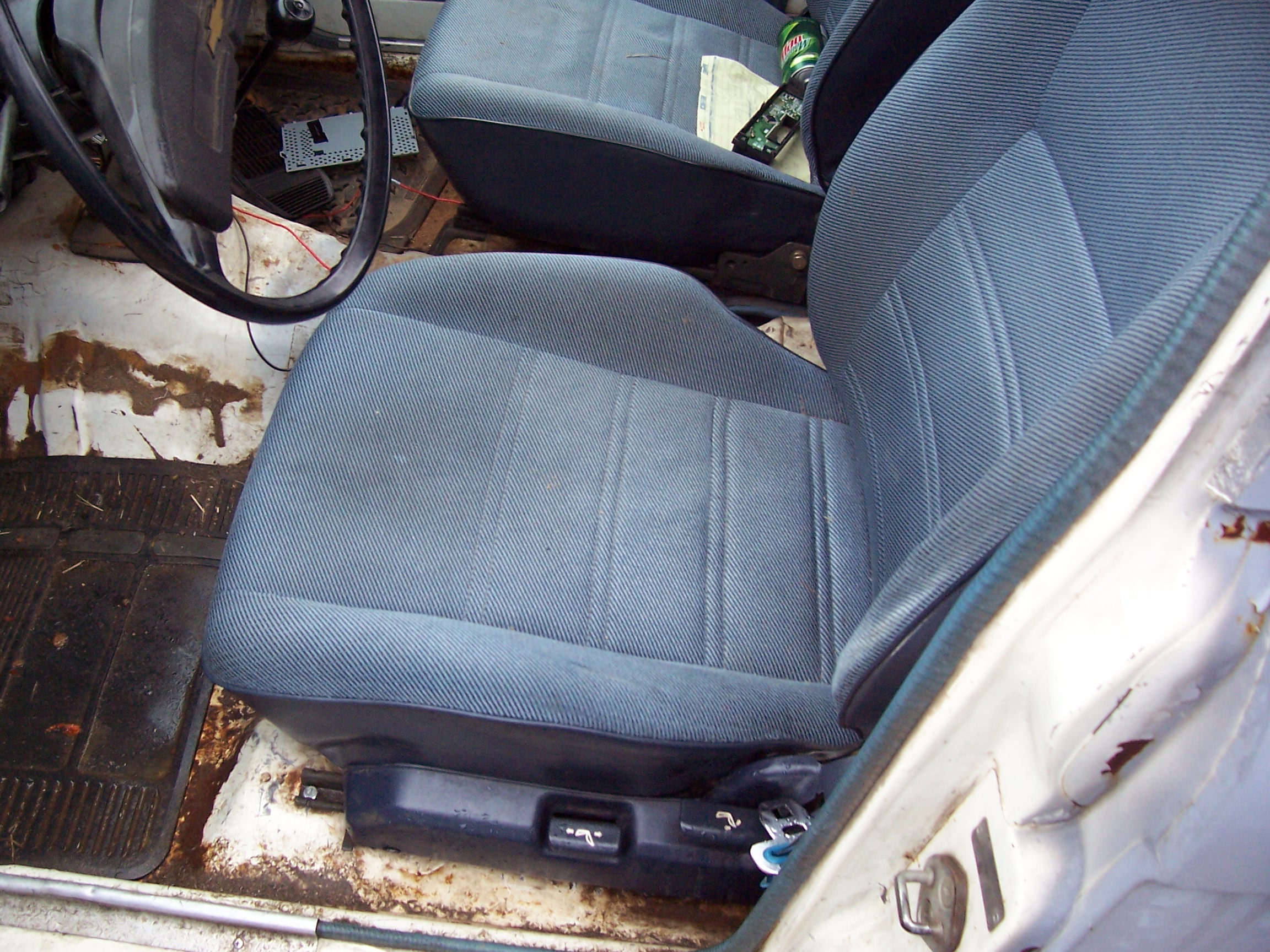

I went searching the local pick and pull some years ago looking for buckets for my LUV, and found some that work quite well, but might be hard to find. They came out of a 1988 Hyundai Excel sedan, which is not an easy car to find, but those early Korean cars were so terrible that they did not run long enough for the seats to wear out!

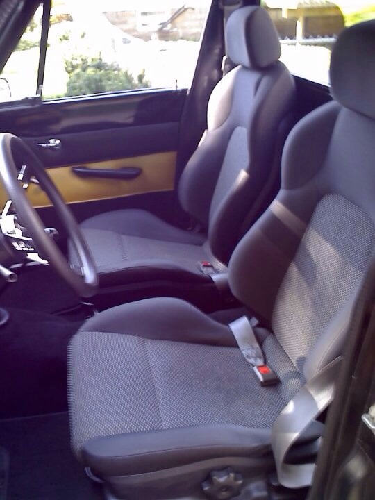

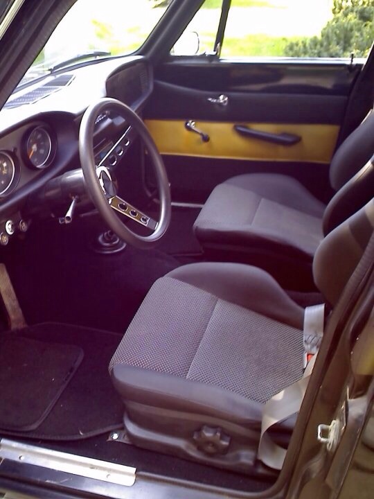

Hyundai Tiburon seats. Had to make spacers for the two front inside bolts.
