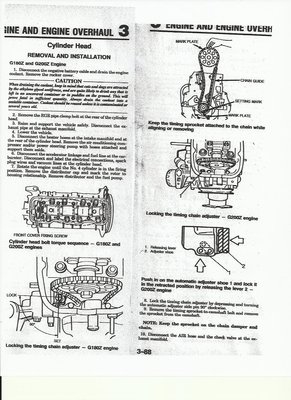

how do you lock the tentoner away from the chain? this was non stated in any artical i read about replacing the head gasket

This info would be in any manual, even a Haynes/Chilton's. I suggest you purchase one, the Factory Service Manual is preferred.
Click on the image to enlarge & clarify.
File comment: chain tensioner

thanks!!! we got it on though it still was a hassle. the tentioner hit the head of the screw so it would not unlatch all the way but its back on!
