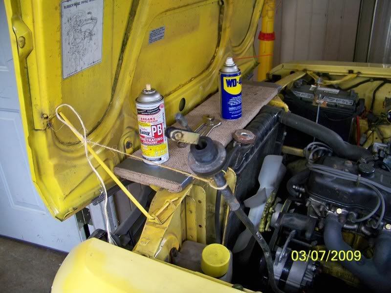

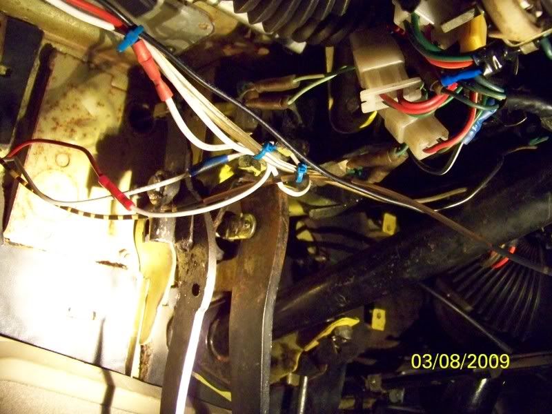

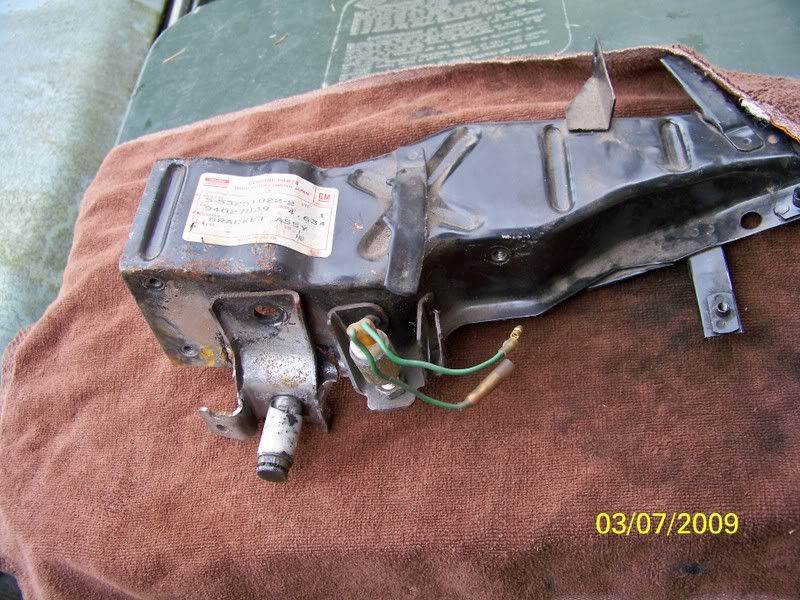

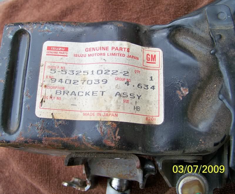

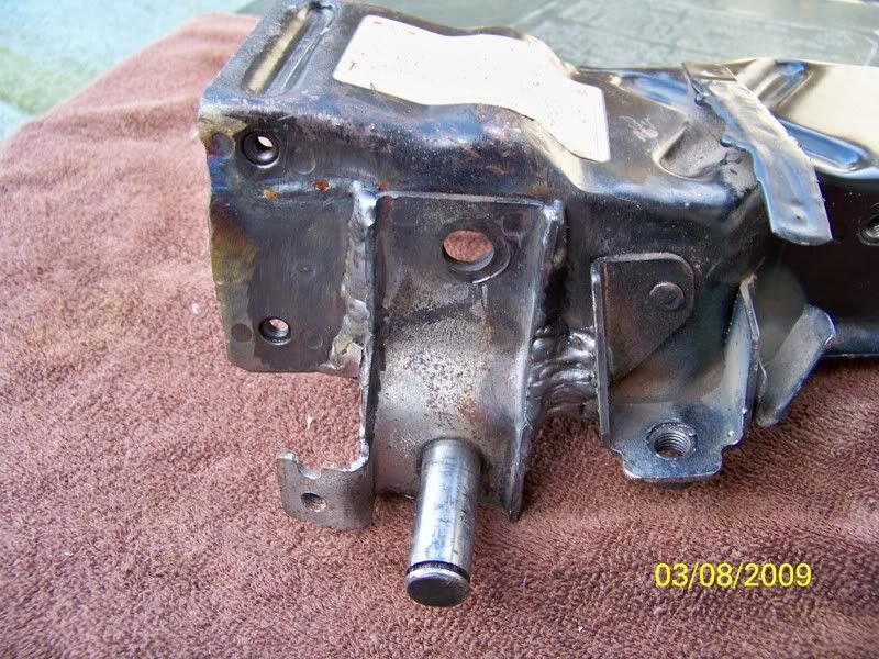

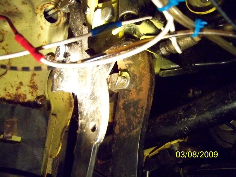

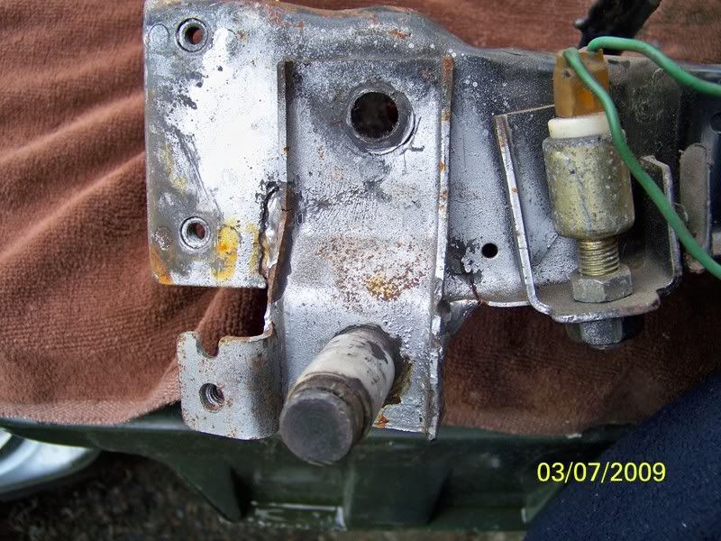

Clutch has been giving me some concern...had to tighten the cable a few times, but when I noticed the pedal starting to lean left, I got down to look under the dash and found the mount starting to bend. Ah, my turn to do the bracket rebuild. I thought I never would need to do this, as there was already a big shiny weld on it when I got this LUV and I figured I'd been taken care of. Not the truth, cracks along the welds actually weren't visible until I finally wrestled it out.
It took an hour, maybe a little more, and it wasn't easy. I removed the clutch pedal, and the brake pedal. I tied up the clutch cable to the hood support so I could spray penetrant and lubricant and have it work down the cable while I was working under the dash. I took the instrument panel out which makes access possible by allowing the wiring harness to be lifted out of the way enough for removal of the bracket. After removing eight bolts on the bracket, it was time to start wrestling the thing out and I finally succeeded. The Izusu part #5-53251022-2 is clearly labeled; I haven't checked yet whether is still available or not. I'm going to weld it up and put it in again; that's another post!!!
A new cable is $24.99 at AutoZone, (Part #CA-415). I'm going to go ahead and try the same cable for awhile.

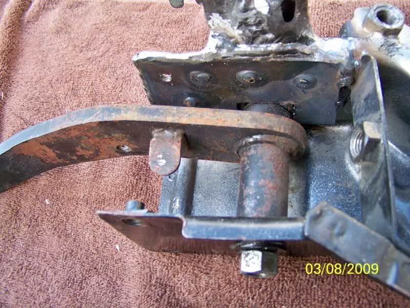

Posts: 1075
Location: Covington, WA
Fan blades backwards?? Oh I hadn't noticed!!!! My engine has never overheated since the last rebuild, and the oil pressure hasn't diminished either.
I finished the bracket repair, and photos are on the way. I can't believe the difference in the clutch!!! It's so smooth it's almost hard to tell the difference between the free play and the clutch pressure.

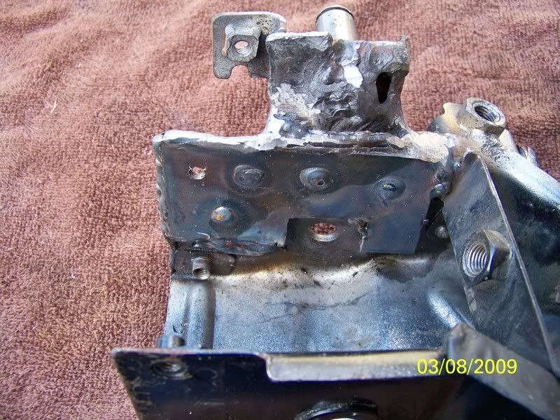

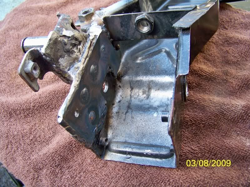

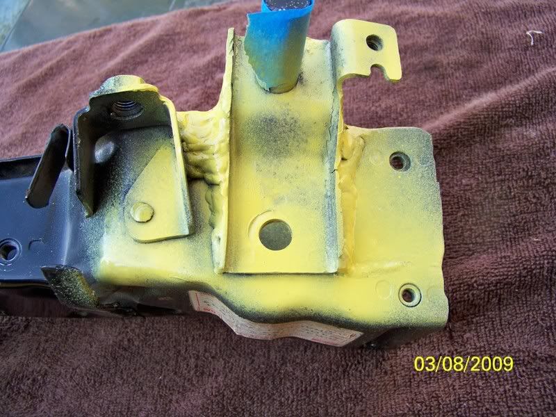

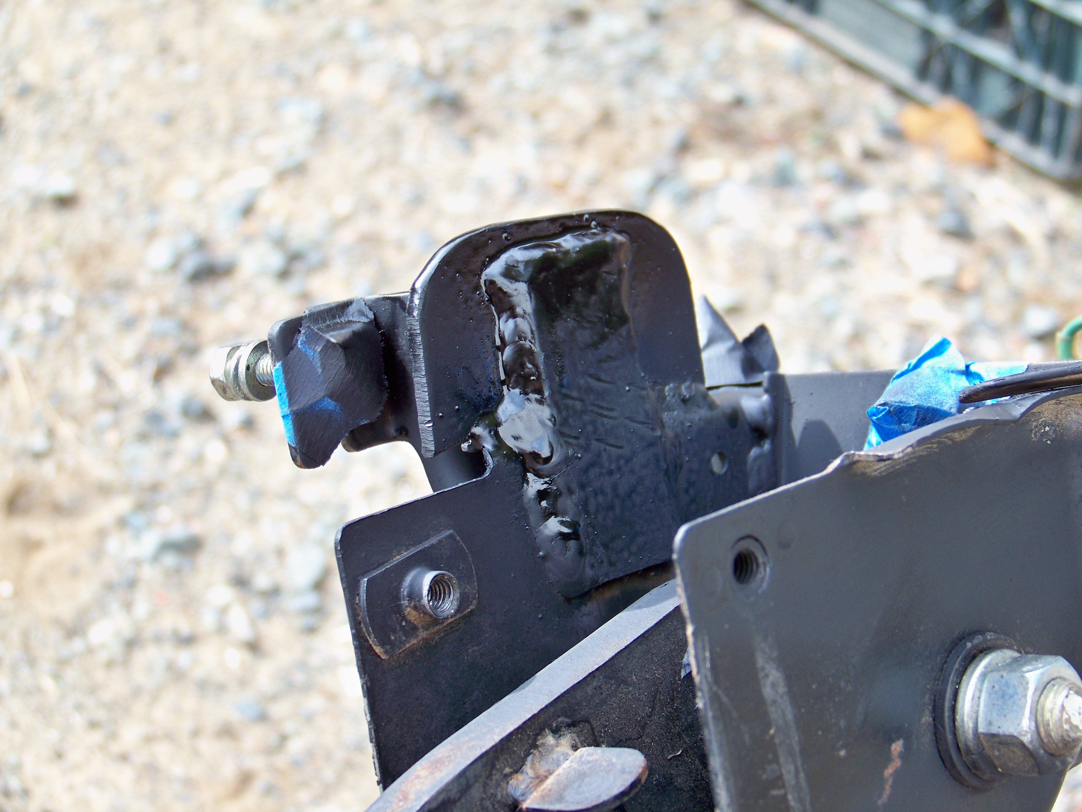

Here's the finished repair. I added a plate three times thicker than the original sheet metal. Clutch is solid as a rock now. I only got 19 photos on this thread. Hope most of you out there enjoy them.

Being as fullaluv's reinforcement looks a bit excessive, here's how I fixed mine, same problem:
