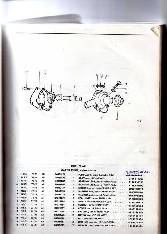

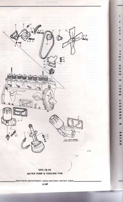

These Pics Might Help.

Does the heater work ok, blows warm air? If the pump is bad it won't pump water through the heater either. The pump is removed by removing the the bolts but only loosening the one behind the timing cover and sliding it out from behind that bolt. The post above picture shows how the thermostat goes.
