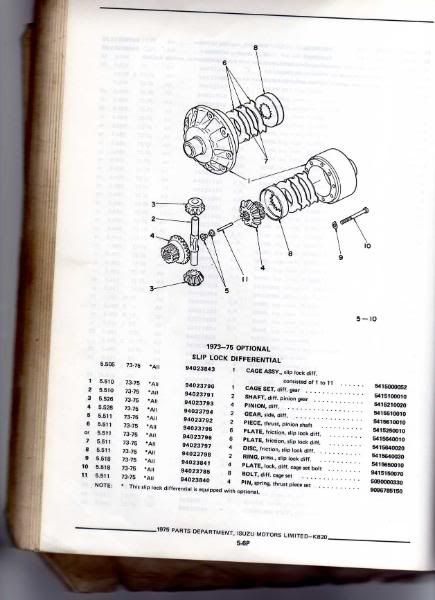

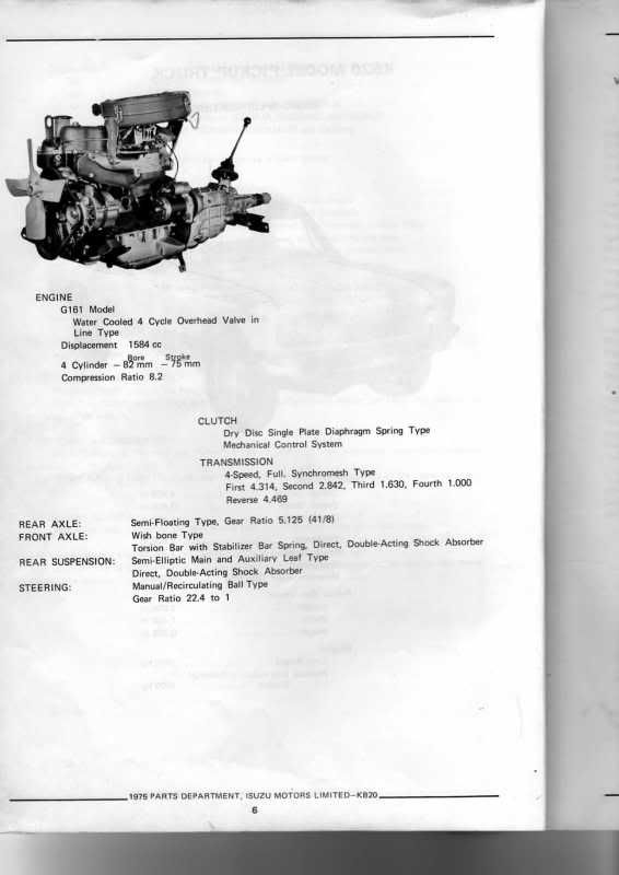

PostPosted: Fri Oct 31, 2008 7:02 pm
Australian LUV Guru
Posts: 782
Location: Australia
Here in Australia the only ratio option's were 5.125:1 4.555:1 and 4.11s there was also a LSD option
5.125s were found in the early LUV's 72-75
4.11s were found in gas LUV,s 76-80 (non 4wd)
4.555 were found in gas & diesel 4x4 LUV,s
I have parted out many Luvs, Pups and Troopers. I hav'nt been lucky enough to get a 4.11 centre chunk yet, 4.555 seems to be the most common ratio. There wasn't a auto trans option available in Aus either.
