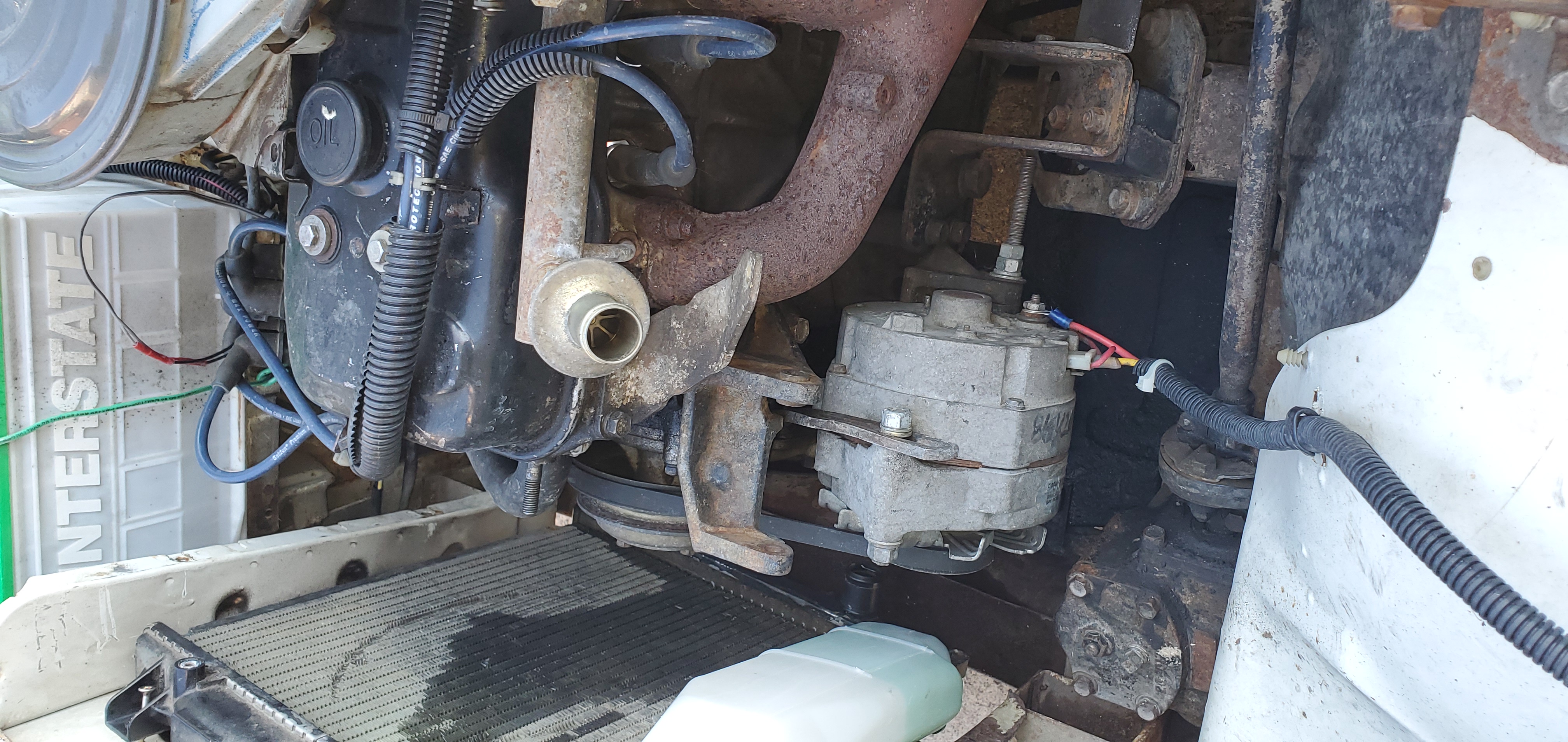

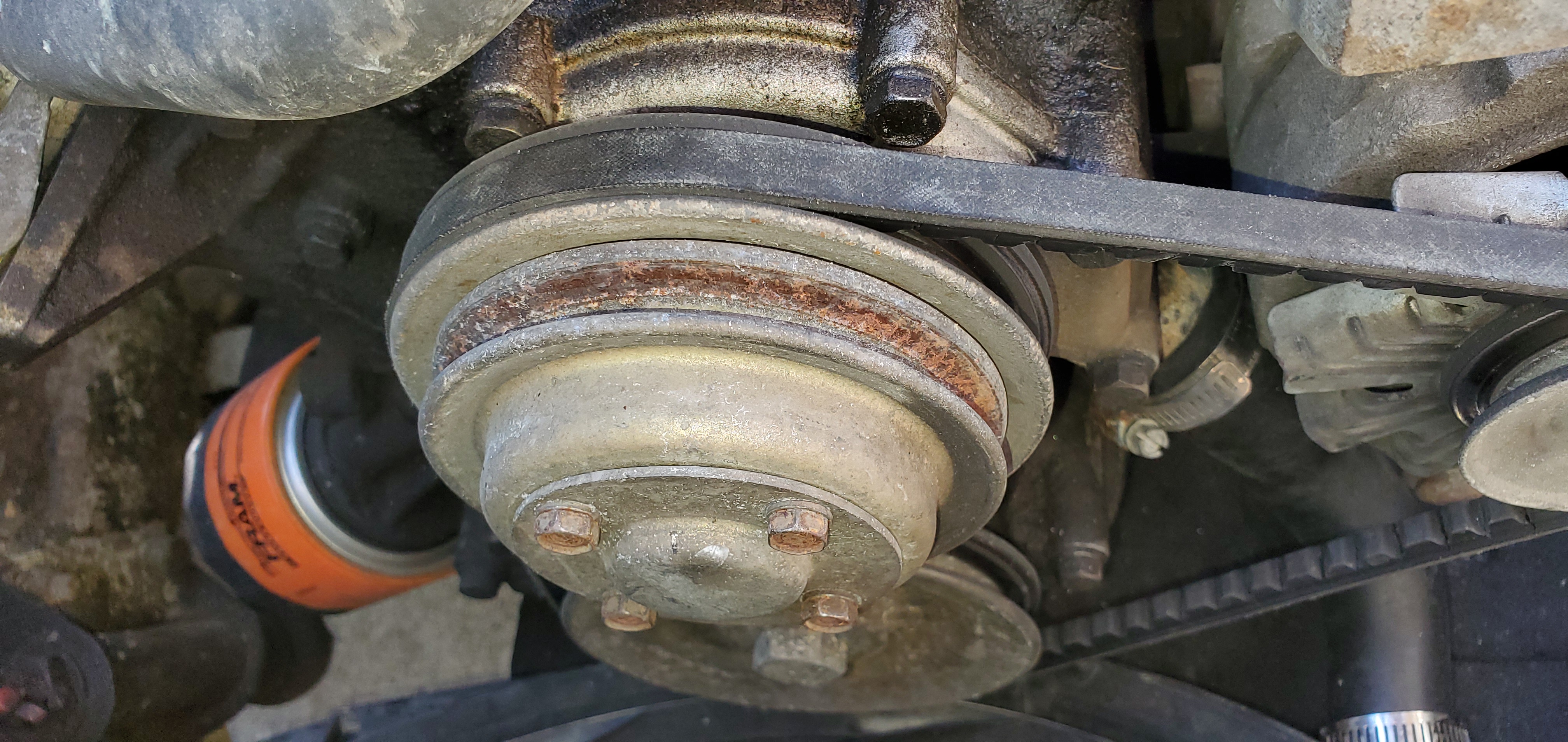

What's the outer pulley/missing belt for? I got the truck without these parts

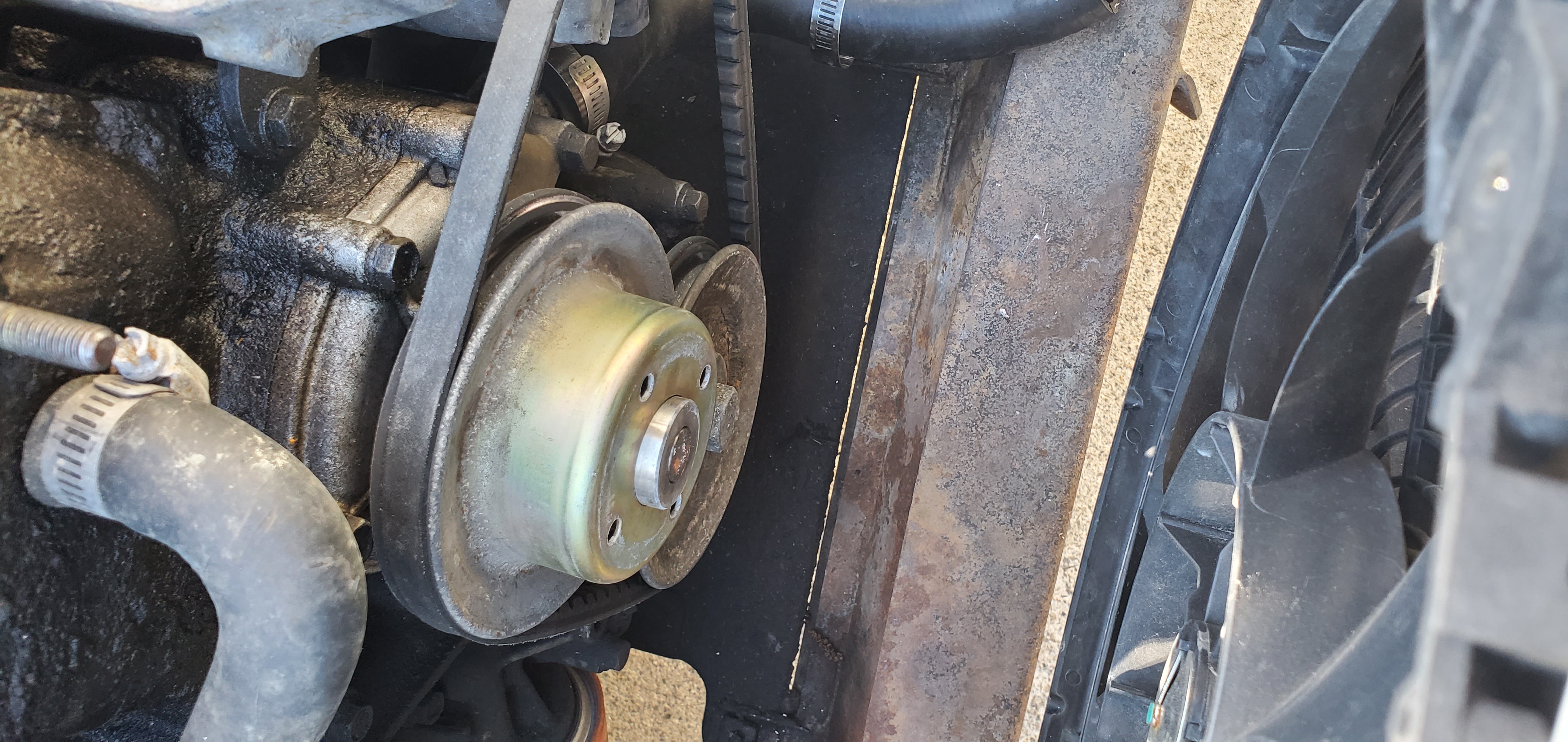

trying to post picture attachment and suddenly failing at it.
File comment: As you can see, I got the 2nd pulley off, but even putting on an after market single setup, that shaft is still poking out. I know small blocks came with short and long shaft water pumps. But don't know anything about this isuzu setup
PostPosted: Sun Sep 06, 2020 5:44 pm
I'm trying to remember, I think a spacer is used in place of the pulley. I doubt there two different water pumps for these trucks. I know what you mean on the SBC though.

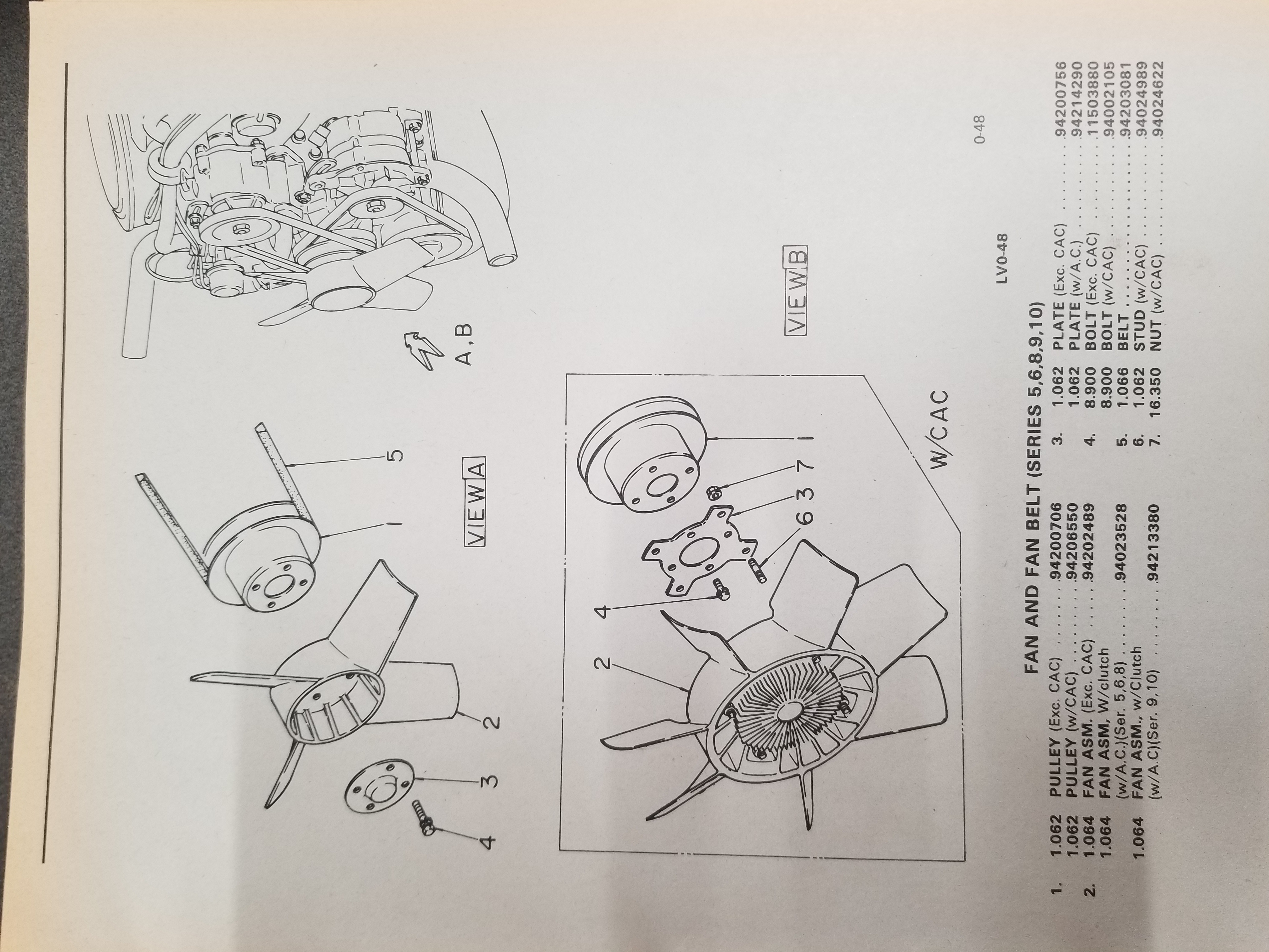

Not sure if it is any help, but this is from the factory parts book.

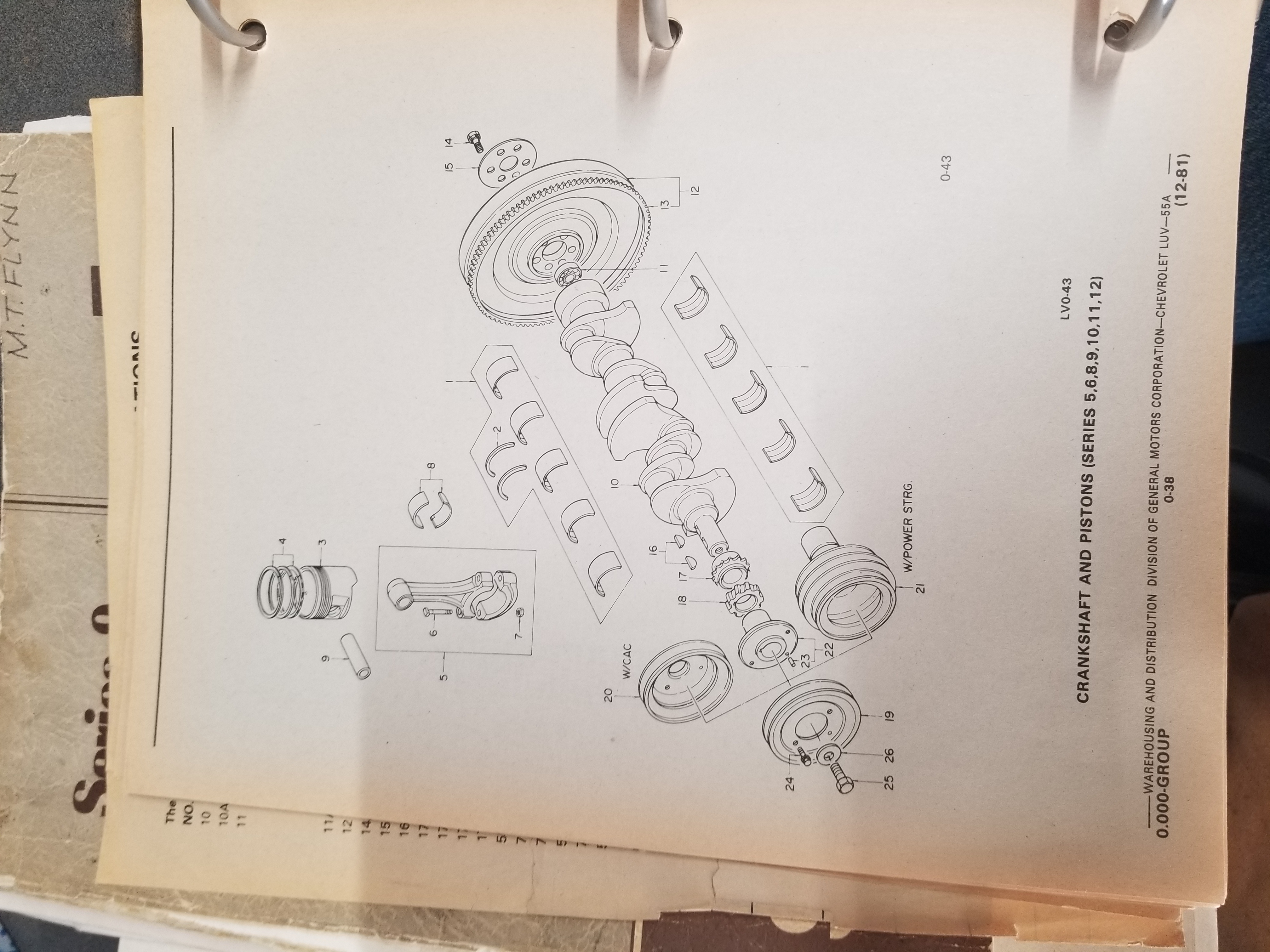

PostPosted: Mon Sep 07, 2020 12:54 pm
Crank pullies.
