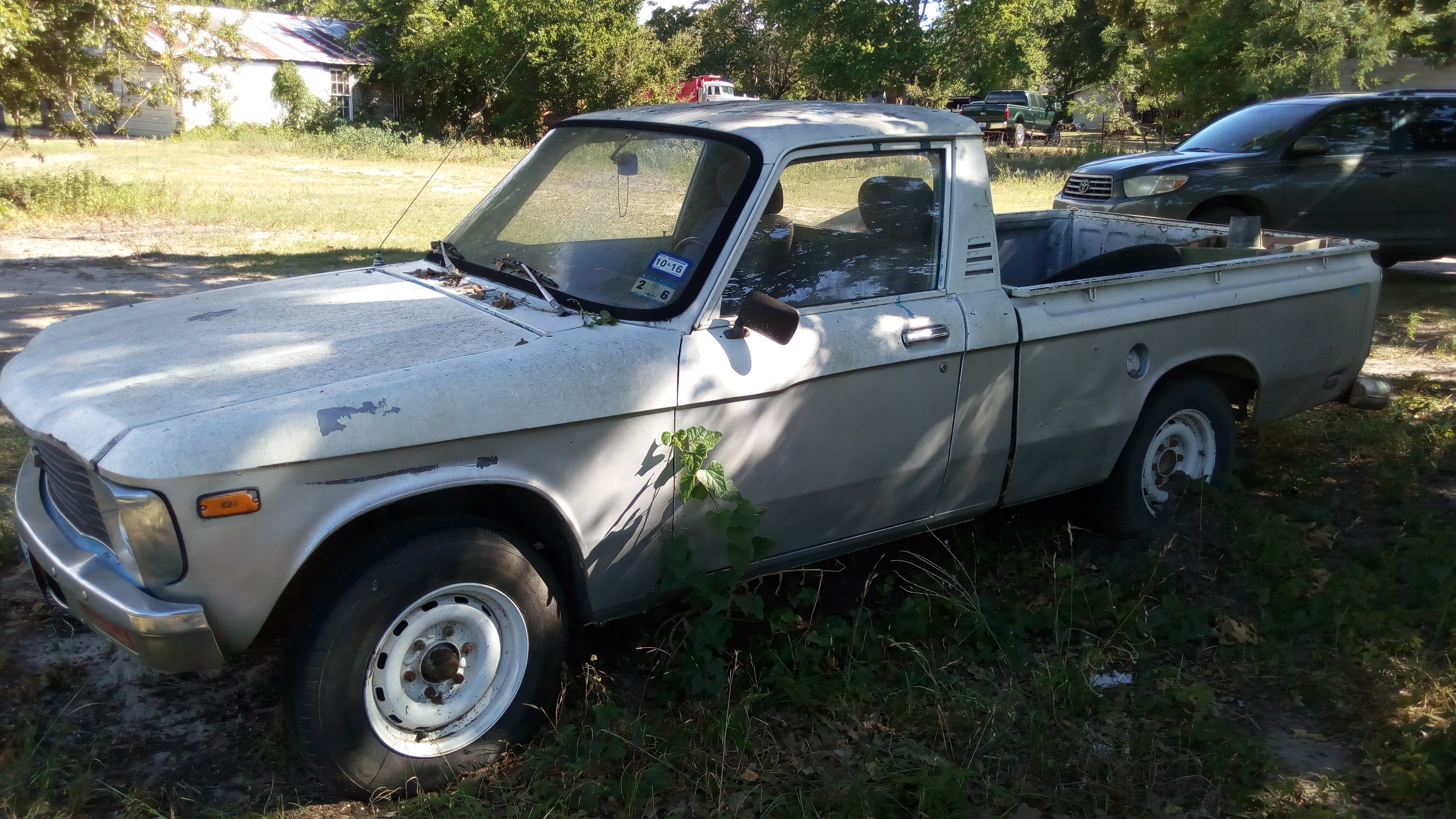

howdy, all!
recently acquired an 80 Luv as project. engine cranks fine but no spark from distributor cap to plugs. i have spark from the coil to the cap, but no spark coming out of the cap plug terminals to plugs. friend mentioned that potential culprit could also be a crank sensor(?). does the luv have a cranks sensor, and location of said sensor?
any advice would be greatly appreciated.

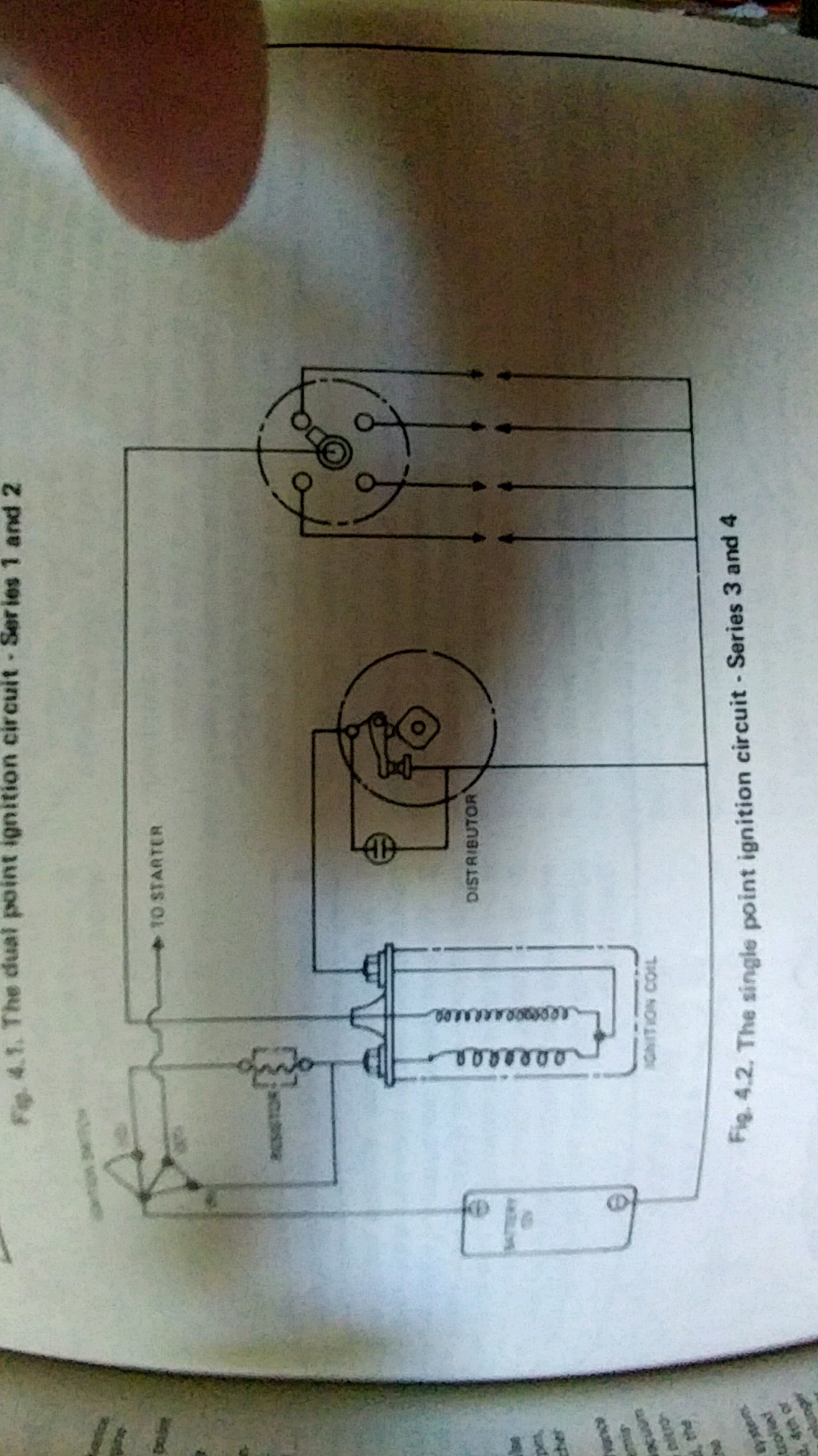

The coil wiring picture, for single points.

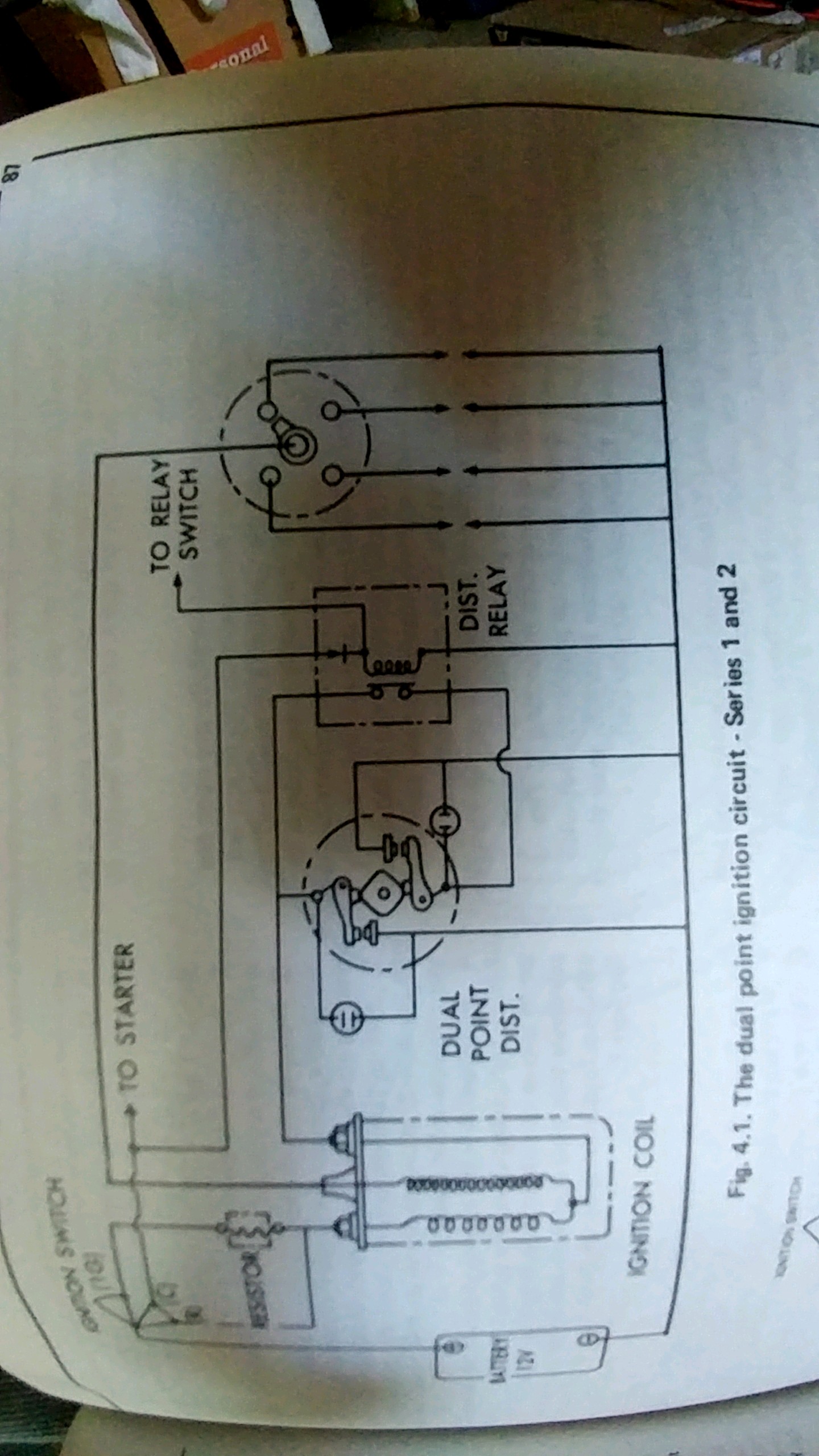

The coil wiring for dual points.

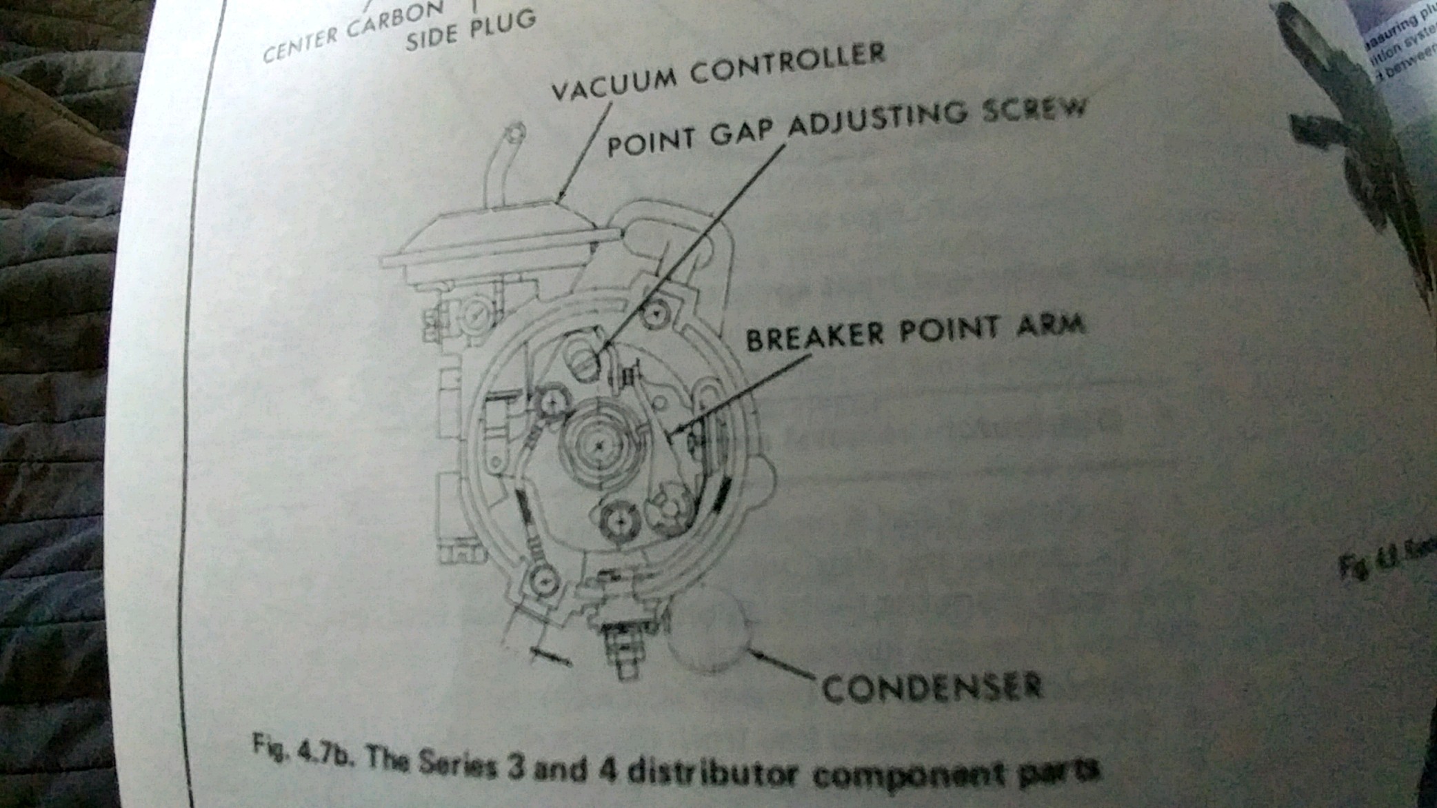

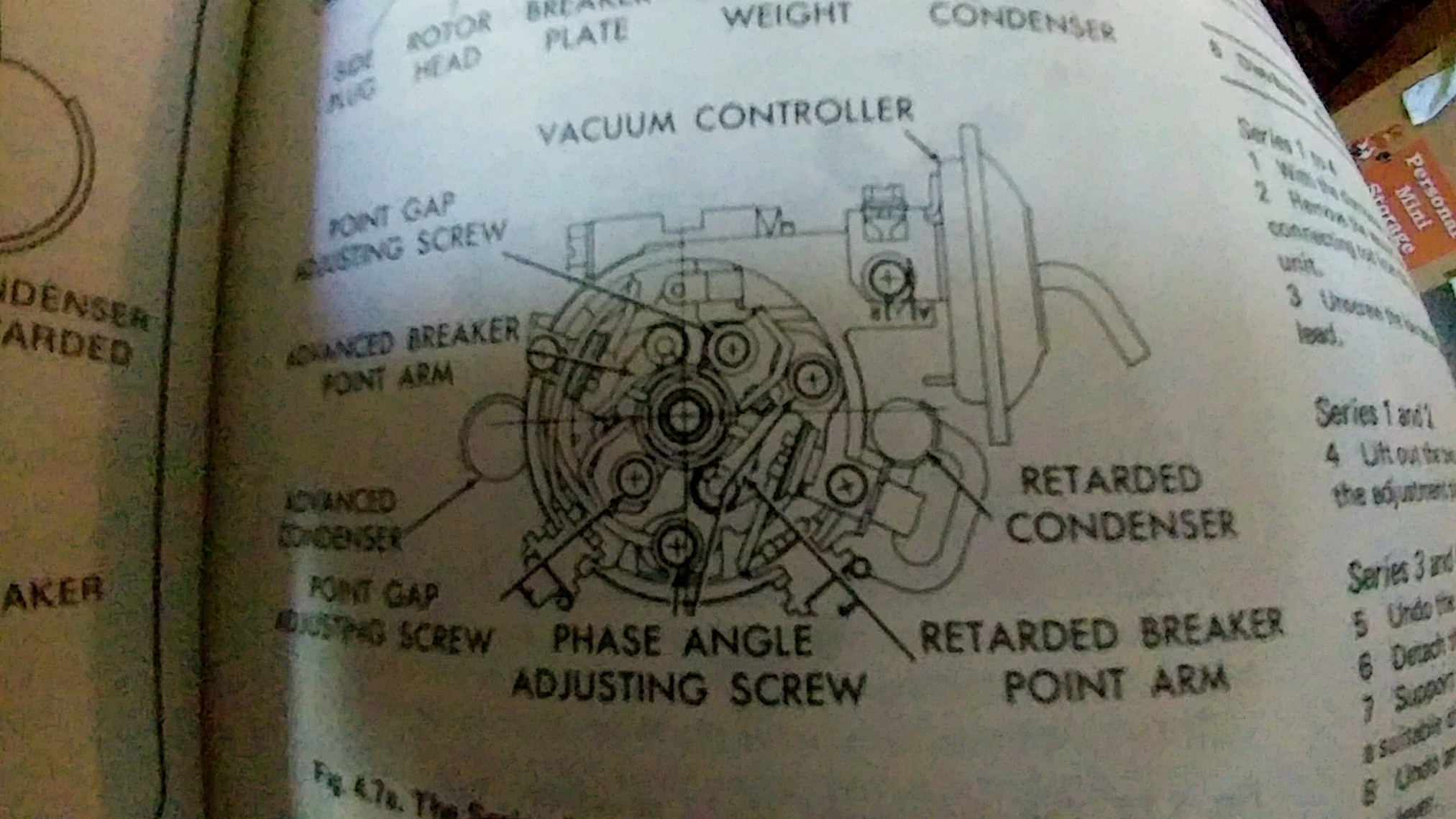

some distributor pictures.

points gap for dual points .018 to .022
series 3 and 4 .018 to .022
series 5 and 6 .016 to .020

single points.

RedSwampFrog wrote:
single points.
thanks for all info/pics.
have the single points situation here. will attempt efforts you've suggested. by the way, points should be gapped at the 'high point', correct?
thanks again
PostPosted: Thu Mar 28, 2019 9:58 am
Correct
