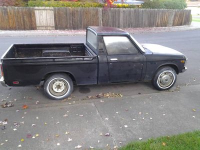

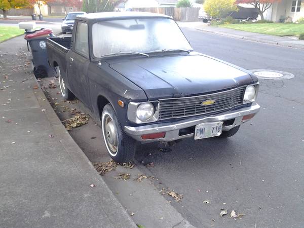

I just bought a 78 chevy luv, It is an Auto trans the truck runs and drives but needs to be shifted into nuetral while stopped at stop lights etc. If shifted into drive it will lurch forward and stall out.
Any ideas, Torque converter? if so part number?
Does it have a torque converter solenoid switch?

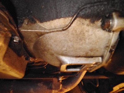

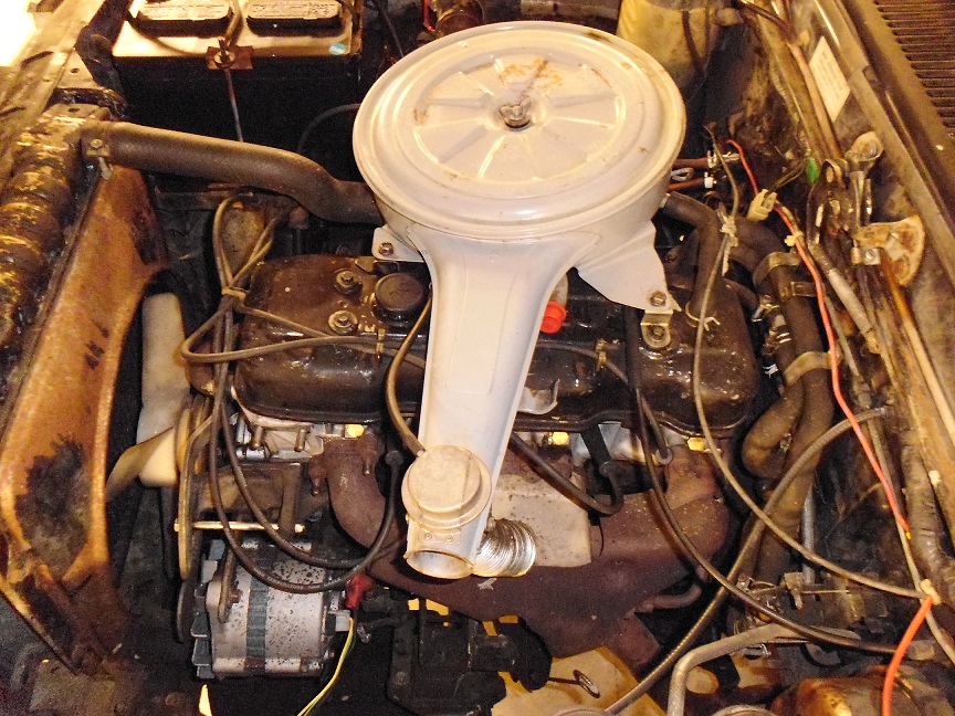

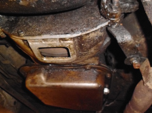

thank you for the reply, it is a 2wd automatic,
the engine is marked G180
I think the transmissions is stock, but I'm not sure. included are pictures
the transmission had a metal tag on the back that was stamped (360) not sure of relevance, maybe a rebuild tag.
