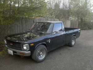

PostPosted: Sun Dec 11, 2011 1:53 pm
That is a 1980 LUV.
PostPosted: Sun Dec 11, 2011 9:38 pm
1980 LUV
1981-1982 LUV
1982- S-10
Three different trucks.
