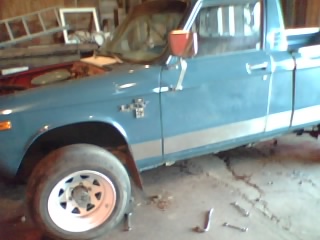

That was before. Step one removed box completely from truck,Which brings me to a question.Behind the drivers side front of box theres a cover ,behind which theres a black plastic thing which there are three lines coming from the fuel tank, this is for what ? Anyway Im fabing the lift and also changing the exhaust to dual tailpipe and replacing the fuel sending unit (aint no wonder gas guage never worked this thing rusted big time).

That box is the fuel vapor recovery tank.

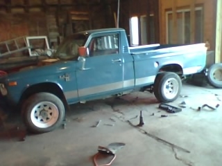

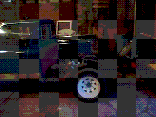

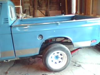

Ok replace box adding lift supports and began to lift cab........aligning body panels as I went.

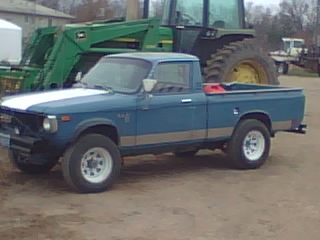

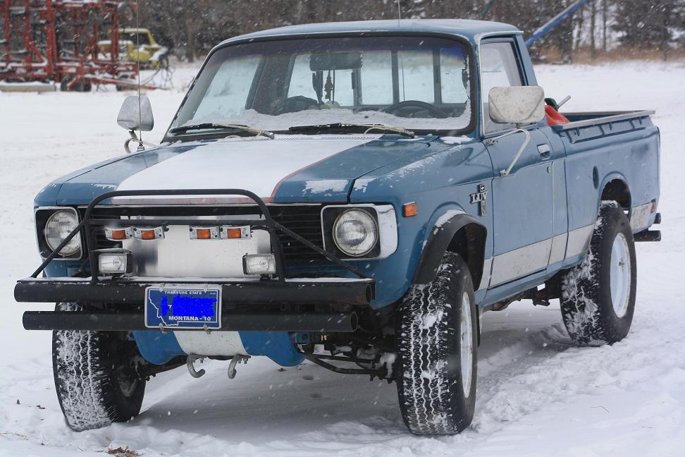

FFWD>>> fast forward to the good part .Well she's done lift wise 2" inches on the body 4" taller tires and 3" suspension and heres what you get. Adding flares to tone the lift into the trucks look and now for the interior projects.Let me know what you guys thing.O almost forgot putting it out there anyone needing new shifter boots my wife sewed some for me they worked and look awesome out of some vinyl we had for other projects.She loves it when I get her involved lol.Anyone wanting some let us know.

ok so you did a t bar crank? and 2 inch body lift? what size tires are those? and can i see a pic of the shifter boot thanks man and looking nice!

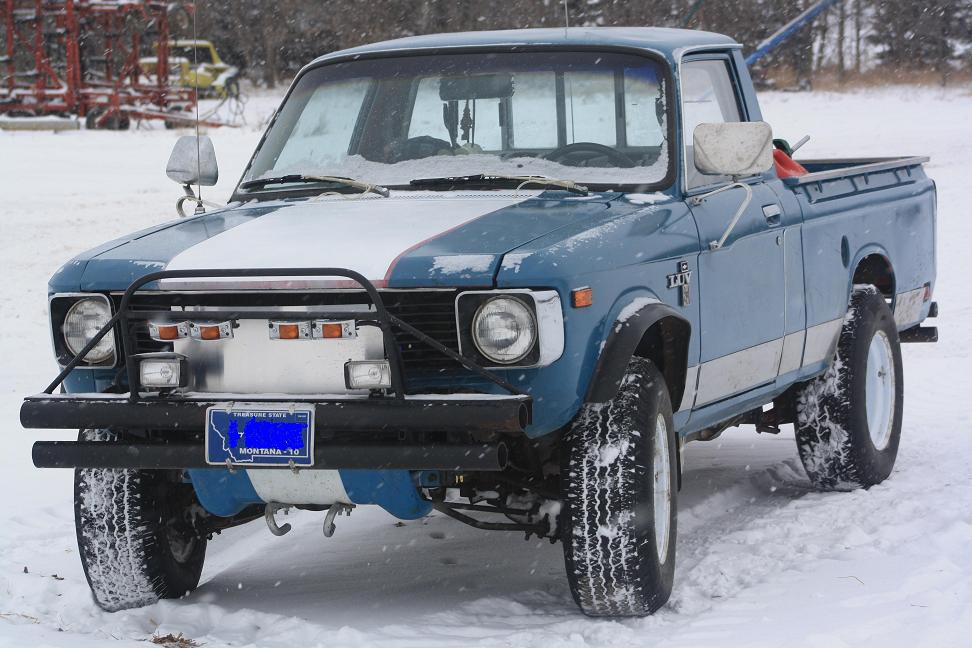

Yea i twisted the tbars just a little still plenty of adjustment left there and a two inch body lift which after measuring were more like two and a half forgot to count in the extra rubber bushings, any how the tires are 235-75-R15 good year wranglers .Theyre actually working great in the snow but gear ratio musta been changed with larger tires as she's really touchy throttle wise , doesnt take much to spin em.Ill try to remember to get pics up tomarrow nite of shifter and transfer case shifter.As far as sending unit no I hauled in a parts truck robbed the unit outa that one only to find it didnt apperently work either , still looking if I find one I try to find a source and let you know.Found a online reman place back east but holy cow could install a whole new fuel system for the price not to mention shipping both ways.

Yes but no on the body lift had a few extra pieces outa several other rigs kits so i cut em down for the two inches and added a addition cushion on the cab sections to ensure i didnt punch trough and left the box lifts at 2 1/2 inches
just to level out body lines its all in the keepin it lined up both height wise and side to side

Well I dont know who told you about cutting holes for the shifters and if they told you wouldnt with a two inch lift or not but I had to enlarge mine and as well for steering too,I went with the wagon wheel style rims so I could do away with some clearence issues on the back side like antisway bar in the front and inner fenderwall to the back.They have the right backspacing to allivate some of that issue and dont look too bad either.For me it was about the same issue you cant find a decent tire in 14" I drive some gravel roads to work and it doesnt take long before the good set was trashed.Sorry didnt get a pic of those boots and my truck isnt home tonite left it at work and drove rig home.But heres the best b4 shot I got of the truck.Hope this helps Oh I wouldnt use 1" tubing stacked either do 2" tubing or blocks stacking anything is never a good idea more parts the more chances something to go wrong.

Wow guess I hadnt seen those two pics together yet man shes alot taller now notice the clearence from the ground to the skid plate lots more sunshine under it even.Not to mention the size difference of the tires WOW.Shouldve posted it this way before .
