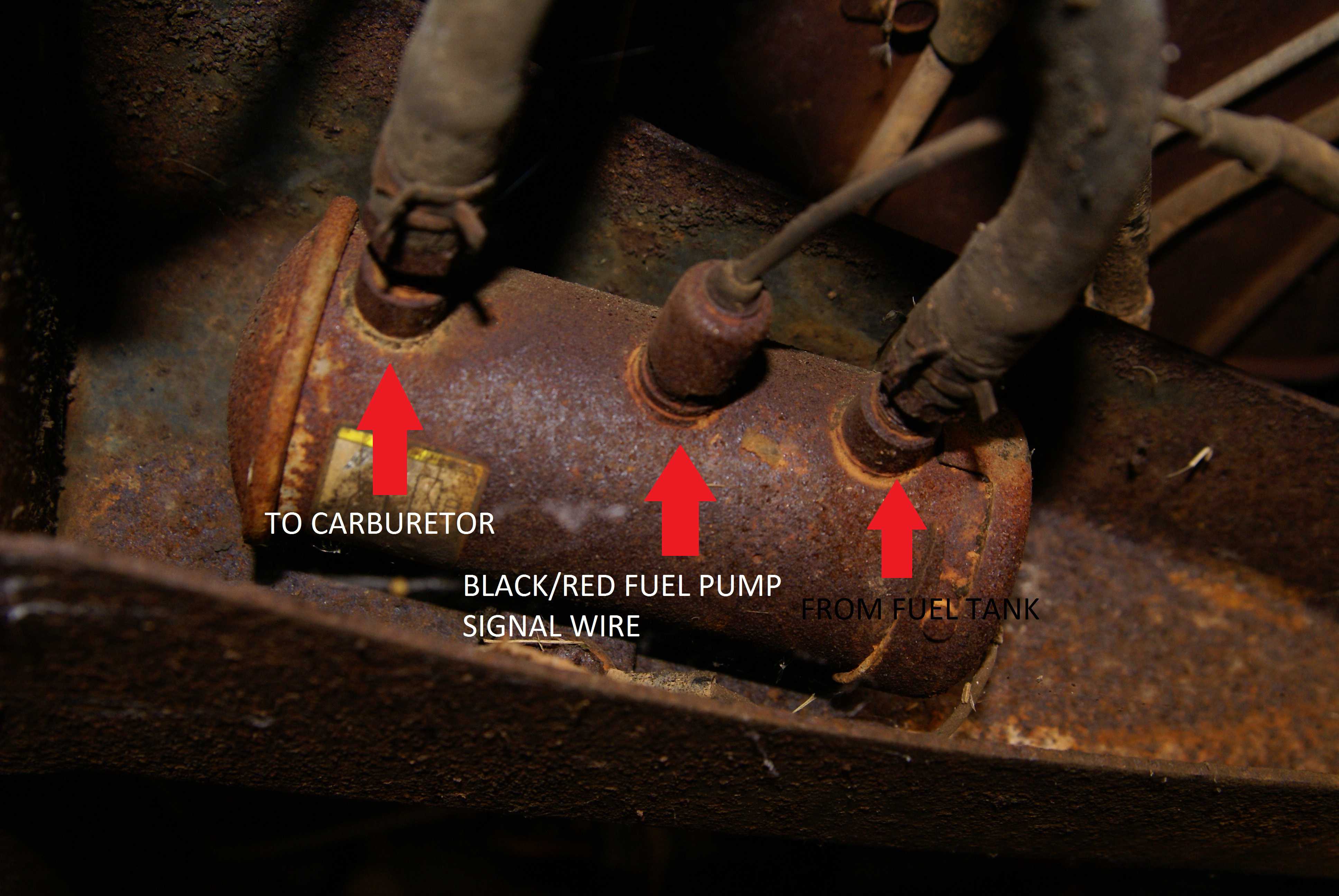

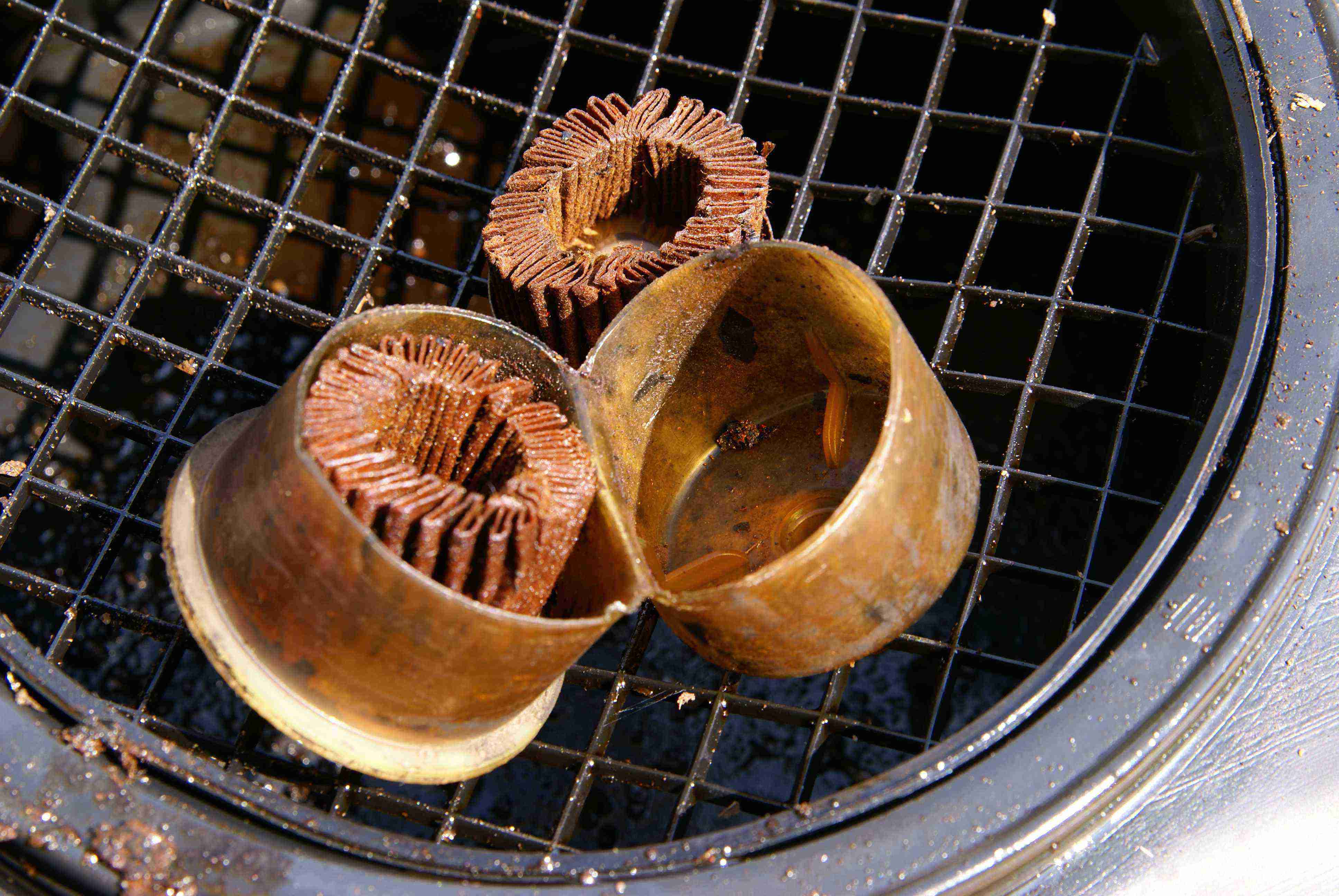

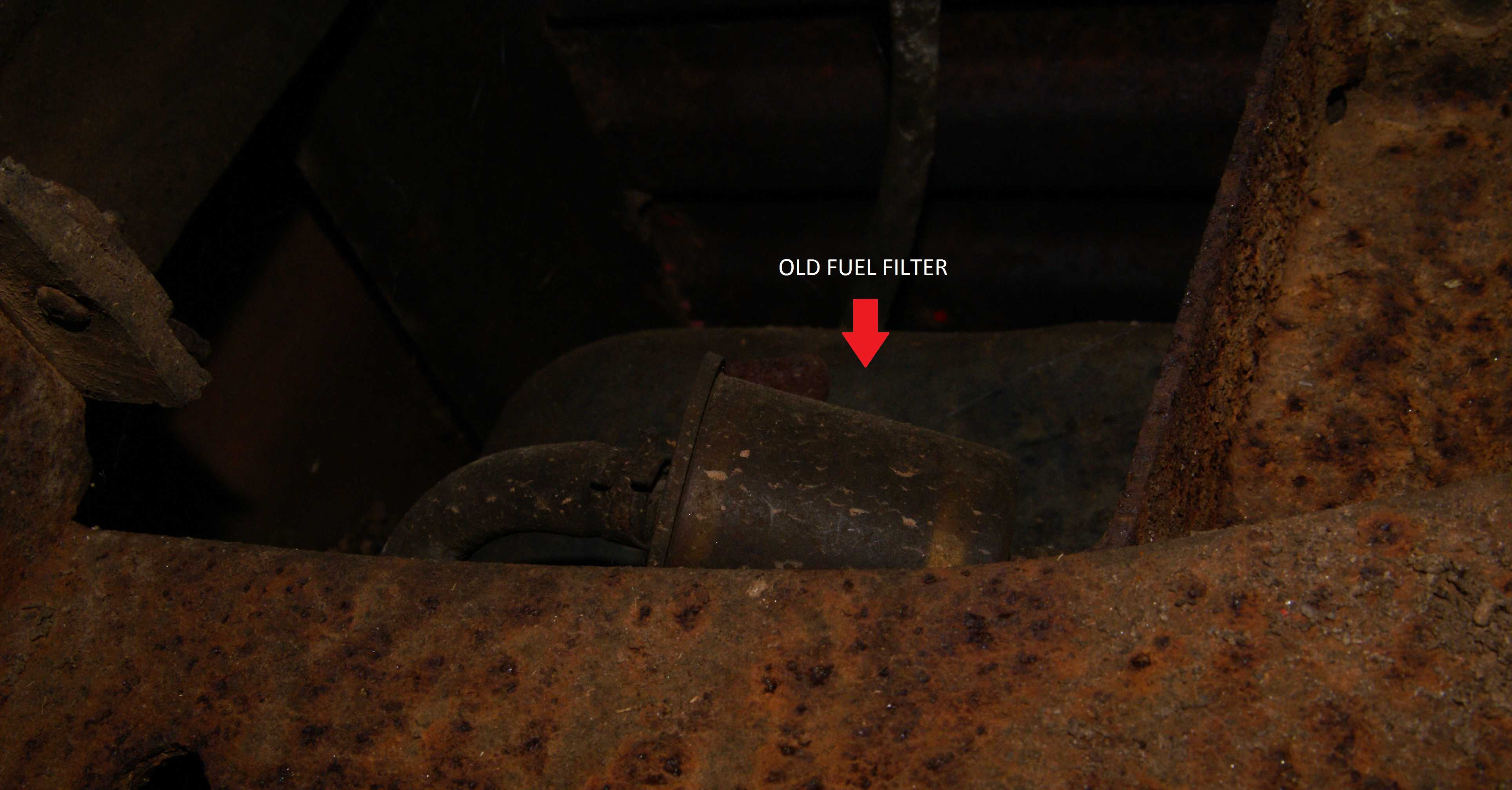

Thanks Labman, I'll look in that direction. Jeramy I think I'm gonna have to replace the fuel pump too. It's in rough shape. The old fuel filter was full of debris, and the gas was brown and dirty when it drained out.

thats why i had to replace mine.it had 2 inline filters before the pump. the one closest to the tank was so clogged that i couldn't even blow threw it. i took it out and hooked everything back up but the pump was toast so there went 50 bucks.changed pump and filter.

Thank you for the update Jeramy. I think I've narrowed down the problem to the fuel pump giving up the ghost. But I've decided to rebuild the fuel system from front to back anyway. So a new fuel pump is in order. viewtopic.php?f=5&t=23357
