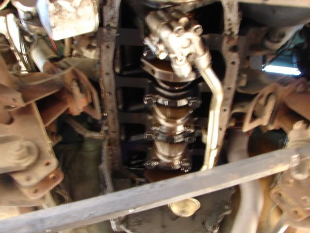

Somewhere in the link there are some pics. I have a standard (no kick out) 7 quart Moroso pan. One hing I LUV about the LUV, is 4 bolts, and the crossmember comes out and you can drop the pan...
Ok i wanted to do this but wasnt to sure about it. now my ? when you take out the bolts to the crossmember with motor in does it kind of collapse my friend said it would i thought not but wasnt sure.
 Post subject: Re: Drag racers
PostPosted: Sun Jun 20, 2010 9:23 am
No it won't, unless the other 5 crossmembers have been cut. I have a removeable tranny crossmember, and I have had both of them out before with no issues...
joe wrote:
thanks itll make things easier when i have to drop my pan for my cam & 2 piece timing cover.
I currently have the crossmember out to do my timing chain and other stuff on my truck with no problems-
