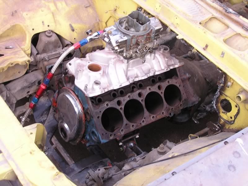

Torched the floors and firewall out and got a mock up motor/tranny sittin in it. Stuck the motor back so far that the front axle centerline cuts #1 and 2 cylinders in half and still leaves me a 1/4" from the back of the 750dbl pumper to the firewall. Gonna pick up some 20gauge this weekend and start puttin a floor/firewall together :) I still can't get over how short this thing is. 4'1" to the top of the roof 8) Will get some pics when there's something worth taking pics of.

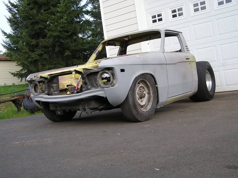

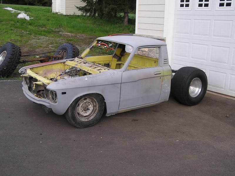

Here's a couple of pics. Nothin special to look at yet. Gonna pick up some sheet metal soon and put a floor and firewall in it. It's scootin along so far

You going to run one of the front mount distributor conversions? Coming along nicely.
PostPosted: Sun May 06, 2007 4:38 pm
Joined: Sat Apr 28, 2007 1:40 pm
Posts: 141
Location: Washington
Where can i find one of these? That would sure make life a whole lot easier. Otherwise I have to get at it from the interior :roll:
PostPosted: Sun May 06, 2007 8:22 pm
MSD makes em for sure. NOT sure what the total cost is. The dist. itself is like $249, but I'd assume you have to run a crank trigger and a dummy shaft to complete it. With the set back you have, it'd sure make the install easier though.

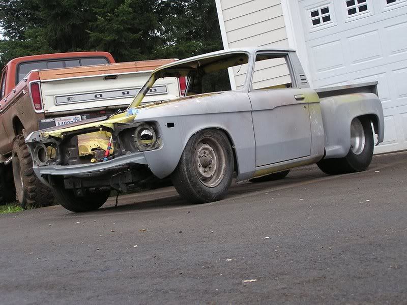

Cut some more out of the bed to clear the tires. Still need to trim a little bit more but you get the idea.
