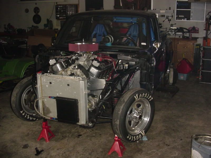

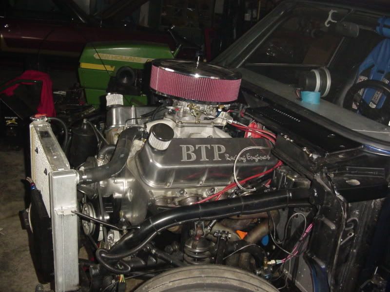

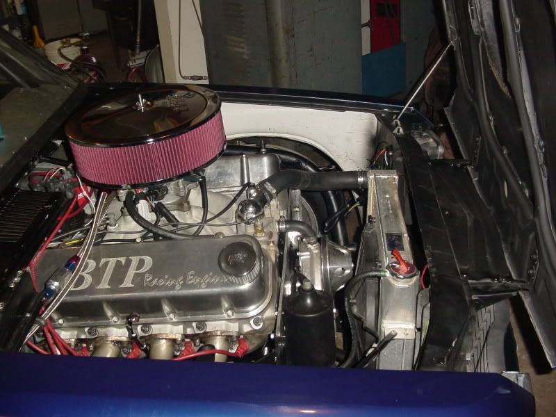

My truck has a .030 over 454 with LS7 Rectangle port cast heads. Here are some specs.
Balanced 460 BBC
Stainless Steel Valves
System 1 Oil System
Crane #138291 Roller Cam
Triple Crane Springs
Crane Roller Lifters
Crower Roller Rockers
J & E Pistons
Cam Chain Drive
CSR electric water pump
CSR thermostat housing
Moroso Valve Covers
Champ Oil Pan and Pickup Tube
Speed Pro Plasma Moly Rings
SFI Certified Flex Plate
Crane Valve Stabilizer
Eagle Rods
ATI Damper

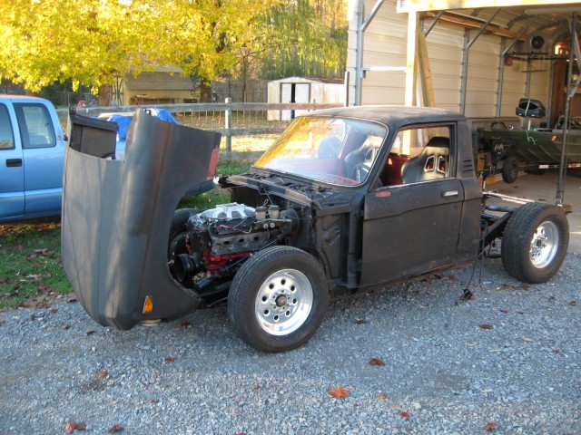

1978 mikado
2002 lq4 6.0l 364 ci.
vic jr intake 750 holley
cam/springs/lifter/pushrods
th350 3500 stall
6.0l ls1 swap th350

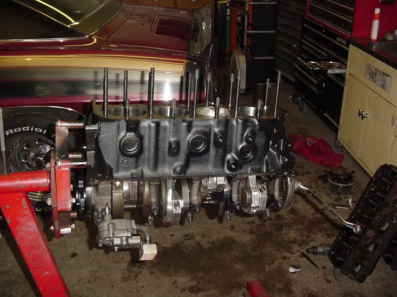

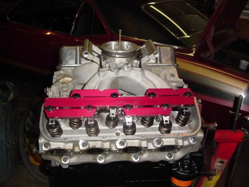

Well I pulled the boat motor last fall, but due to the economy I wasn't able to build a 540 like I wanted. I did scrape up enough used part to build a 461. Timing chain, bearings, rings and gaskets are new, the rest is stuff I had laying around, picked up from a buddy or Ebay.
454 BBC bored .030 over
Canfield Alum Heads
Manley 13:1 pistons
Comps solid roller cam 268/274 @.050 with .690 lift
Crower solid roller lifters
Brooks Alum rods
Holley intake with 900 CFM TBI and 85lb injectors running on E85
Not actually running this TBI
