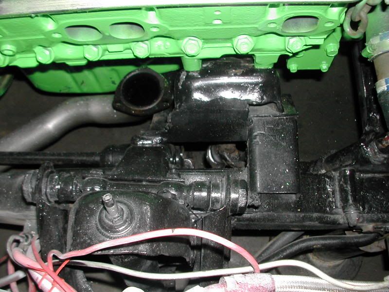

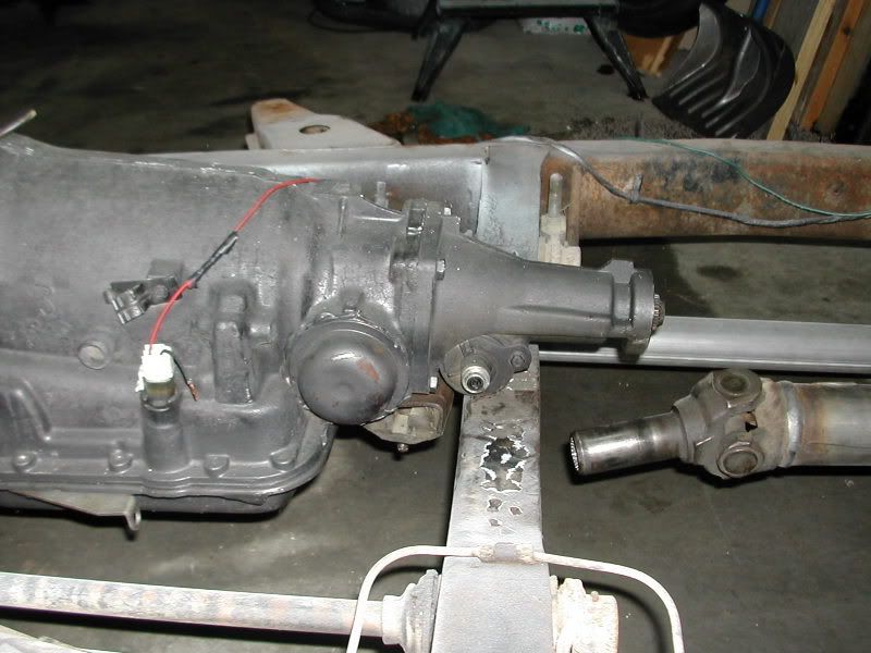

http://i126.photobucket.com/albums/p87/ ... ymount.jpg
http://i126.photobucket.com/albums/p87/ ... oomuch.jpg
Can I cut out the center section of the tranny mount and leave the torsion bars for now without any trouble to make my removable mount. My driveshaft is almost direct inline. Might drop it a half inch at the most. See were the round bulge is resting on the original luv Xmember
Need to make new motor mounts and get rid of the access bulky ones,

I don't see why not. You will need to make a sturdy bolt in section either over or under the tailshaft. This will keep flex down to a minimum. I would get a piece of thick wall 1x2 or larger if possible, and weld a piece of angle to each end to cap it. Then drill the angle for the bolts to mount it to the original crossmember. I would cut out just enough to clear the tailshaft along with about a 1/2 inch or so for clearance. That will leave plenty for the torsion bars.

Was thinking from the way it looks I could just get a piece of 3/8 angle iron wide enough to bolt to the cross member. Get a 3 or 4 inch angle so it is enough to set my single bolt through. Bolt the angle iron on the front of the xmember all the way through the original for removal if needed and maybe a 3/8 plate on the back side of the xmember for extra support on the original.
