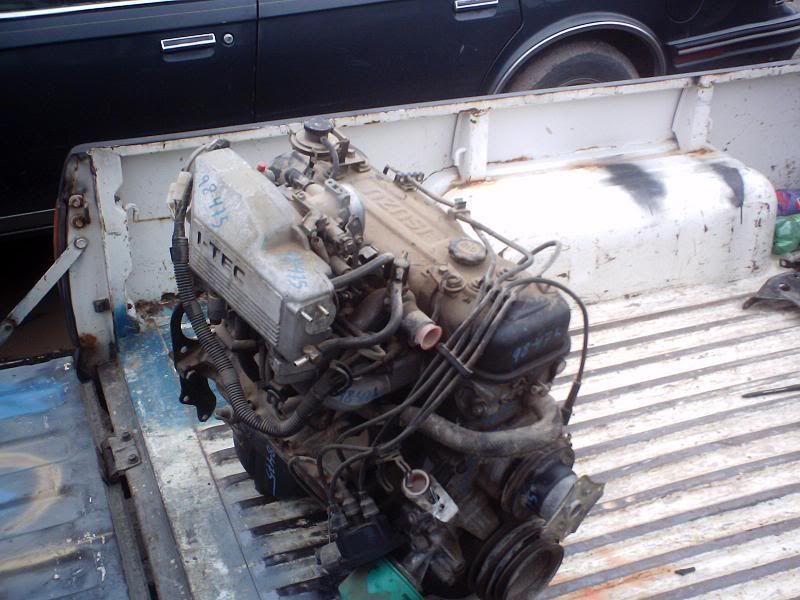

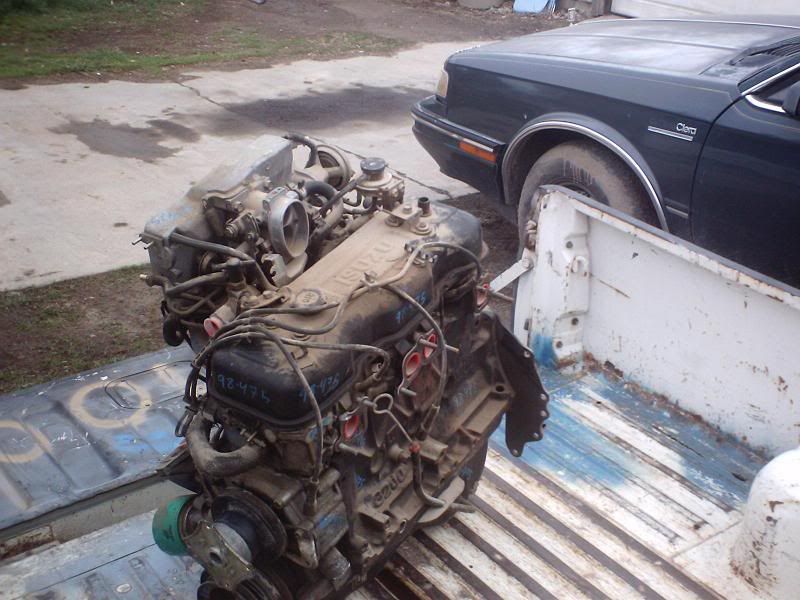

heres a few pics of my FI intake when it was still on my impulse motor.
i still have the intake in the garage here. there was no computer for it when i bought it, but a megasquirt system could easily be adapted to work with it. shoot me a PM if you wanna know anymore.
