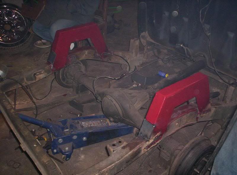

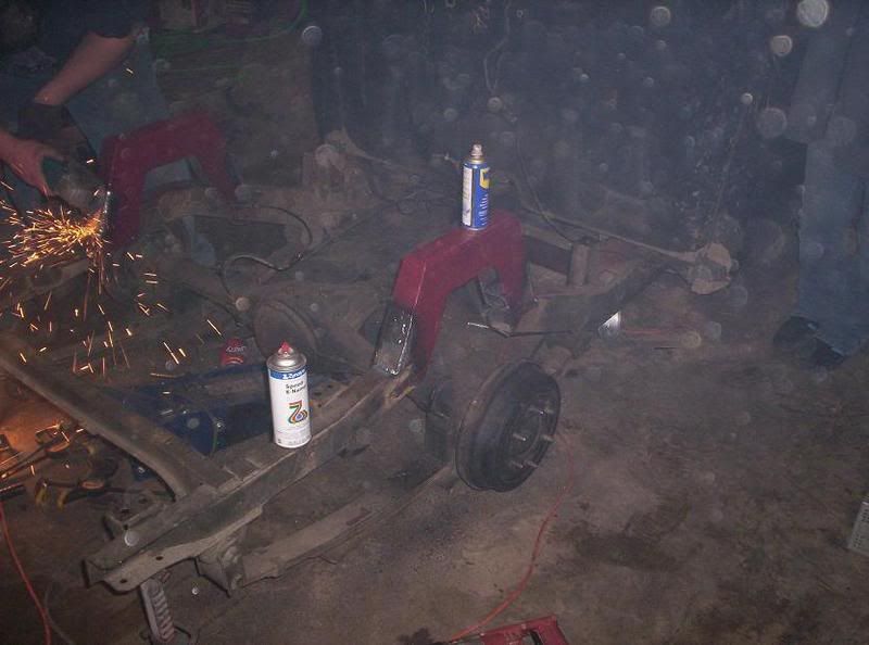

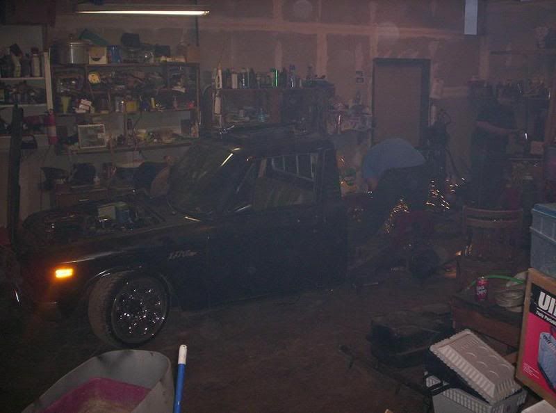

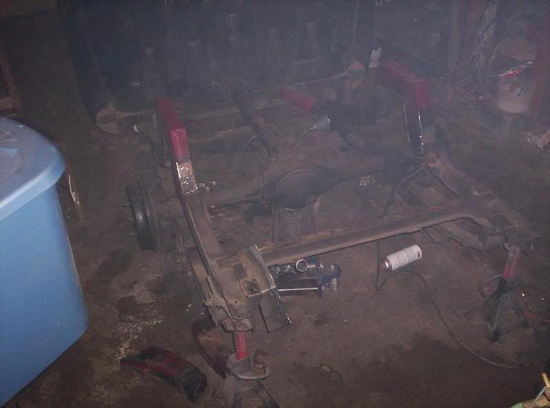

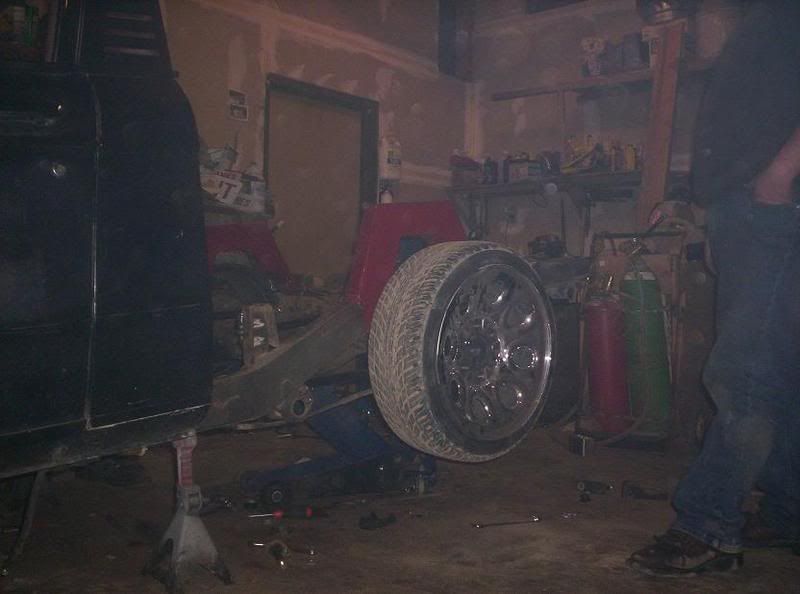

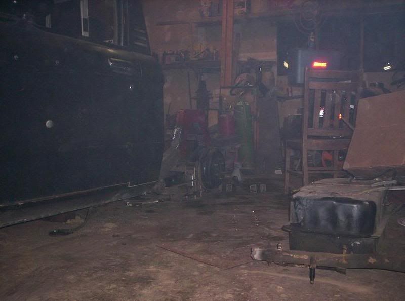

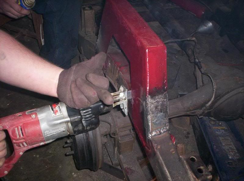

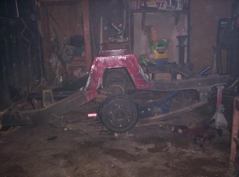

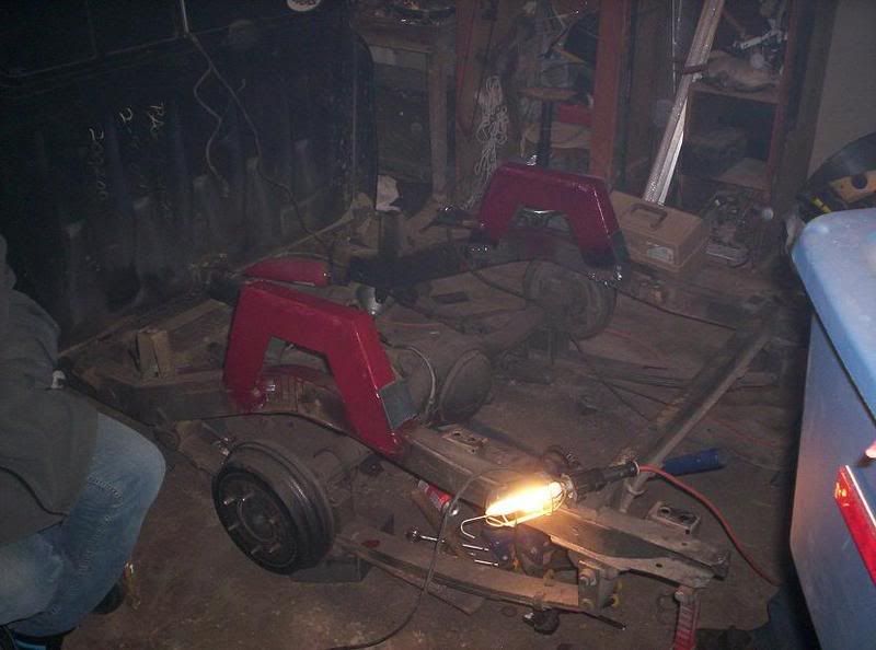

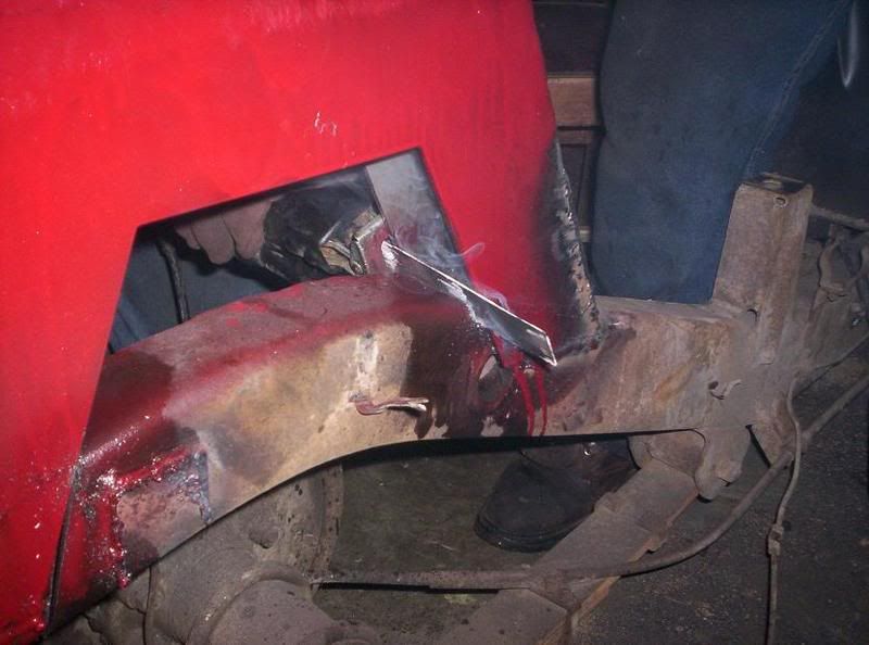

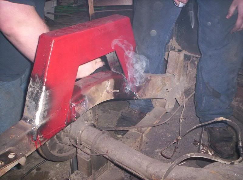

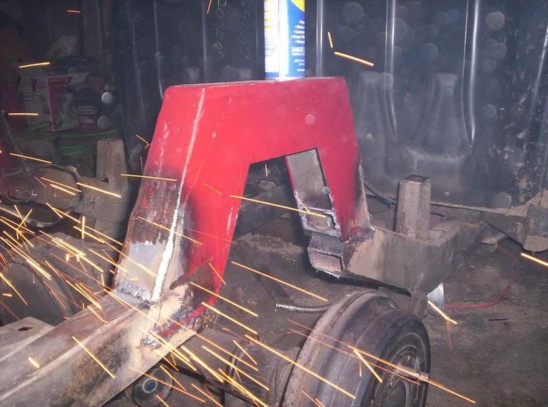

mkay guys!! heres the pictars!
we almost got the passenger side notch done, but ran out of wire. we still have to put the bottom on the driver side notch too. thats what were doin tomorrow, along with mocking up the 4 link.
there will be more pictrures to come tomorrow, but heres from today...
more to come...

What type of 4-link you runnin? Triangluated or Parallel? Cuz if you are runnin a tri you gotta relocate the gas tank, I just got myself a fuel cell. Also you boxin in the back of the frame and cuttin out that crossmember? I did and it looks way cleaner!
PostPosted: Sun Feb 11, 2007 3:10 am
LUVTruck.com's Cornholio
Posts: 1515
well we took out one of the crossmembers, the one that the fuel tank mounts to. Yes I am runnin a triangulated 4 link... I do definently realize that the tank needs re located. And I dont think i am boxing the very end of my frame. Dont seem to need it?
PostPosted: Sun Feb 11, 2007 11:35 am
Posts: 440
Location: Bowling Green, Ky
I boxed in the back of my frame cuz thats where we put the fuel cell, plus it makes the backend cleaner. Truck is lookin good, keep up the good work!

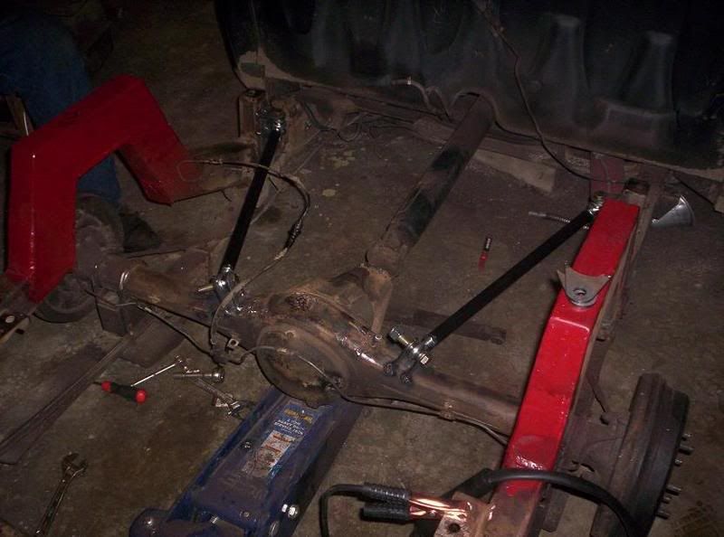

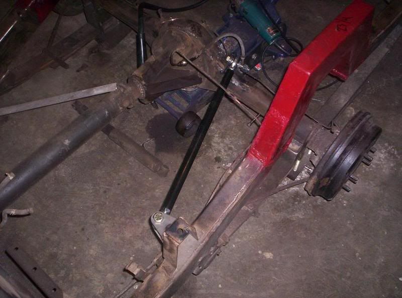

PostPosted: Fri Feb 16, 2007 1:47 am
Swap Specialist Mod
Posts: 2831

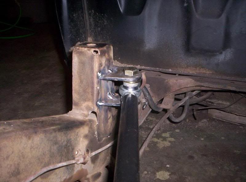

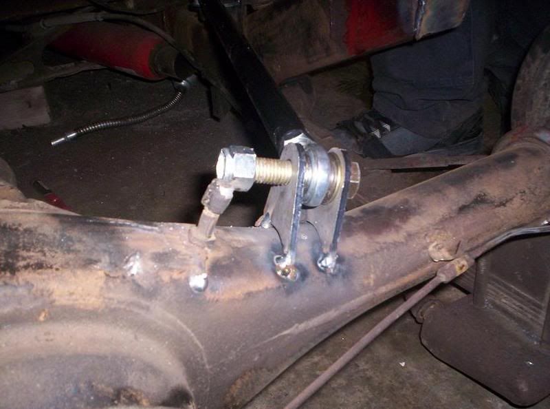

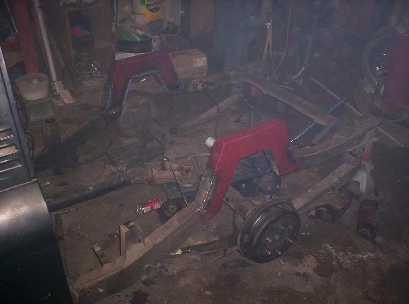

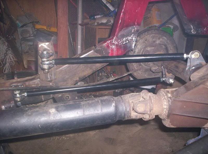

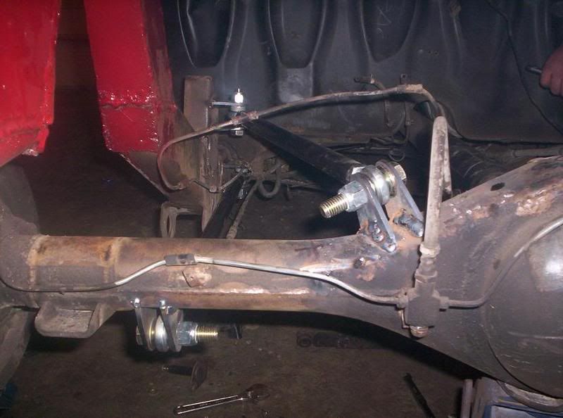

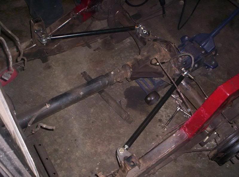

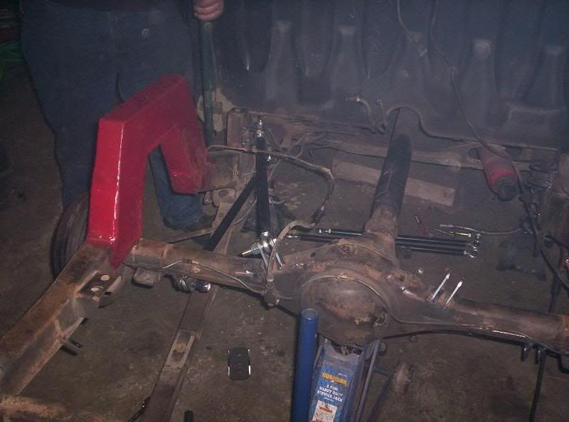

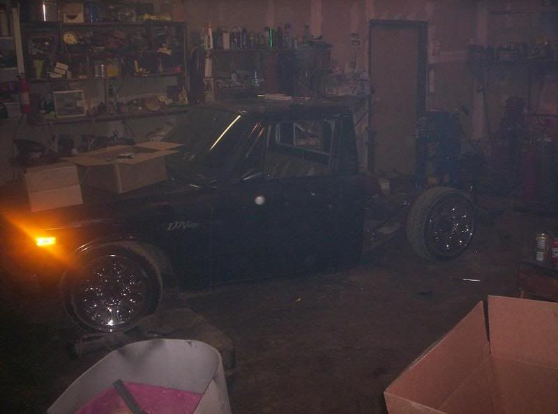

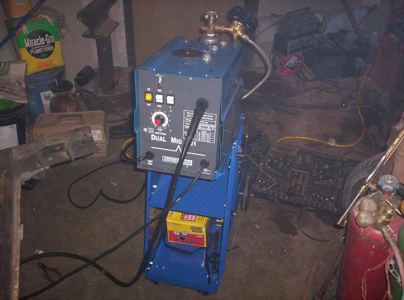

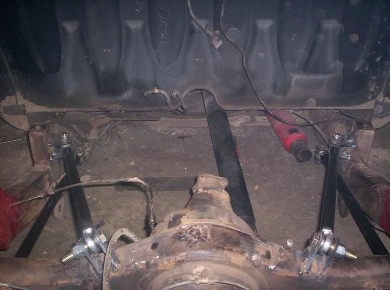

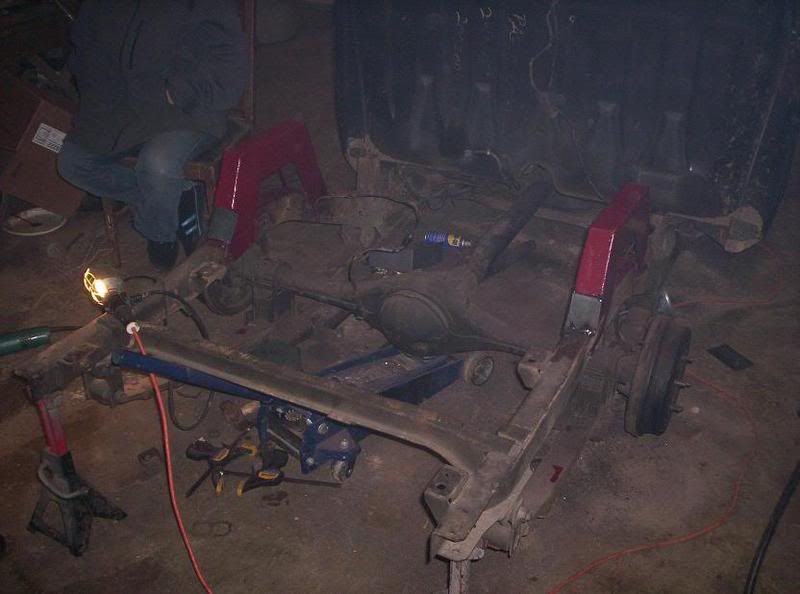

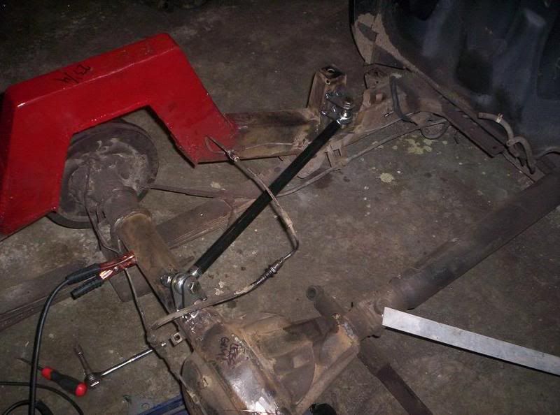

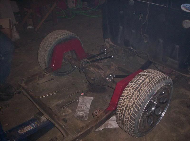

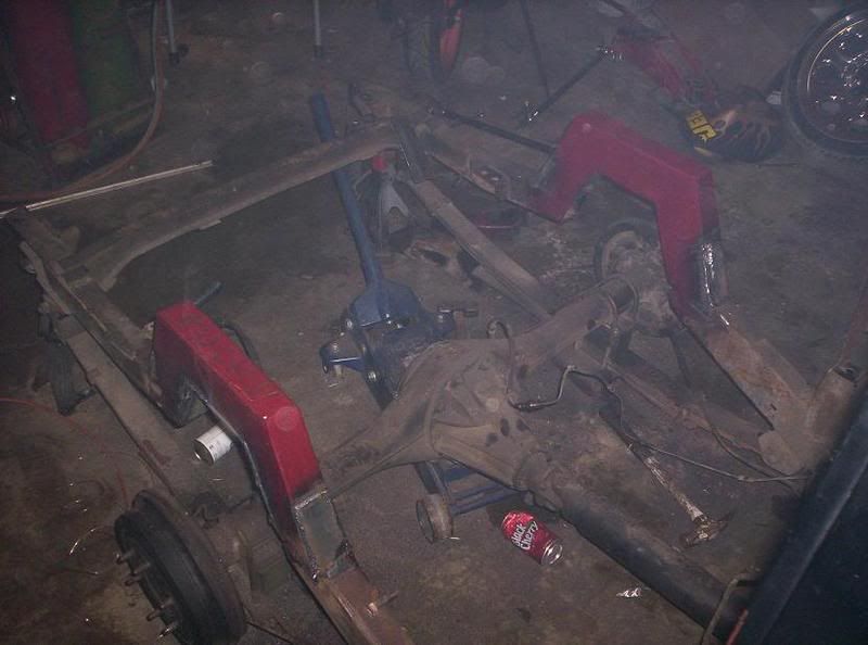

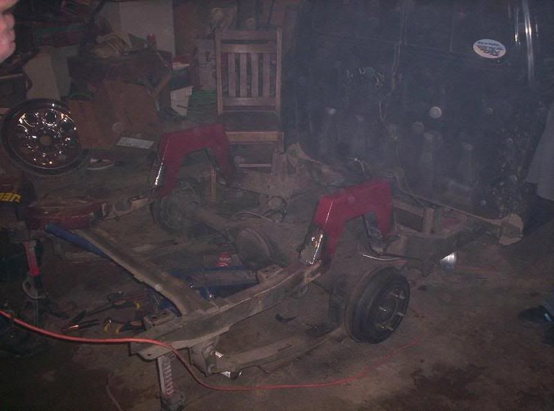

well its official!!
it lays frame with all 4 tires on the ground!!
yep, we got the 4 link done tonite. very easy i might add. the hiem joint 4 link kit made things alot easier than i though it was goin to be.
anyways, you all want to see pictars, and aint even gonna read this... lol
and the money shot...
also, the new welder!
as it sits now, it really isnt laying true frame. its sittin on the one crossmember that hangs low towards the end of the cab. its also sittin on the old spring mounts. but all that stuff will be drug off. not even kiddin.
also, we did go a little nuts on the notch too. we could have put it about 2 inches lower, and would have been fine.
we should be getting the rear bags mounted tomorrow night. we might even get some air line and valves hooked up.
more pics tomorrow.
