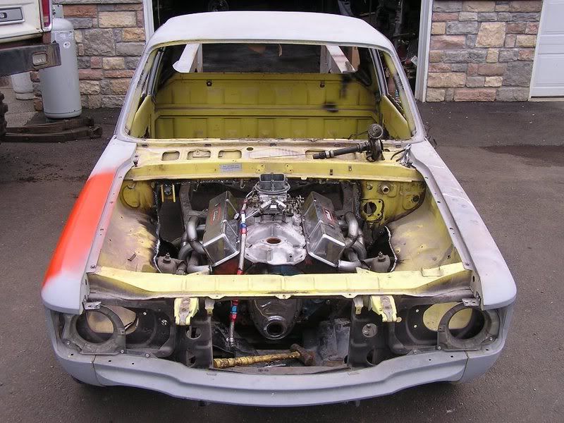

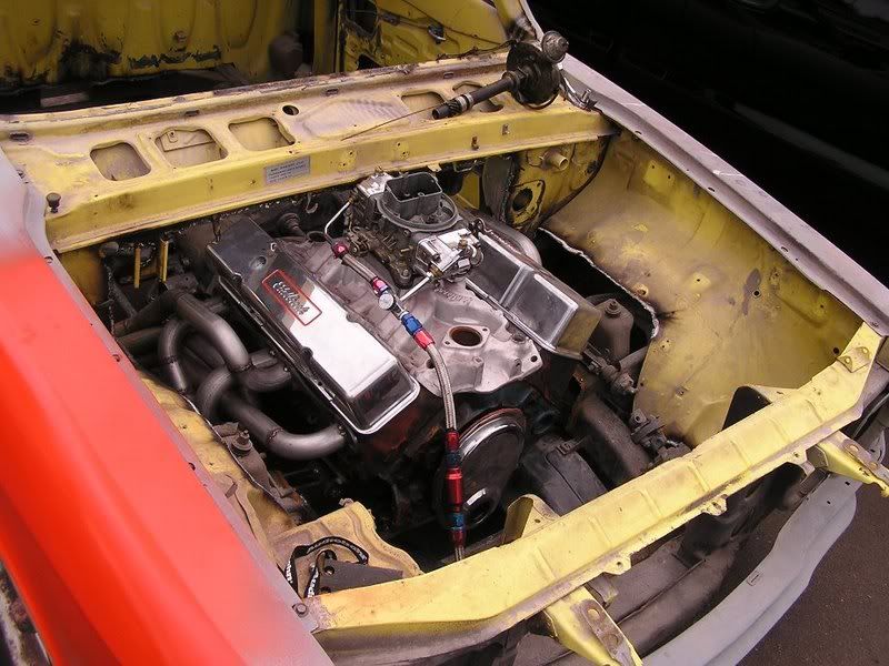

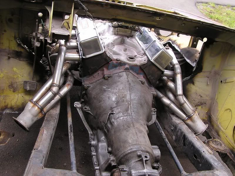

Cut some more out of the firewall, cut some more out of the bed so there's room for the tires to flex at speed, and stared and planned for a while :wink:
Threw the headers I built for the 'yota on it for shits and giggles. Actually fit pretty well.....as long as you don't mind the headers in the interior :lol:
Here's a shot to give ya an idea of how far the motor is set back. I swear that notch for the hood latch was really made for a double pumper 8) Hopefully the airgap intake doesn't move it back any... 8O
And another just to show how tiny it is
One more. Almost tucks the 15's in front with the torsion bars at factory height 8)

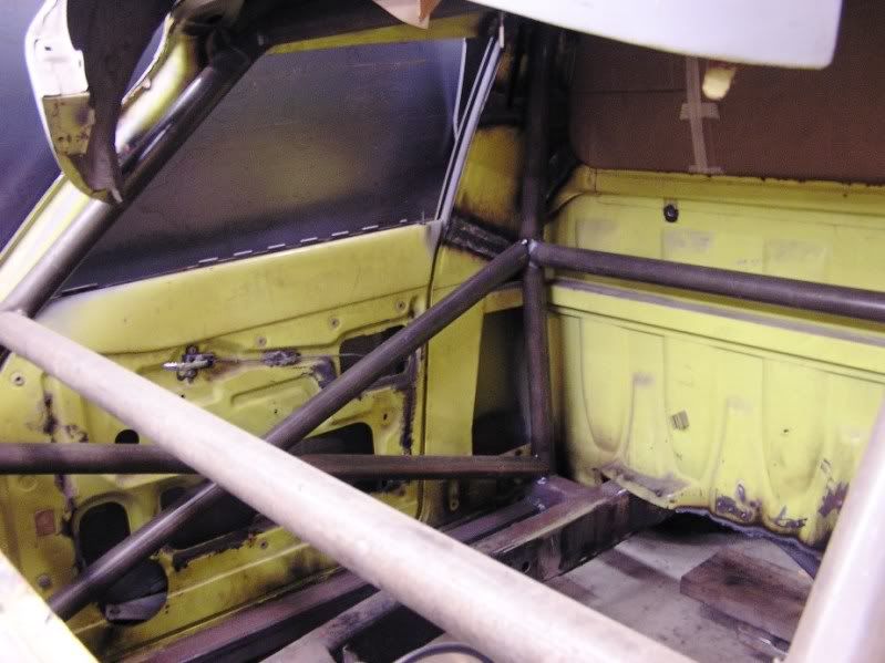

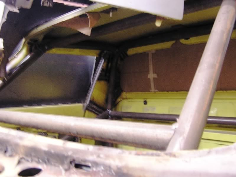

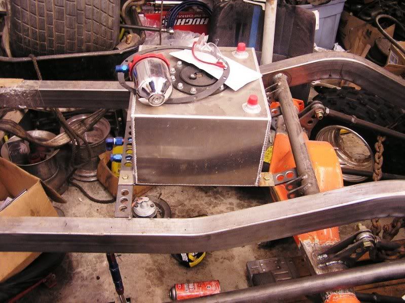

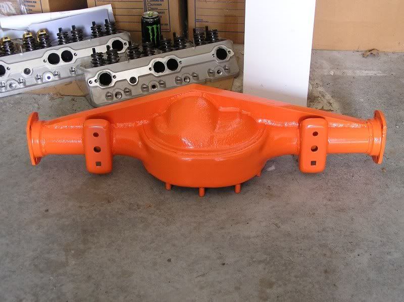

Been slowly but surely peicing it together. Mounted the fuel cell, pump, and filter. Cut a bunch of unneeded brackets and wutchamawoozits off to take some more weight off. Ordered a bunch of 1.75" .120 wall tubing so I can start bending up the cage for it. Bought a Tig welder and am learning to weld aluminum so it will get an aluminum interior/firewall instead of 20 gauge. Set the pinion angle, welded the perches on and backbraced the rear axle then added some paint to it. And no I didn't forget that I need to drill holes in the brace for the u-bolts :lol:
Here's a teaser. Will have more soon

just a heads up for you,most ppl that build cages for the strip use .134 wall tube so it passes tech after it's been bent for the cage

I've seen dirt track cars with .083 and smaller(scary) but I know NHRA mandates .120 wall and most tracks have the means to sonic test for thickness that's why most people go with the .134 wall it's only a couple pounds (2-5 i can't remember) difference for a 20 ft stick anyway.You could run the .120 everywhere else other that the main hoop and halo and probably be ok,just better to be safe than sorry.
