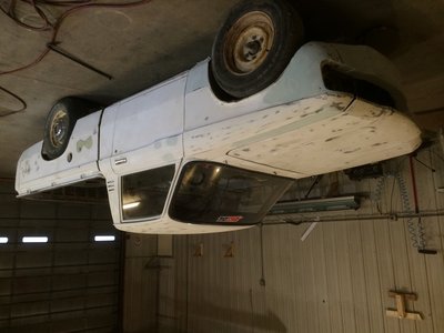

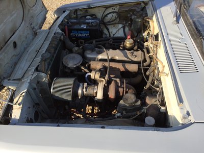

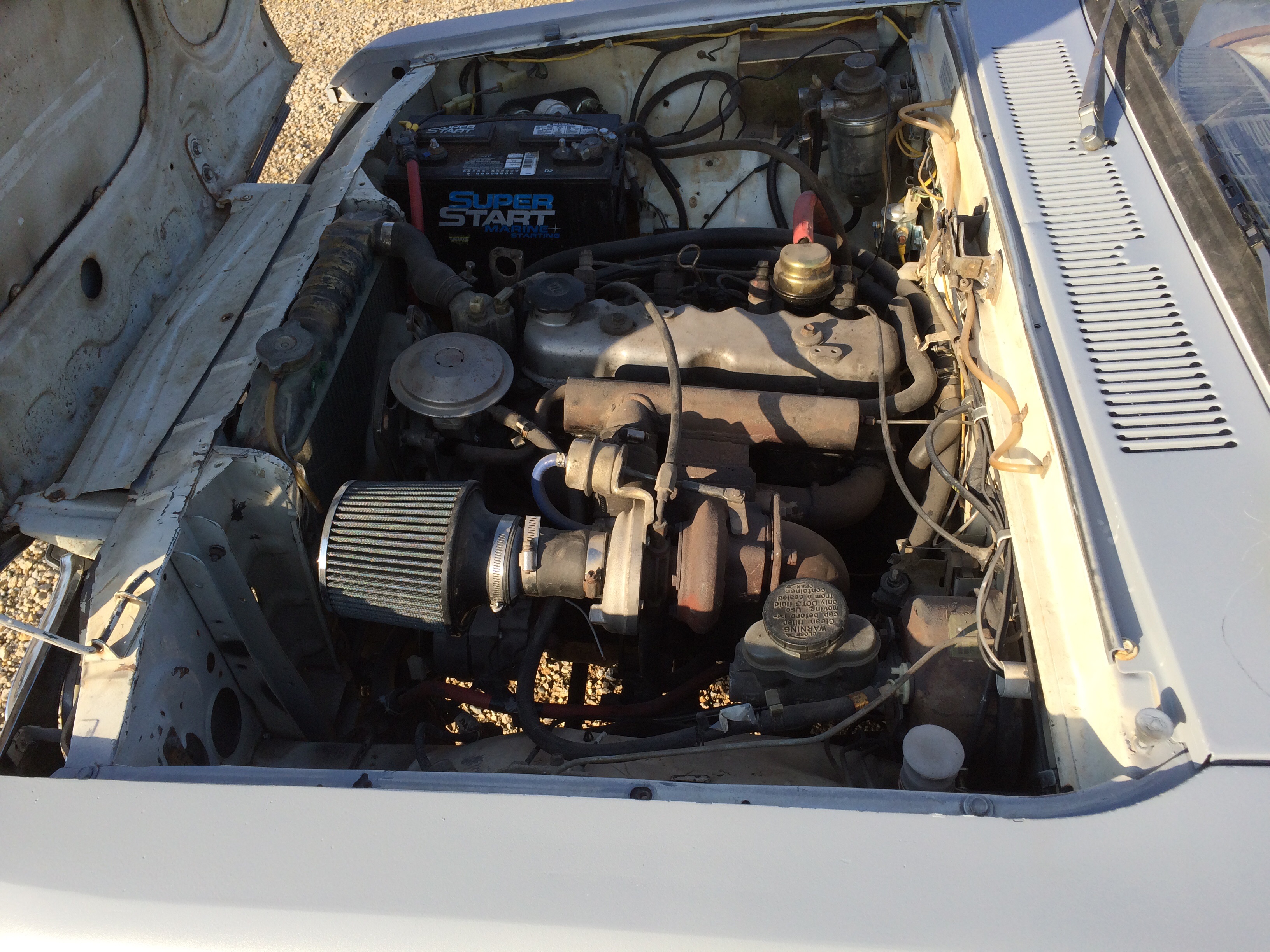

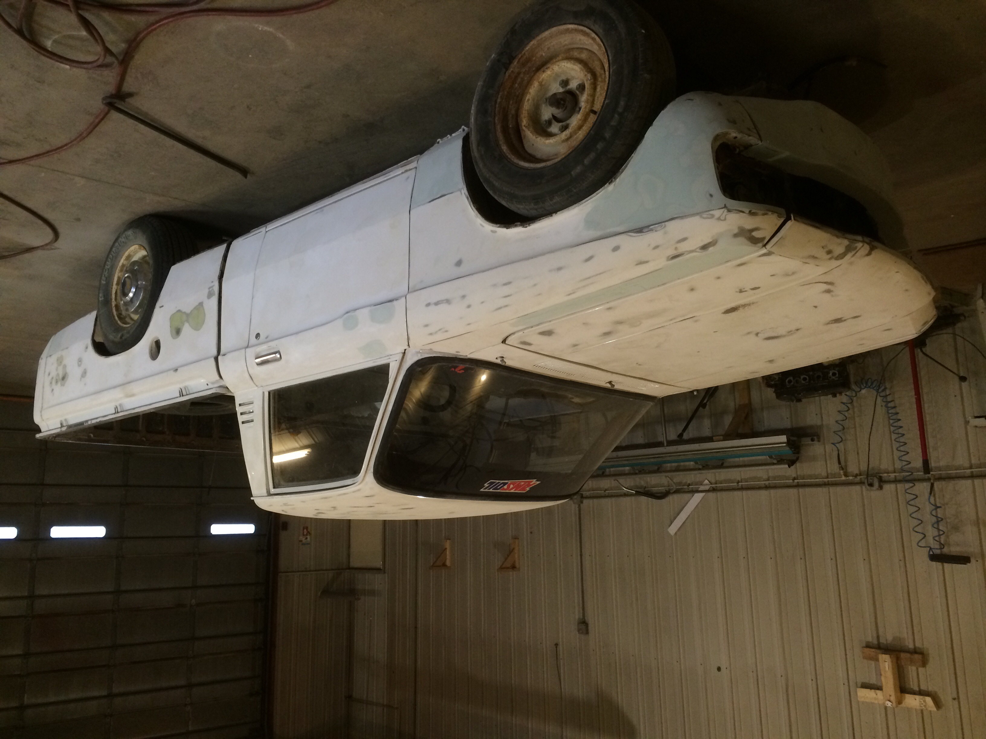

Hi, thought I'd post some pictures of my attempt at doing a diesel swap in my Luv. I'm using a 2.2 Isuzu with a custom turbo and a T5 tranny out of a s10.
Edit. Are my pics upside down?
File comment: The engine
File comment: This is the truck
PostPosted: Fri Sep 26, 2014 9:04 pm
Yes they are...
Yes they are...
PostPosted: Fri Sep 26, 2014 9:06 pm
Lol I only posted once...

What am I doing wrong?
PostPosted: Sat Sep 27, 2014 7:40 am
Posts: 1703
When I click on one to expand it, it's right-side up. I'm guessing it has something to do with the EXIF metadata that's part of the image file header. And I'm guessing you shot them with a smartphone. Most phones shoot in "portrait" mode by default because the screen is laid out that way. So you have to turn the phone one way or another to shoot in "landscape". The phone senses this, but it apparently got confused.
Some photo editing programs will correct this.

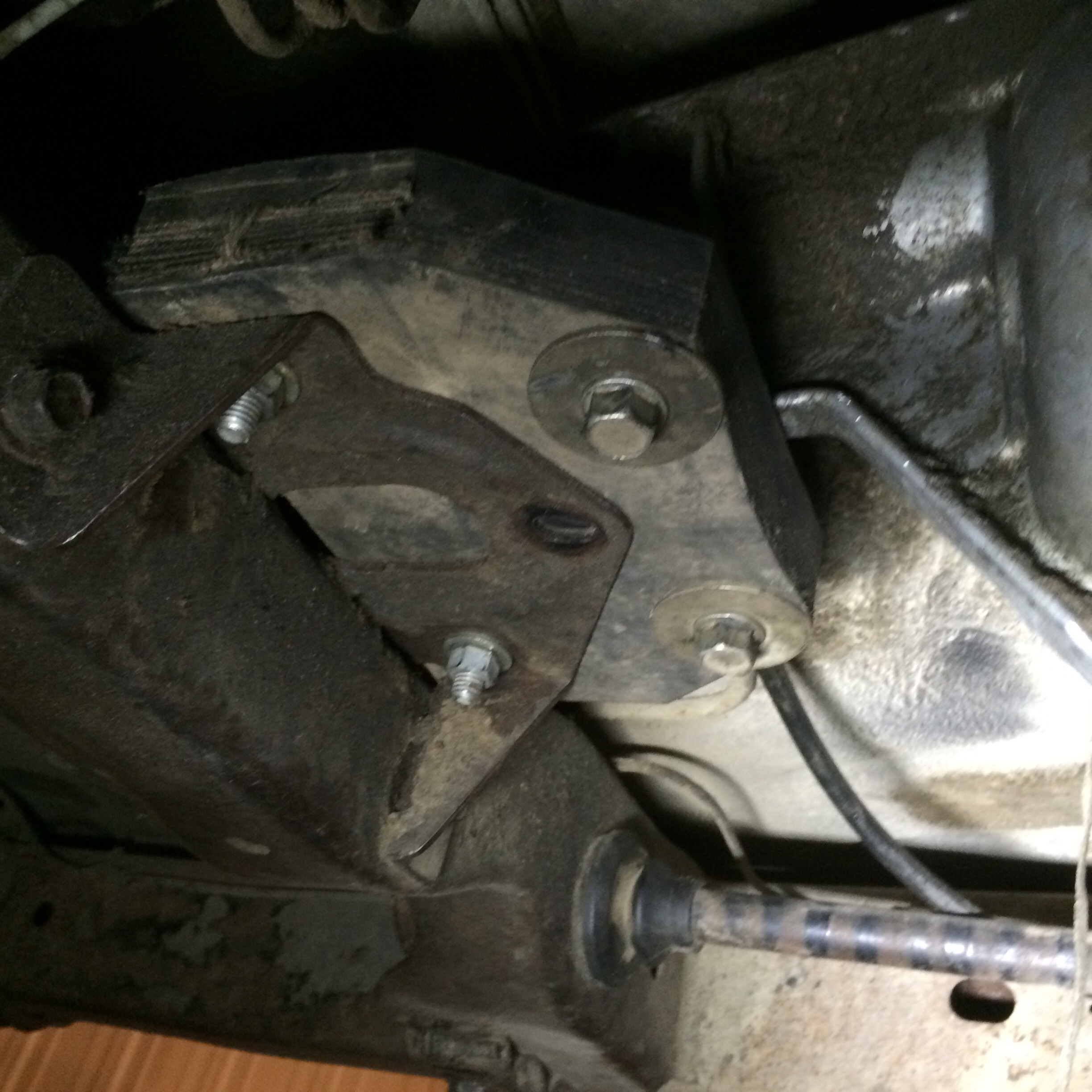

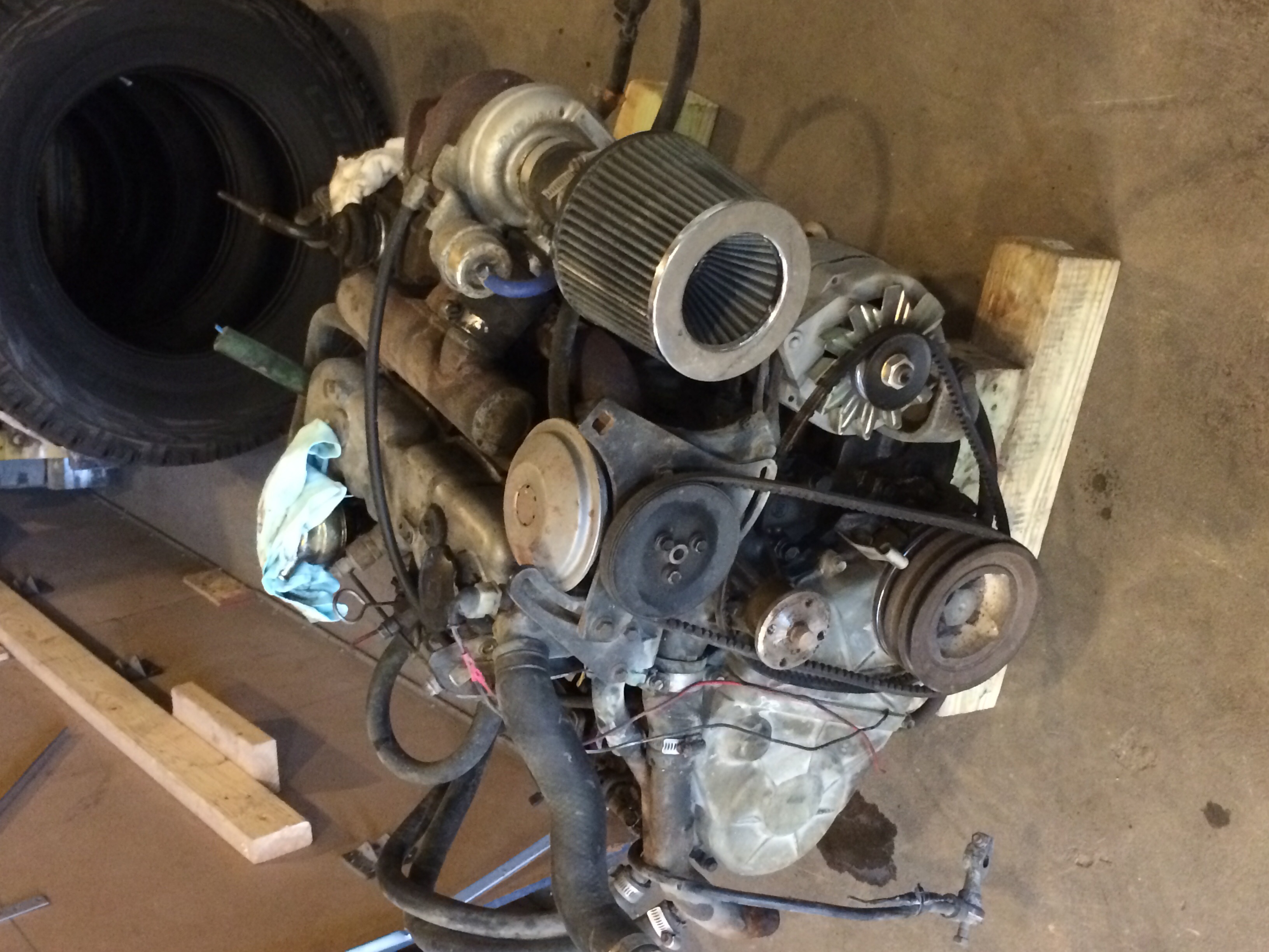

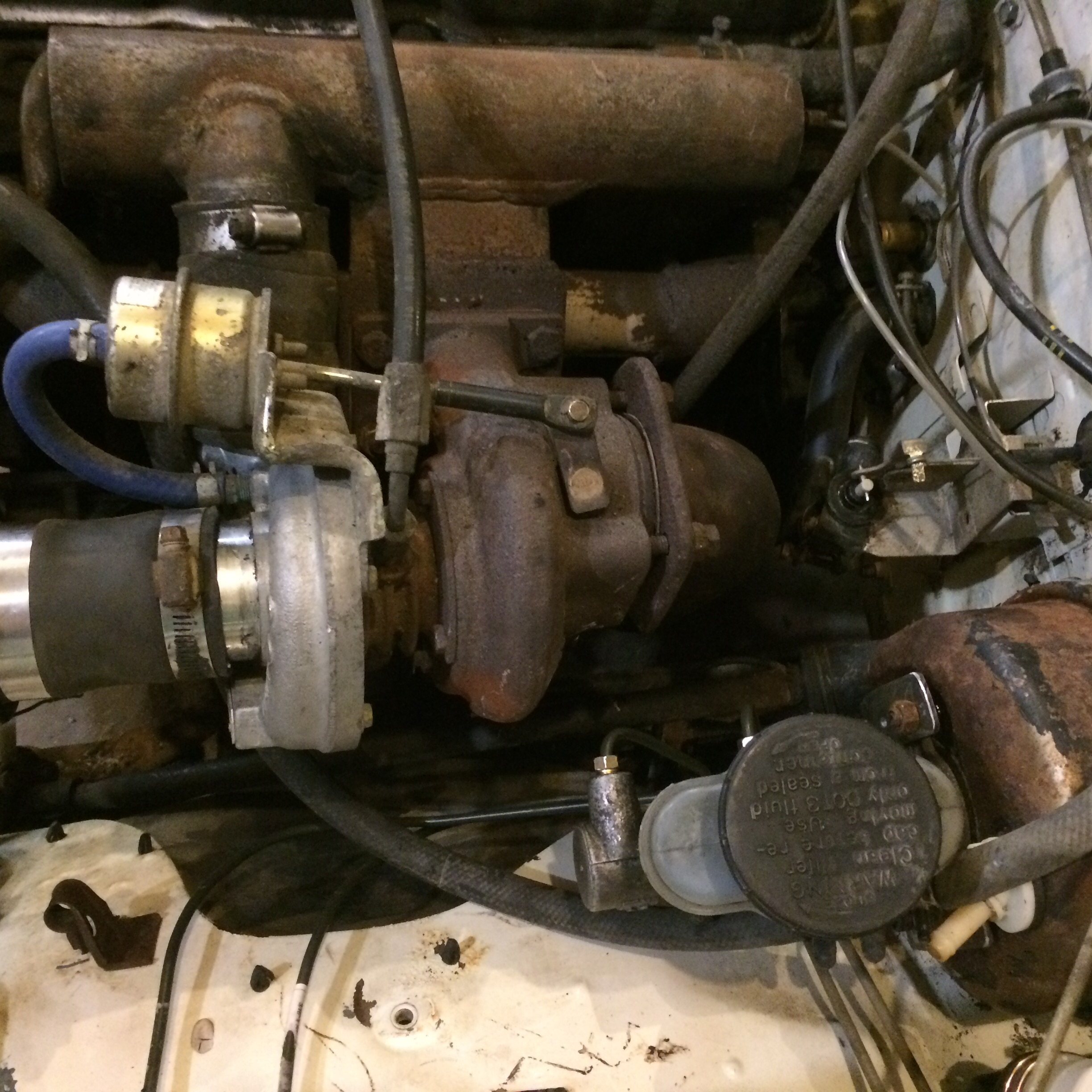

Ok I'll try to get some more pictures and hopefully i can get them right side up. The engine is in the drivers side mount fit perfectly but the pass side only caught the bottom half of the mount. The shifter is lined up dead center. The only problem I had is the turbo hit the brake master cylinder I swapped the brake cylinder out of the donor truck.
Would someone have a pic of how the hydraulic clutch is conected to the clutch pedal.
File comment: Custom tranny mount

I don't have a picture but I think it's just a pin. In the info section of this site is a parts book, the drawings will be there. All of your pictures are right for me.

Interesting manifolds. Did you make them?
What size turbo are you using?
Eric Q.

Eric, your question about the vacuum pump (from the other topic) is easily answered here. It's visible in the photo above. It's the belt-driven diaphragm pump between the head and the cone filter.

The previous owners brother made the manifolds. The turbo is a Garrett GT2052s. It makes about 6 psi @60 mph on flat ground and on a hill at the same speed it will do around 10psi.

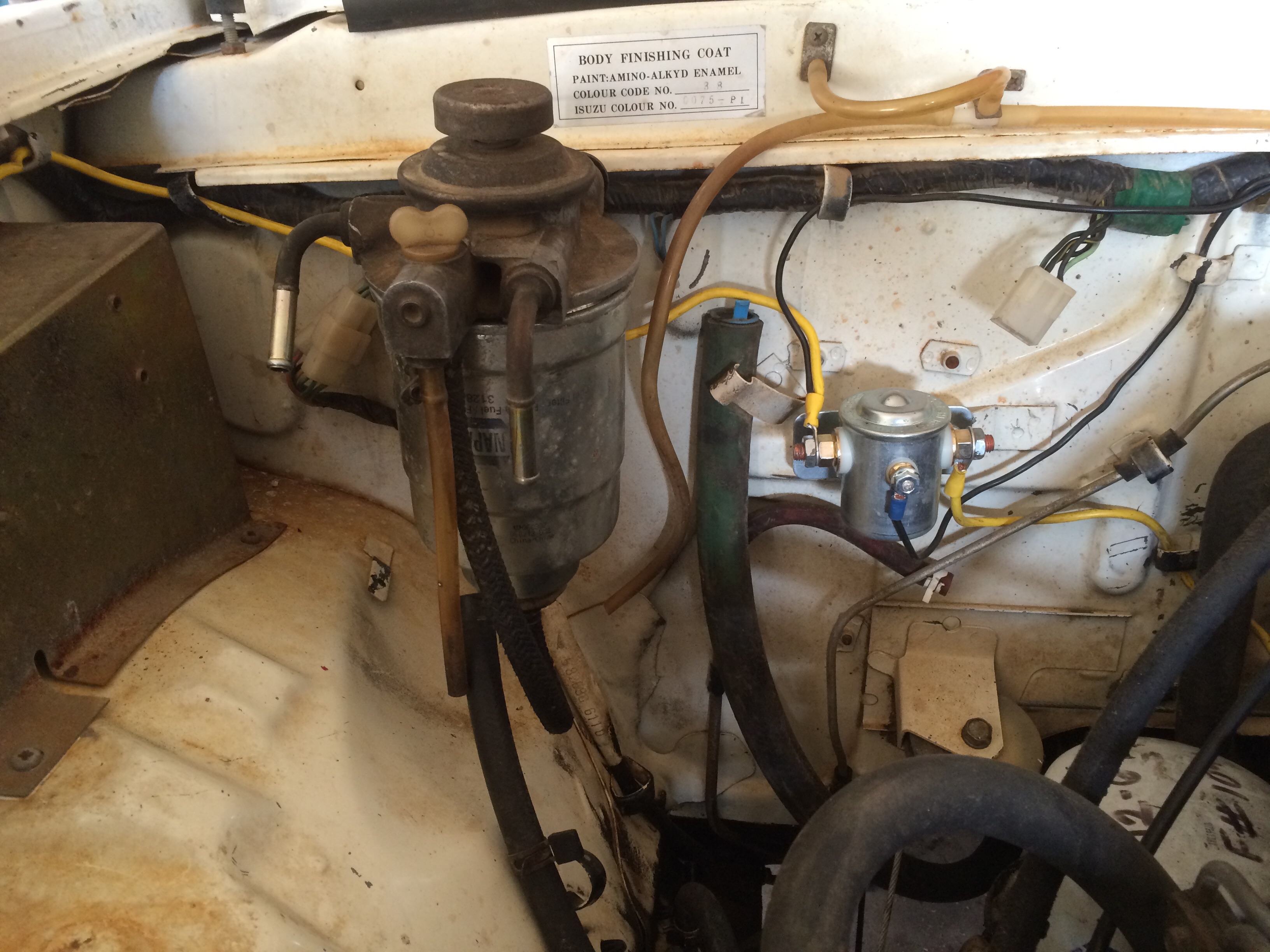

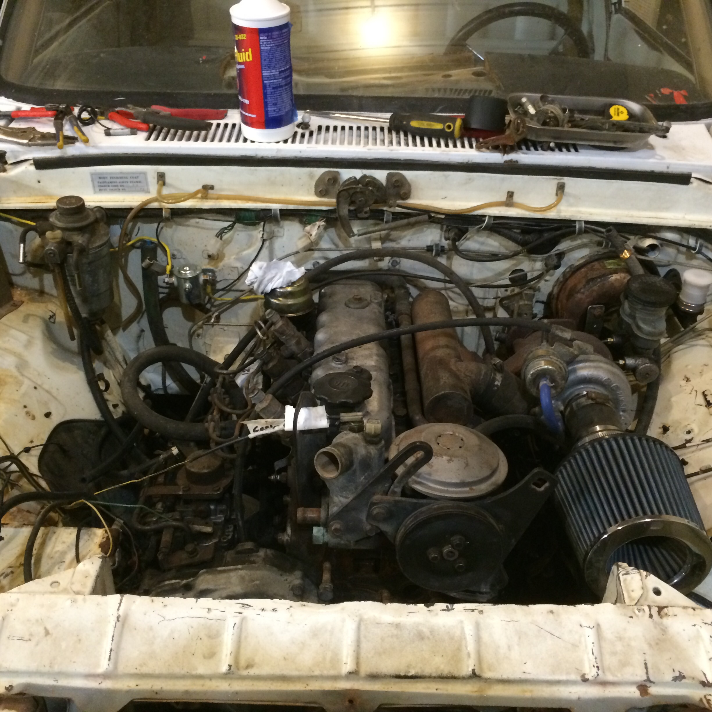

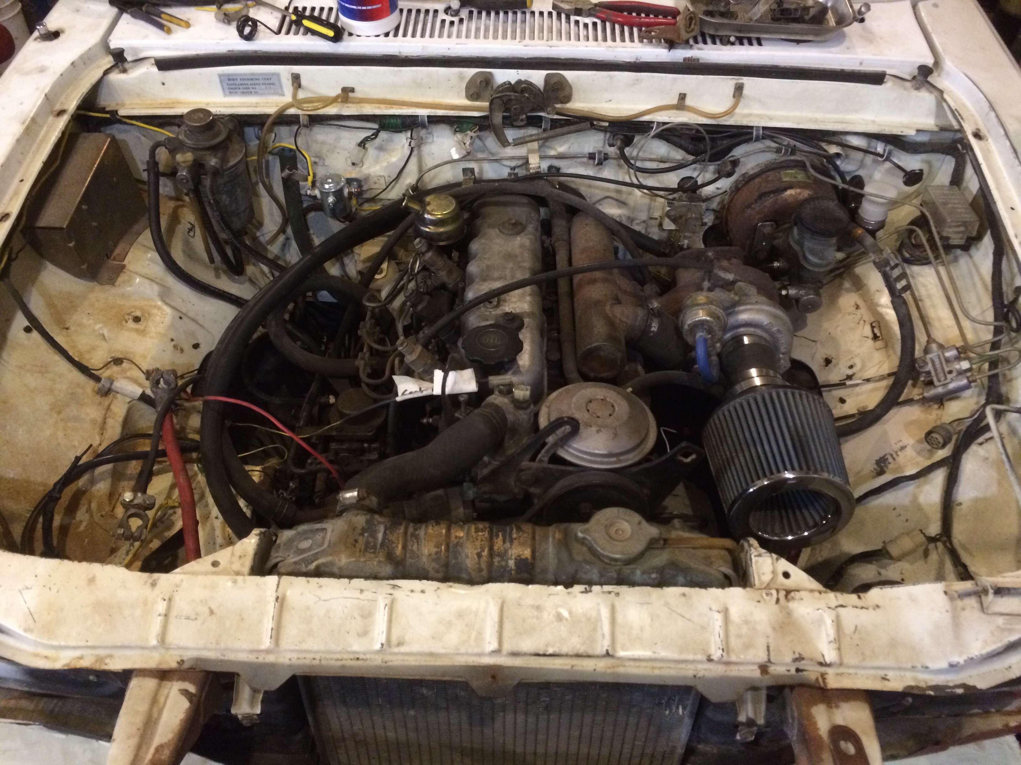

Ok I've made some progress. I got the glow plugs set up,got my water pump rebuilt and on. Things are coming together!! A few more hours of work and I can see if it'll start!!
File comment: Shot of the engine
File comment: Glow plug wiring and fuel filter

I'd be interested to know why the intake manifold was replaced.
Tom
PostPosted: Wed Nov 19, 2014 12:46 pm
Joined: Sat Aug 10, 2013 12:24 pm
Posts: 65
Location: New Hampton Ia
It was originally n/a so a new intake had to be made for the turbo.

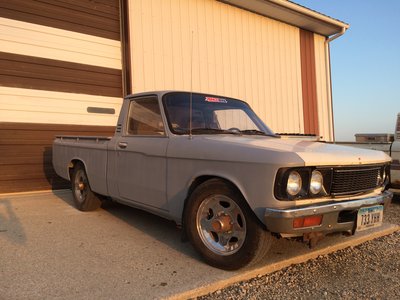

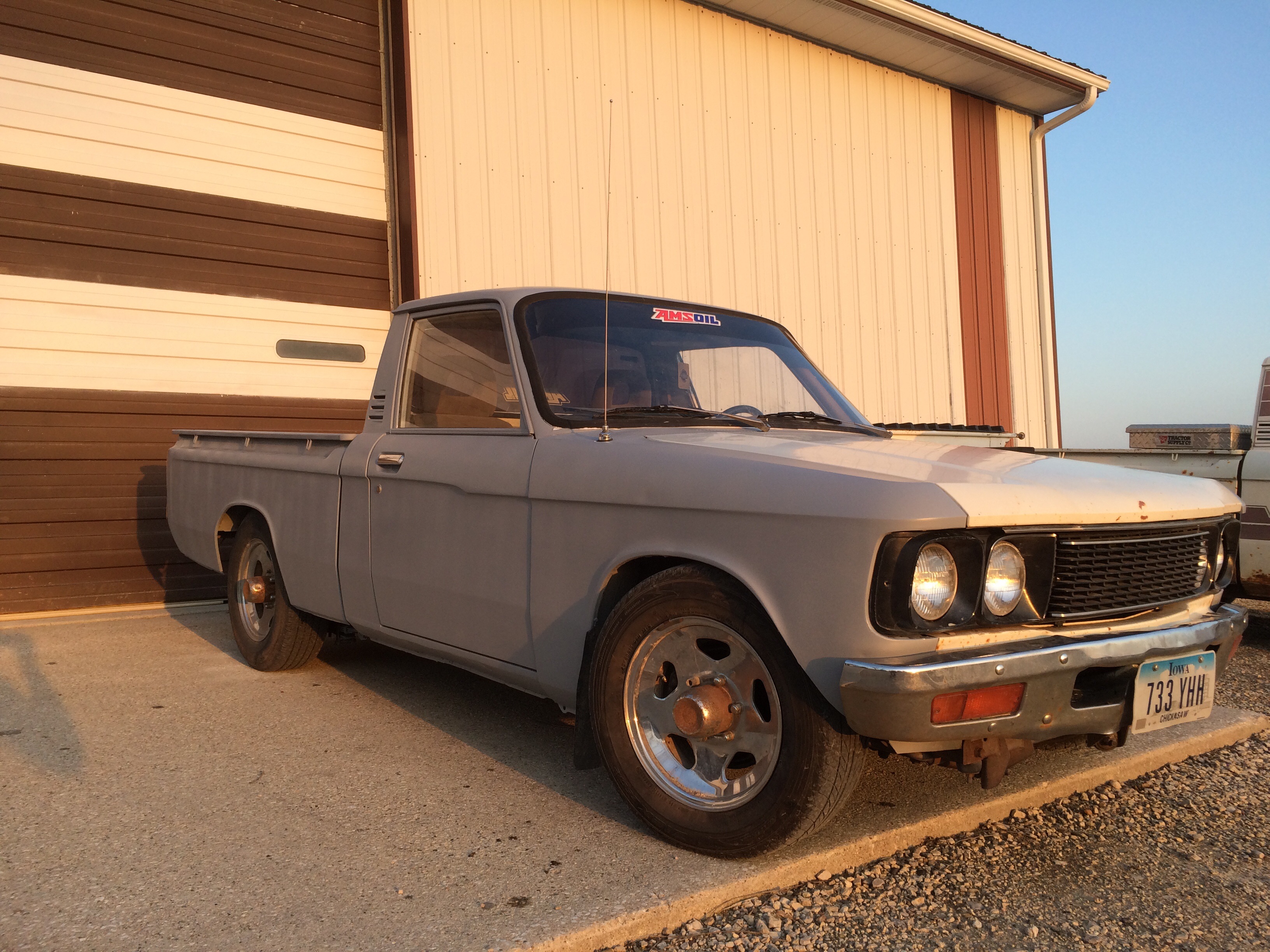

Got the truck on the road today. Paint will have to wait till next winter.

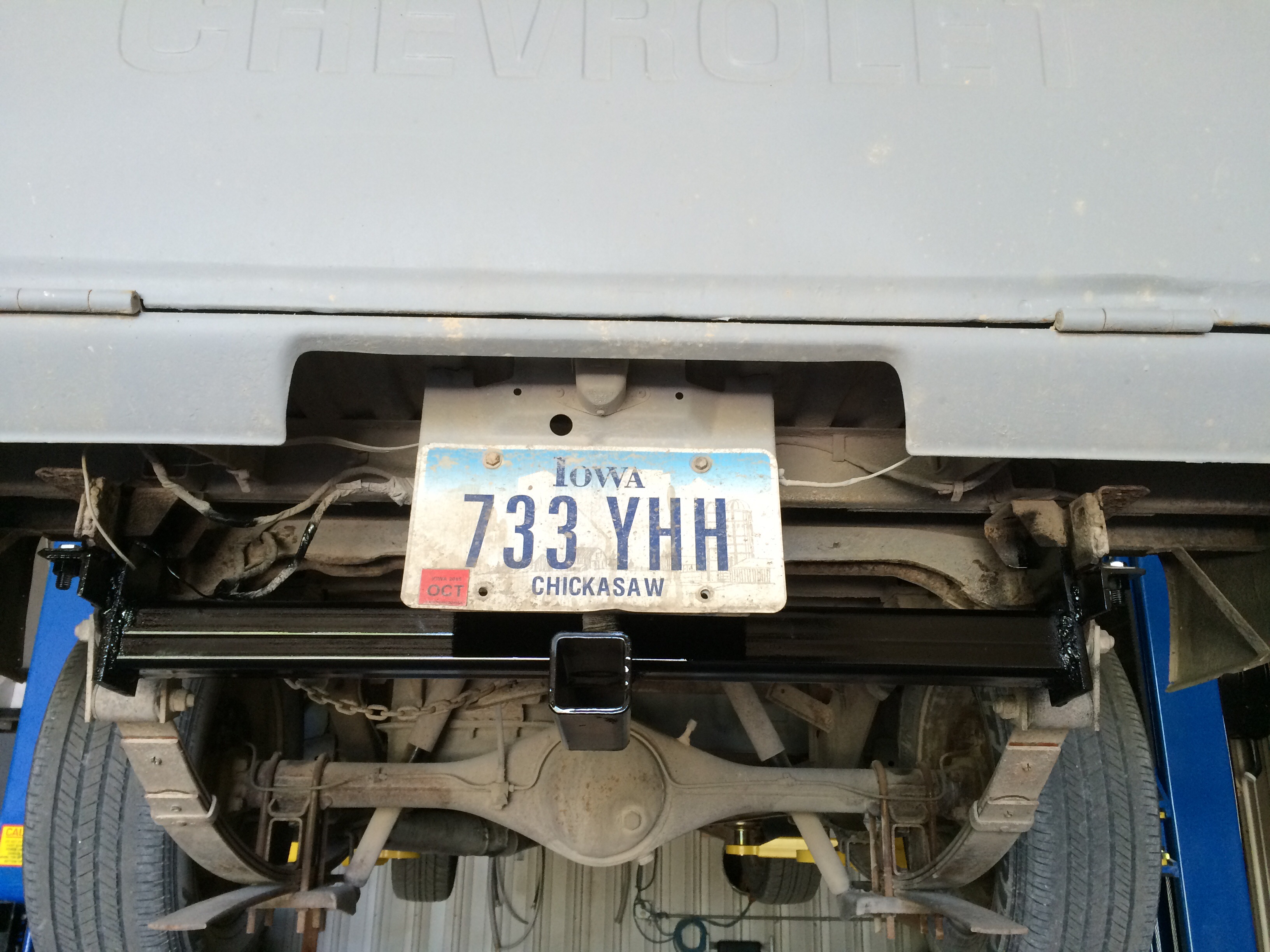

Got about 600 miles on it and it's running great but I have a fuel leak from the injection pump that I need to fix after I figure out where it's coming from.
Also made a hitch for it.
