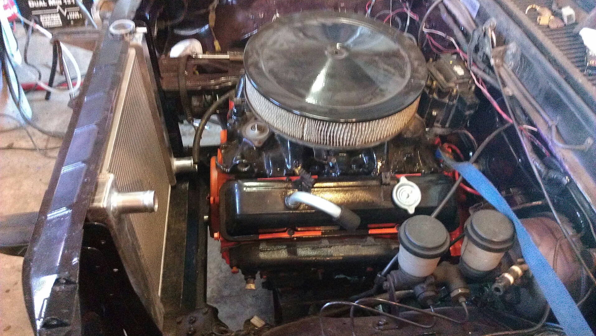

 Post subject: Re: my 78 luv build
PostPosted: Thu Mar 13, 2014 10:44 am
Posts: 370
quick shot of the engine bay. yes I know my valve covers are backwards :D

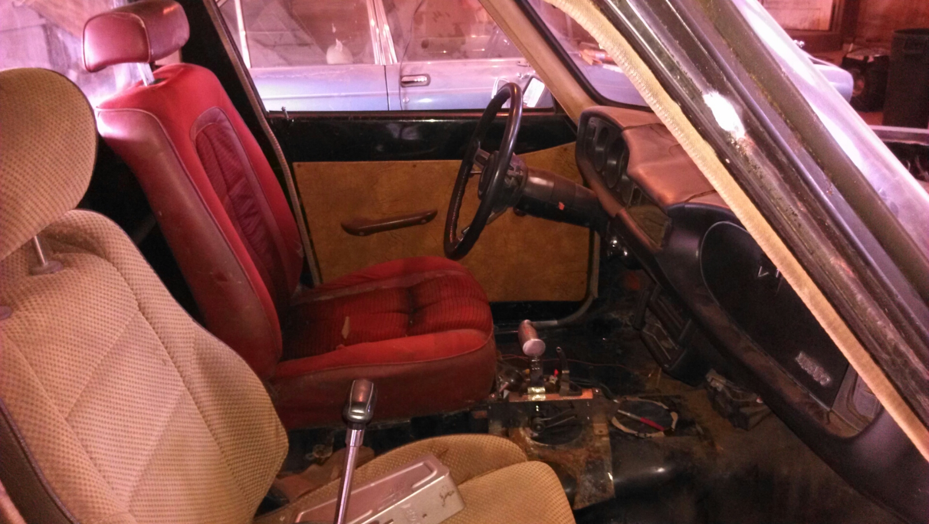

PostPosted: Thu Mar 13, 2014 10:49 am
Posts: 370
interior shot. keep going back and forth on those rx7 seats or my factory Mikado seats.
PostPosted: Thu Mar 13, 2014 7:34 pm
Lookin good man! Those seats fit in there a lot nicer than mine do!

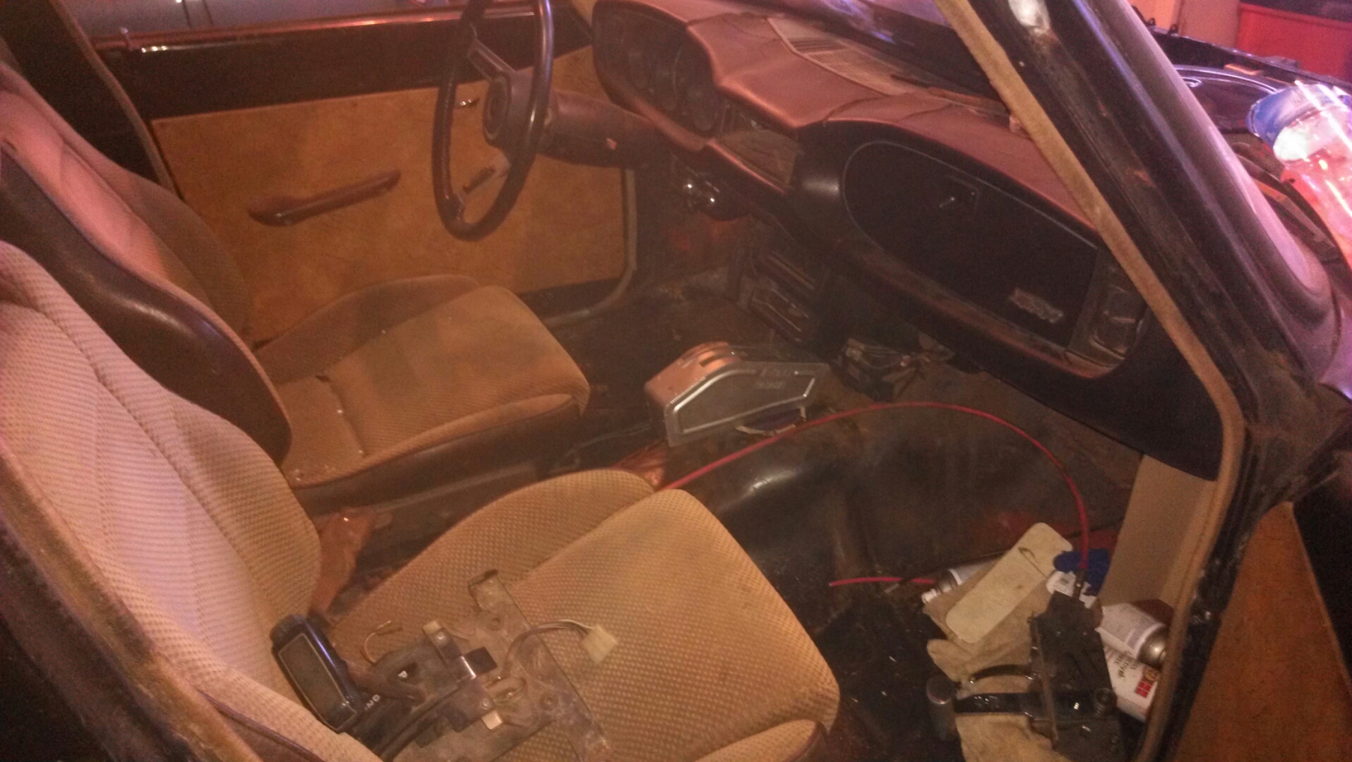

PostPosted: Mon Mar 17, 2014 12:52 pm
Posts: 370
rx7 or Mikado seats? the Mikado seats will bolt right up and are very comfortable, but have some rips and tears... rx7 seats match the door panels, keep you in the seat but are no where near close to bolting up and sit really low, but I can make brackets. what do you guys think?
PostPosted: Mon Mar 17, 2014 1:15 pm
I peraonally like the tan ones but making rails is a pita. The head rests on your mikado seats are different than mine were i think. Mine was all one piece the headrest didnt move.
PostPosted: Mon Mar 17, 2014 2:51 pm
Posts: 370
I'm leaning towards the tan seats also... It's getting there slowly but surely. Lately I've Been trying to find a torque converter that'll work. Then its just the little things for the motor to run, exhaust, and figure out a throttle cable/linkage setup. I also still need to get a swp pulley and I'm sure I'm forgetting stuff lol
