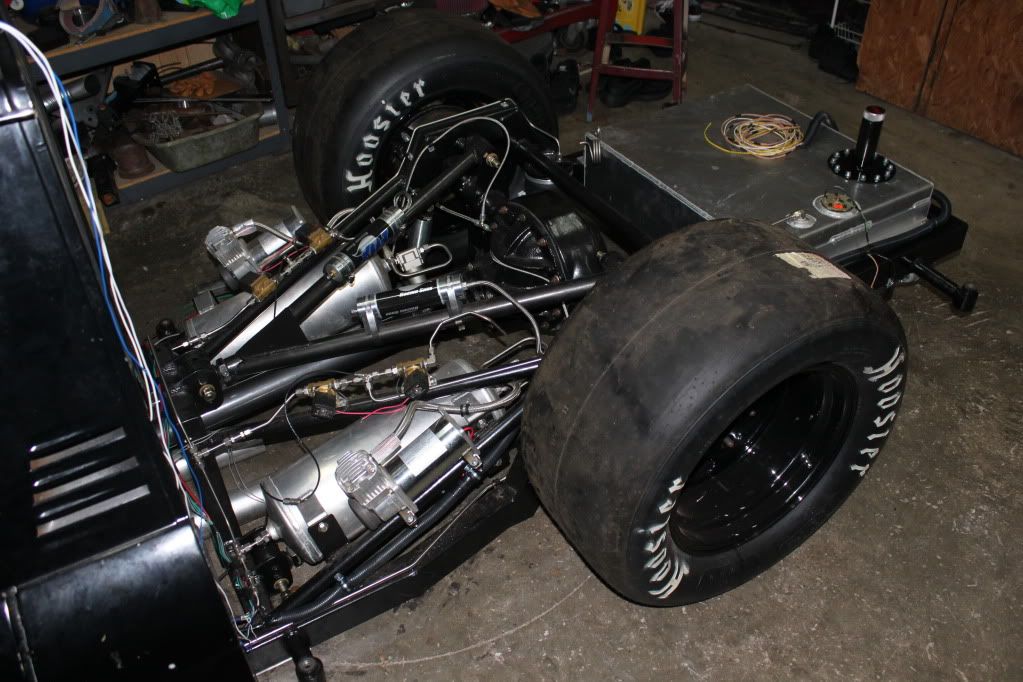

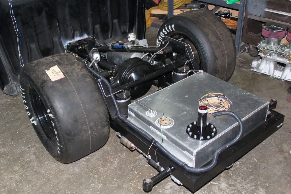

got 98% of the wiring from the cab back buttoned up. wiring ran to valves and senders under the cab. need to finish that tomorrow and everything behind the cab. really need gauges and engine harness to finish the wiring.
